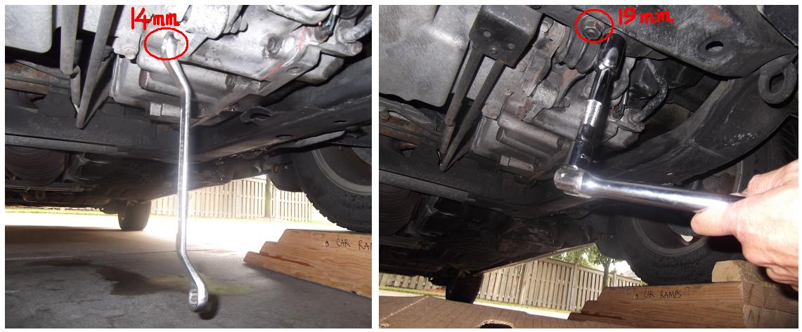

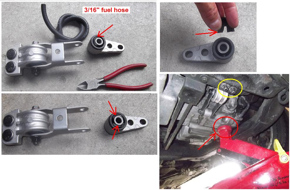

I just replaced my Trans Torque Mount, here are my observations:
1. The Hutchinson brand is definitely Volvo because it is scratched out where the Volvo logo normally is.
The Hutchinson smaller bushing is softer now, maybe a redesign from the solid bushing.
Or maybe Hutchinson makes it this way so it breaks down sooner, so they can sell more of this stuff LOL.
2. Spray the nuts/bolts 1 day ahead using WD-40 and all that jazz.
- Smaller bolts: definitely use a box wrench (14-mm) because of tight space. The box wrench will prevent stripping the bolt too.
- The larger nut: 19-mm: a breaker bar makes it a breeze.
3. Since the Hutchinson bushing is a bit thinner than factory, I used some 3/16" fuel hose and cut a few pieces as shown and place it so make it more solid (but still a bit softer than factory).
- I loosely attach the nut/bolt, final tightening with floor jack (see below).
- What I do is kind of what I do, may not be scientific.
4. During install, loosely attach the 14-mm bolts.
- Then use a floor jack, lift the trans a bit (1-2") the other side of the Trans Mount (19-mm studs) will now slide in the holes easily.
- I tighten these nuts/bolts with the floor jack in place because this is the engine position when you put it in "D". Read somewhere that people torque these bolts when someone is in the car in "D" (foot on brake). But this is too dangerous. A floor jack below trans is much safer! Don't forget to tighten the nut/bolt on the bushing itself (if you decide to add fuel hose as I did).
