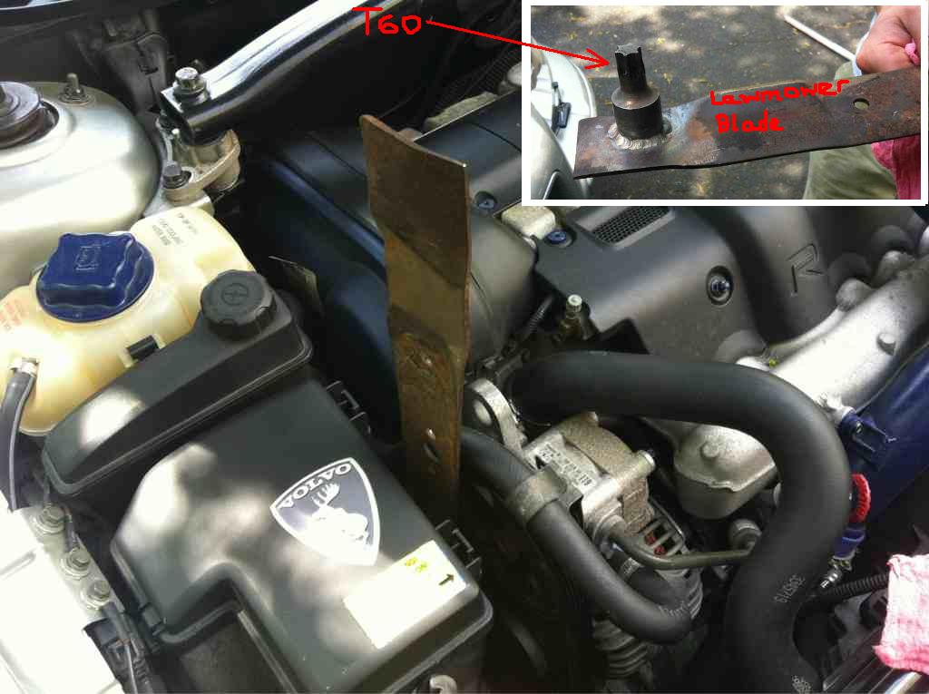

For future reference, you can make the serp belt tool for cheap.
Find a used lawn mower blade (make sure you dull the sharp part of the blade) or a straight piece of metal (Home Depot has it).
Then go to local muffler shop and ask them to weld the T60 bit for you. Most muffler shops do this for about $5-$10.
I took this photo from another website to show you the home-made tool.
PS: I misspelled the word "Lawnmower Blade" in the pic but the picture is worth 1000 words!
louty
Posts: 154
Joined: 21 February 2010
Year and Model: s70 1998
Location: oregon
Post by louty »
nice cheap idea
precopster
Posts: 7543
Joined: 21 August 2010
Year and Model: Lots
Location: Melbourne Australia
Has thanked: 8 times
Been thanked: 128 times
Post by precopster »
louty wrote:nice cheap idea
It's simply beautiful when technology meets homegrown inventiveness.
