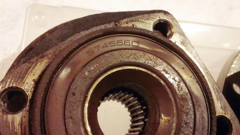

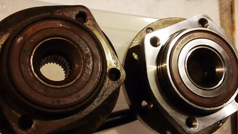

I am replacing both front hub assembly. I am not sure how many miles more it would have lasted, there was noise at accelerating and decelerating at 30MPH. It has close to 124k. I used 5LB hammer to knock it out after removing the four bolts.
Using rotary tools, it took an hour to remove the layers of rust from the knuckle to make a clean matting surface for the new hub. Below is a photo of OE and the replacement side-by-side.
