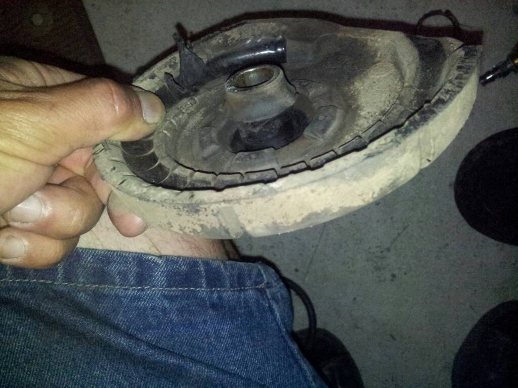

Driver's side spring seat or what's left of it. With spring compressors, an air wrench and a grinder got the suspension unit out and put in a new spring seat. The grinder was used to cut the last 1/2 inch off the top of the spring seat so I could have access to the star nut. It was an original spring seat with an 00 build year so not bad for 12 years.
