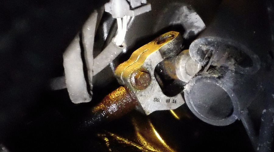

Now sizing up the difficulty of replacing it. First look of u-joint.
Looking down from the engine

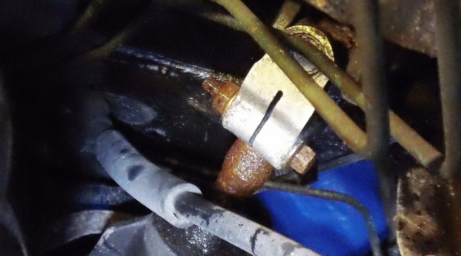

Post by xHeart »
I have checked SRS at the dash before locking the wheel to a straight and from facing, it is working.
Looking from the wheel well
