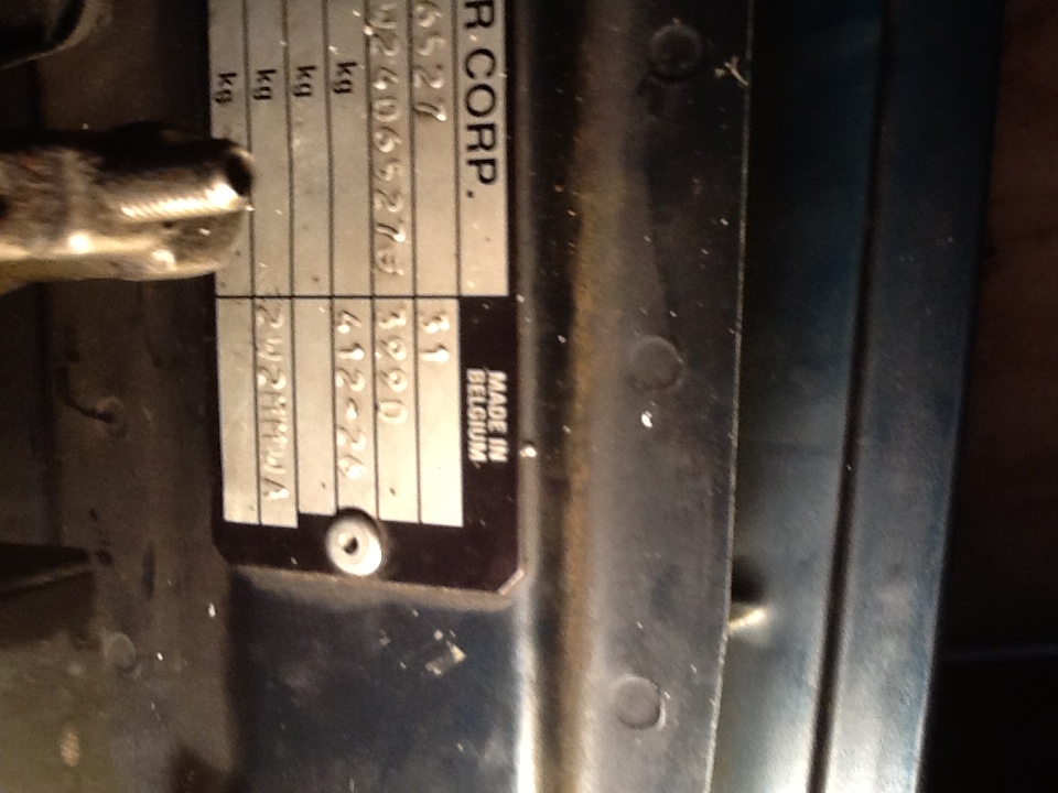

98v70dad
Posts: 1226
Joined: 11 Mar 2011, 17:02
Year and Model: 98 V70
Location: Southeast US
Has thanked: 1 time
Post by 98v70dad »
kahl wrote:Sorry, notes show right side of data plate.duh
Thanks KAHL. Its probably helpful to me but I don't understand how that deciphers anything. Maybe it will be obvious when I look at the data plate.
erikv11
Posts: 11911
Joined: 25 Jul 2009, 14:03
Location: Iowa
Has thanked: 311 times
Been thanked: 817 times
Post by erikv11 »
Totally worth it to just take a look at the boots, the TRW racks say "TRW" on the rubber boot, if you see that then you have solved it for your car. The TRW racks are much more common, too.
The TRW inner and outer tie rods have been foolproof for me as replacements (have only had TRW racks so far).
kahl
Posts: 943
Joined: 27 Oct 2012, 19:01
Year and Model: 2000V70XC
Location: columbus ohio
Been thanked: 10 times
Post by kahl »
The last number on the right side of the data plate at the bottom will be a 4 or a 5. That will tell you what rack you have.
98v70dad
Posts: 1226
Has thanked: 1 time
Post by 98v70dad »
So is precopster correct that its a 5 for SMI rack and 4 for TRW rack? He didn't sound too sure of it in his response.
kahl
Posts: 943
Post by kahl »
SMI Is 5 and TRW is 4.
98v70dad
Posts: 1226
Has thanked: 1 time
Post by 98v70dad »
kahl wrote:SMI Is 5 and TRW is 4.
I'm still a little confused. The plate in the photo you posted shows the letter "A" in the position you say should show a 4 or 5 (bottom entry, right side of plate, rightmost digit). My car has a 5 in that position (I think ... hard to read) which is SMI according to the info you've posted. The dealer told me SMI also, but he didn't check the plate or the VIN.
