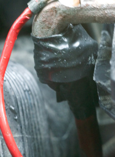

My positive cable let go entirely two days ago. I didn't know how far gone it was, and when I was working on fixing the battery to the tray (non-stock size battery, that's a whole 'nother story), the cable gave out.
So to get the car running as a temporary fix, I took off a bit of the end of the cable's sheath and screw clamped it to the terminal clamp.
It's ugly but it works. It's temporary until I can get the parts for this DIY.

Ingenious! I'm curious to see more pictures of your method!
