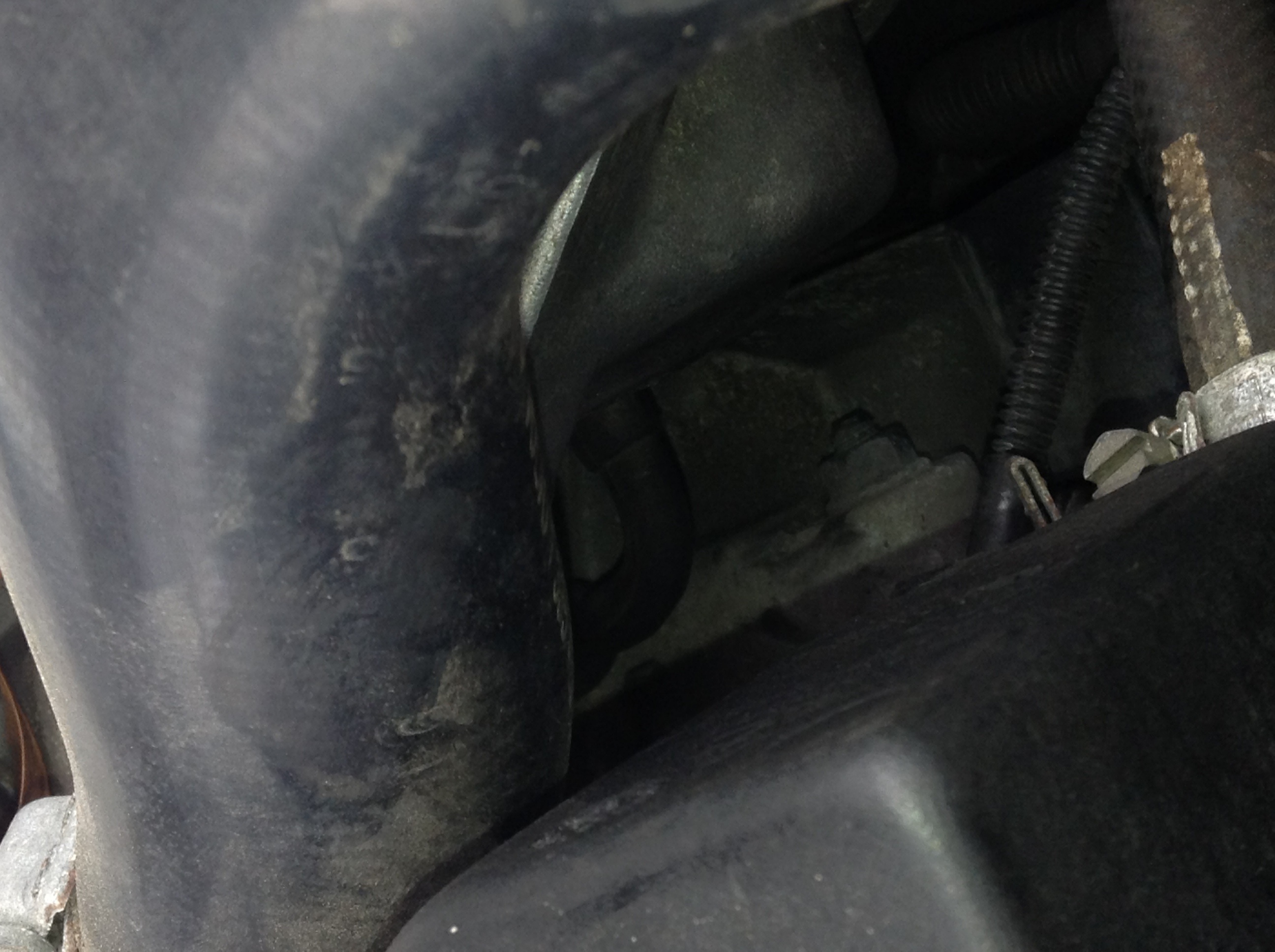

Start searching for a vacuum/air leak. Start with the elbow that connects to the intake manifold behind the power steering pump.
Ignore the jury-rig (couldn't reach the flipping hose), but this is the location. That elbow has probably fallen off/deteriorated. If so, re-connect it and evaluate the health of the PCV system.

Not that I can find - sorry. Look in the little cranny behind the alternator - behind the thermostat/upper coolant hose. There's about a 3" space in there, and a vacuum hose should connect to a little port on the intake.marklar wrote:I'm new, do you have a pic of that zoomed out a bit?

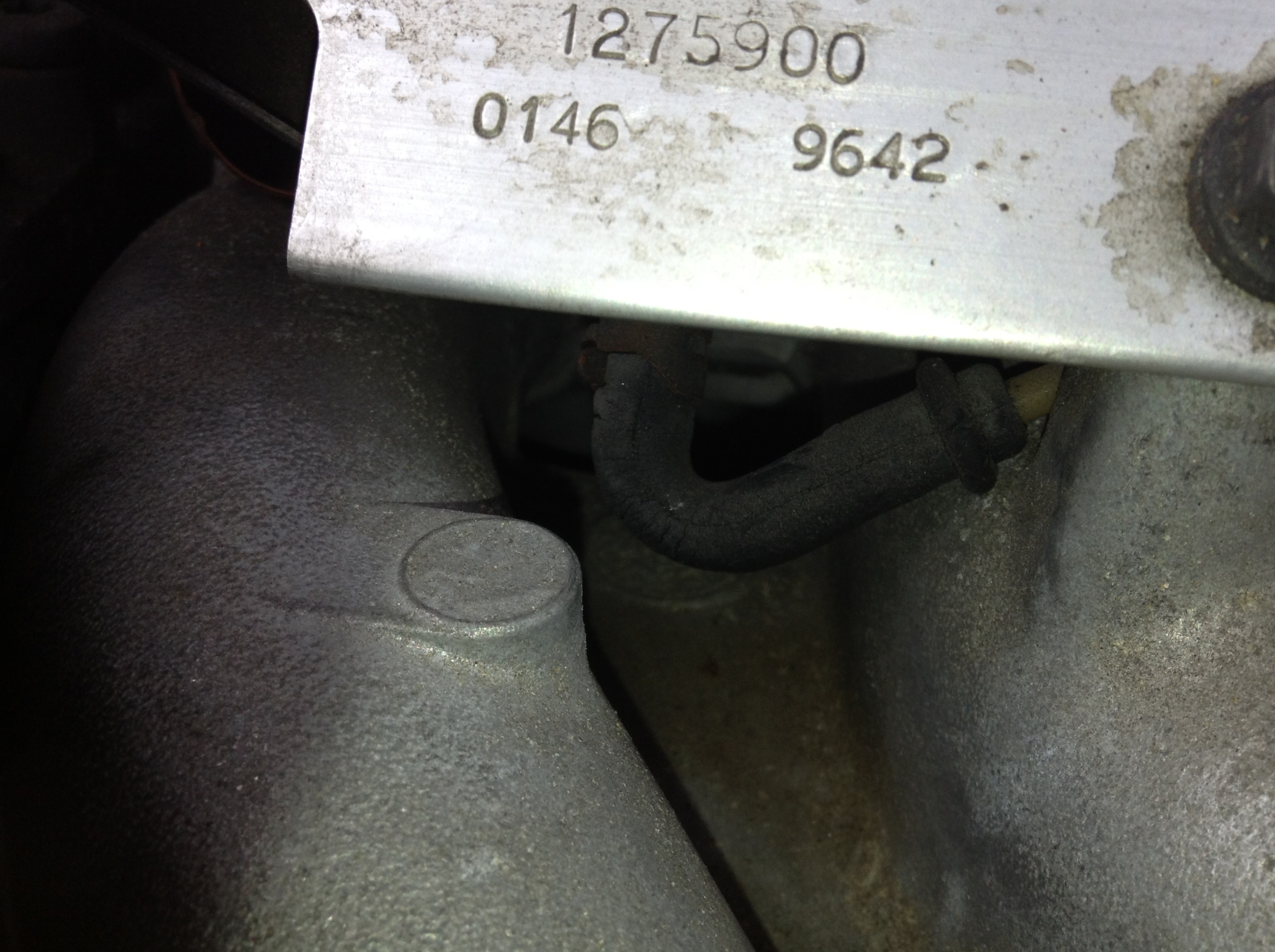

I think I found the line you were telling me about, mine doesn't have a clamp and its going the opposite direction. I also found a corroded hose that goes to the fuel injectors so that might be it

That looks like it - looks ok from here.
Yes, the fuel pressure damper hose does look like it's falling apart. Search around the engine bay - namely the vacuum tree and turbocharger area - for any falling-apart elbows like that and replace whatever is necessary. You can just use straight vacuum hose if you can't find elbows.
