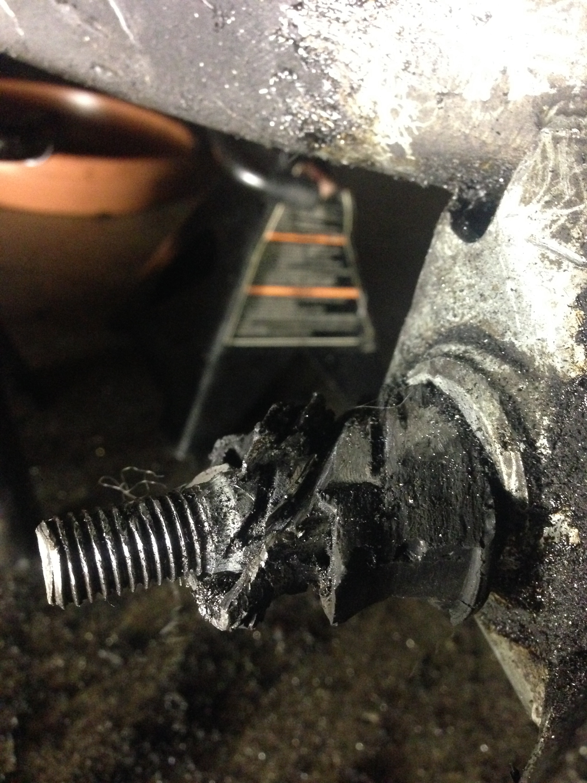

Is the bolt that the struct goes on replaceable, I cut too deep and cut the actual bolt?
Would anybody know were I could find a replacement?

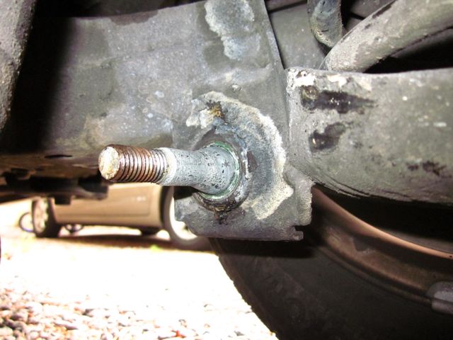

This is the stud/bolt I am talking about. I cut deep into mine.

I can't see the cut. If its less than a third of the diameter of the stud, don't worry about it. You can straighten the thread on the cut bolt with a die or carefully threading a bolt onto it, with some oil, Stop if there is any resistance with the bolt.

That's a picture I got of google, not mine. Mine is in very bad shape unfortunately, its just not usable. The cut is almost half way through the bolt.
But I am a bit sacred that this bolt is not removable. I don't see how I can remove it. If it is removable I was thinking maybe just go to the junk yard and grab one from there.

Agreed.... that's a picture of the stud on my '97 855. I got lucky on that job... the old shock absorber just popped off after I removed the bolt.
I wrote up a little DIY guide and posted it here a while back:
https://www.matthewsvolvosite.com/forums ... =1&t=40415
There is an image in there of my using a long screwdriver to pry the old shock off.

That isn't pretty but I think you might be able to recover. Get the rest of the bushing off and post back a picture. The threads look a bit grim but I think you could chase them with a die and it would be serviceable.
The part that I can't tell about is just how chopped up the stud is behind the threads. If the damage is limited to the area just behind the threads it isn't that huge of a deal in an engineering sense. The part that must be solid is the area at the junction between the stud and the trailing arm since that is were the lateral load is focused. As Steve pointed out, the axial load isn't much, just enough to keep the shock absorber firmly fixed onto the tapered stud. If there are cuts in the stud behind the threaded area you might not want to fully torque the nut down for fear of snapping the stud at the score marks.
They used aircraft style nuts on a couple of my cars that I have replaced the rear shocks on which should keep the nut from walking off. I think this is also a place where I might add some Loctite Red if it wasn't fully torqued to spec.

That isn't quite as simple as it sounds. The trailing arm is aluminum and the stud is steel. They can be welded but you can't just use a stick welder and getting the replacement stud aligned in place is a challenge. If a junk yard trip is involved just get the whole trailing arm.tryingbe wrote:To our current problem, I would go to junkyard, cut a stud out flush off, cut your stud flush off, take your car to a welding shop, weld the stud onto the area.
Replacing the trailing arm, unfortunately, means a trip to the alignment shop to get the rear toe set correctly and it likely also means replacing the end link and the delta link bushing(s). Personally, I would do everything possible to salvage what is there.
