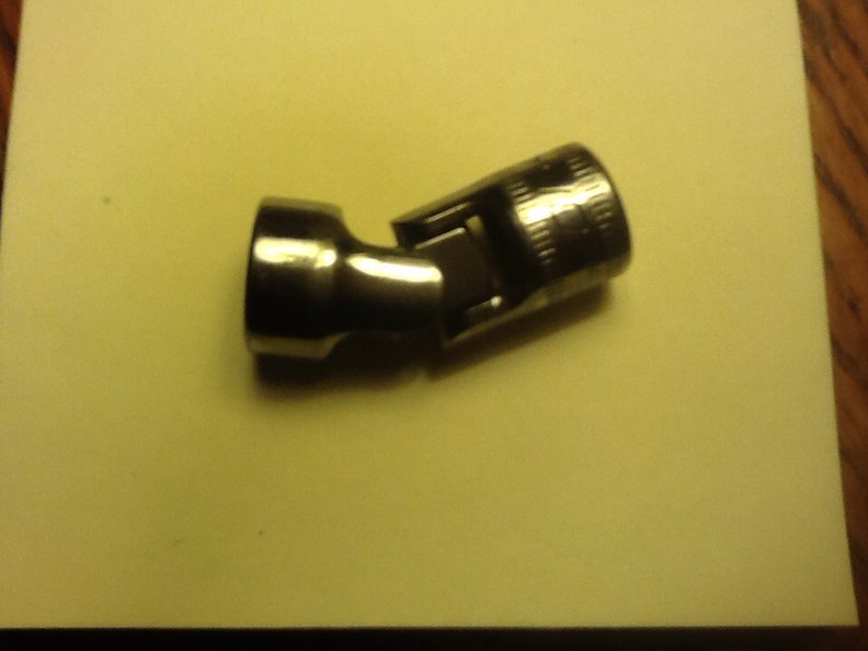

The manifold bolts I have removed are all 10mm. I specifically got a 10mm Snap On flex socket 1/4 drive for the manifold bolts. Works perfectly on the top and bottom bolts. If you remove the throttle body all manifold bolts are exposed. When the manifold is removed you will see that the wiring loom has broken apart. I use 1/4 and 3/8 loom to wrap up the wires.
- Snap On 10mm flex socket

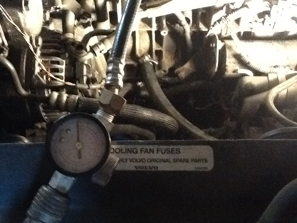

- Notice wires with missing, cracked loom
- image.jpg (239.67 KiB) Viewed 945 times

Thanks folks. I've already bought a intake manifold gasket. I thought it was a good idea since it didn't cost much and if (when?) i damage the original one I'll have it. The snap on flex socket looks like the right tool for the job. Since I work on cars as a hobby I usually don't buy tools that are that high quality. I'll see if I can find something like that in a non-professional type tool.. The 12 inch beam torque wrench is an excellent idea and i didn't think of that. I don't have one and now is my excuse to go buy one. I have a big clicking type and I never trust it for small fasteners.
