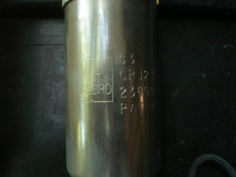

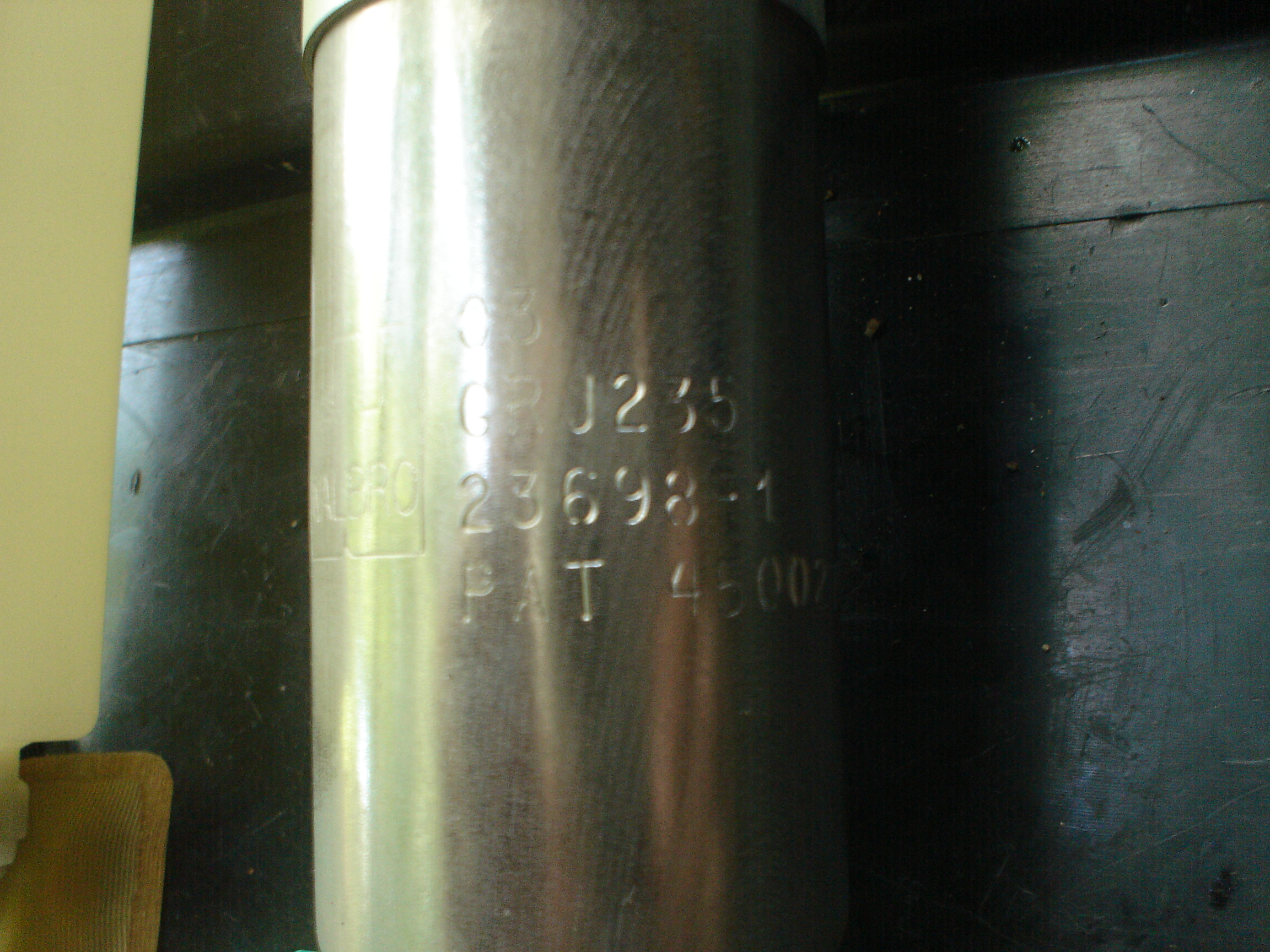

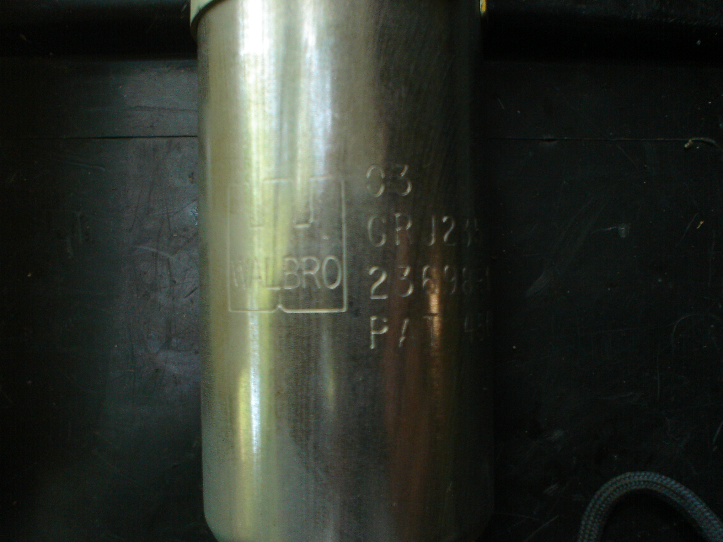

The OEM pump on a XC and presumably the R is actually a Walbro and I couldn't source a direct replacement for it even with the Walbro part number on the cartridge. The way the package is put together you need to have the exact same dimensions on the replacement cartridge and it is a different size than the Walbro replacements that many of us use on the FWD cars.
At the end of the day it really isn't that tough to chop the hole in the floor to get to it. When I changed the pump on the latest XC It took me all of an hour start to finish but I had just changed that pump on my old XC about 3 weeks earlier and everything was still fresh in my mind. Even the first one only took me 3 or 4 hours being real careful.

The OEM pump on an AWD is NOT a Walbro. Hence why you can't get replacements from them. Branding is irrelevant.
Neil: You have two pumps, congratulations. One pumps fuel to the engine, the other fuel from one side of the tank to the other. You will need a year specific AWD pump or the wiring will not match.

I guess my vision sucks worse than I thought.Blockpartie wrote:The OEM pump on an AWD is NOT a Walbro. Hence why you can't get replacements from them. Branding is irrelevant.
That was the original from my first '99 XC and the second, also original, was identical.
