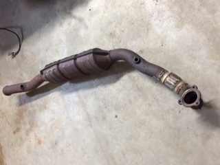

Hi All,
Just a quick update on my new Volvo. I went to replace the the muffler today and the catalytic converter seemed to move side to side too easily. I removed the heat shields on the back of the head and found the flex pipe broken in the catalytic converter. I removed it and took it to the local Midas shop and they were able to weld in a new flex section for $175. It was a little more money than I thought it would be, but they did a great job, I needed it today, and it's a heck of a lot less than a replacement converter. I was able to get the exhaust completed today, woowho!!!
