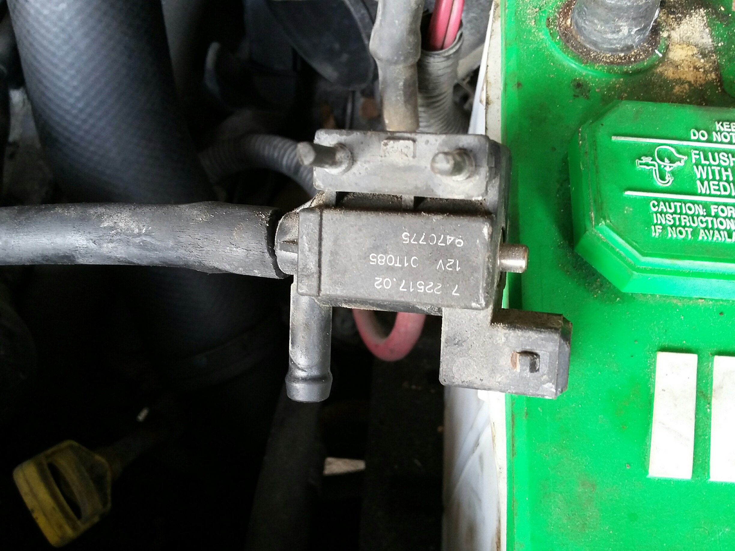

2 questions:
So I'm taking things apart to get to the ETM and I find this part with the hose missing. Where is the hose that connects to this part in the second photo? Would this cause rough and fluctuating rpms at idle like I am experiencing?

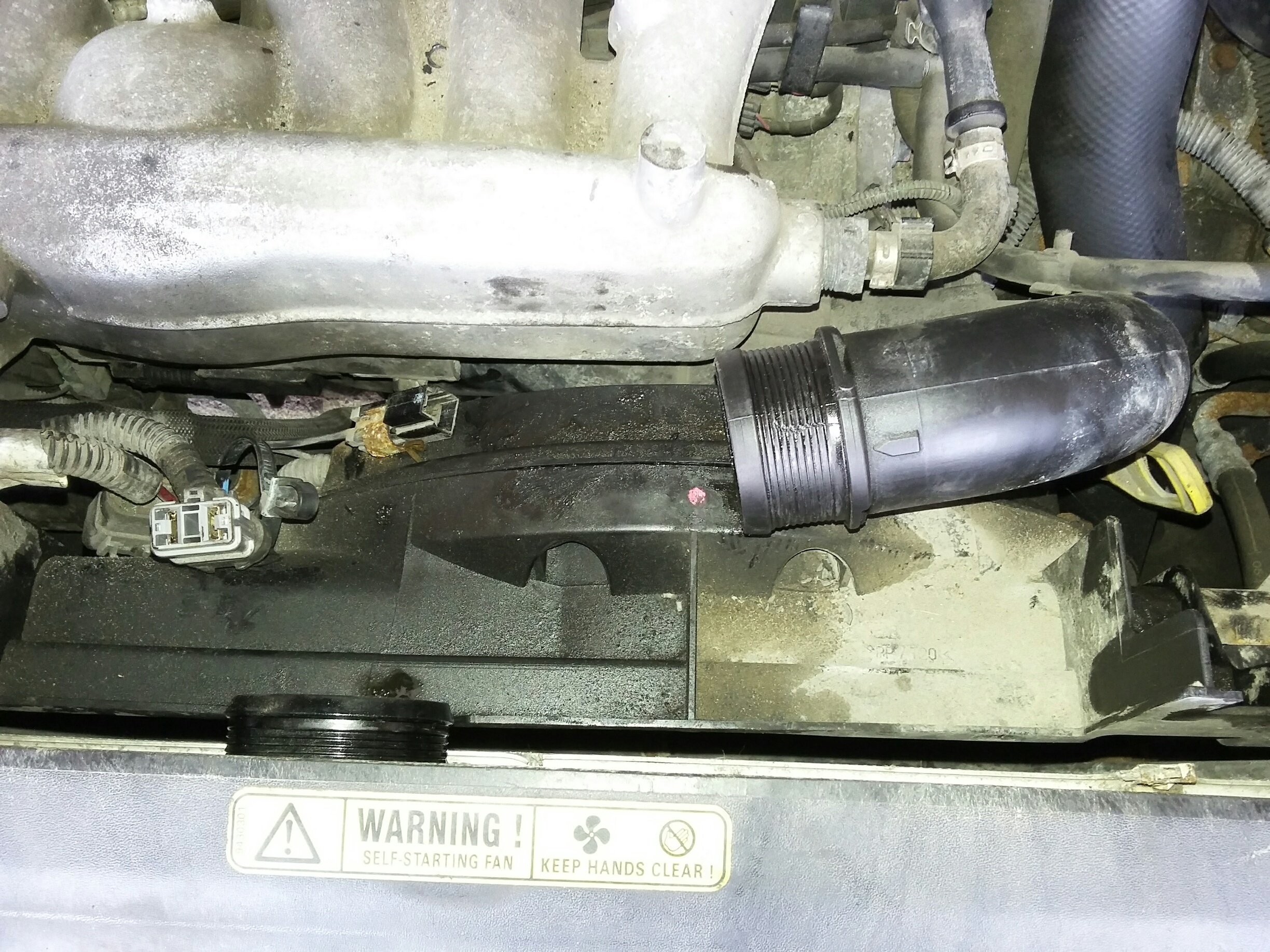

Second question is in regards to the charge air pipe being in the way of removing the cooling fan. Do I need to take charge air pipe off to be able to remove the cooling fan? Seems like a nightmare to attempt loosening the charge air pipe clamp from Etm with the coolant fan in the way since.

Purge valve for evap emissions. Missing hose there will cause rough running.
Use under hood vacuum diagram to put that Right
