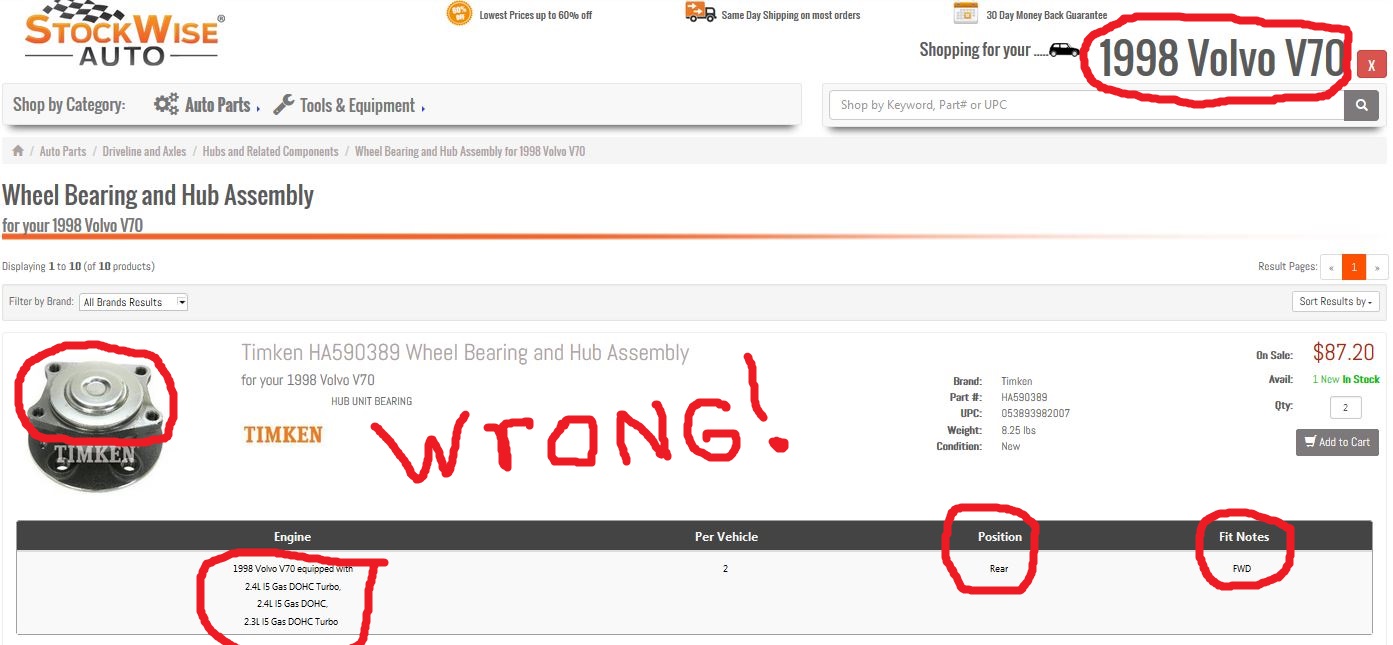

One more thing...the ad below is wrong for a '98 rear hub. The photo gives it away and the number doesn't agree with Timken's bearing catalog
[attachment=0]Volvo_Rear Hub Mistake Ad.JPG[/attachment]
Too bad as the price sure is right!
