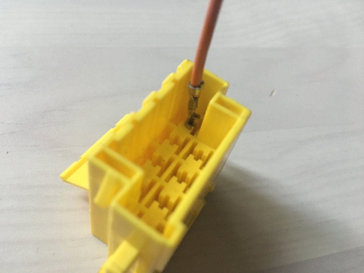

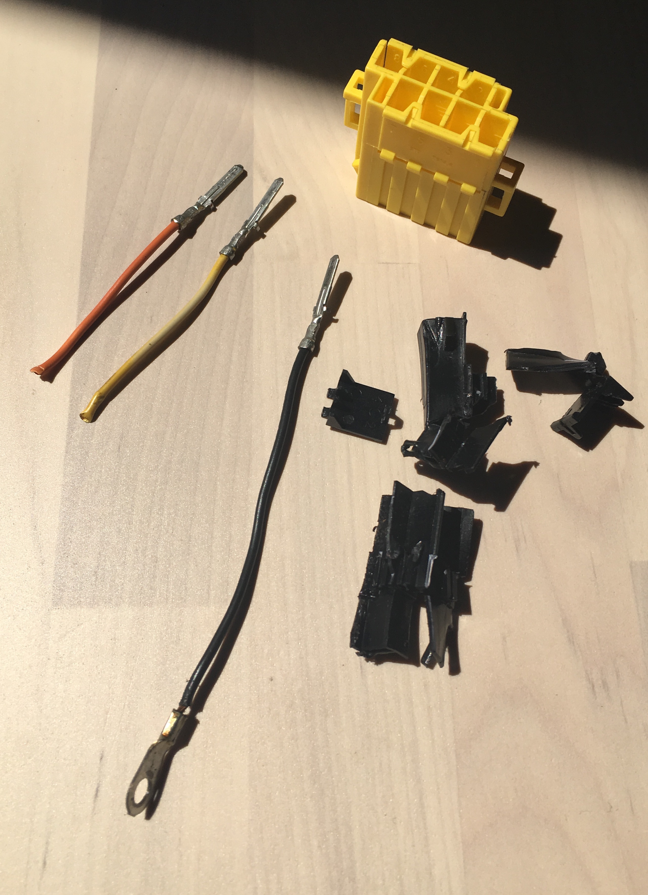

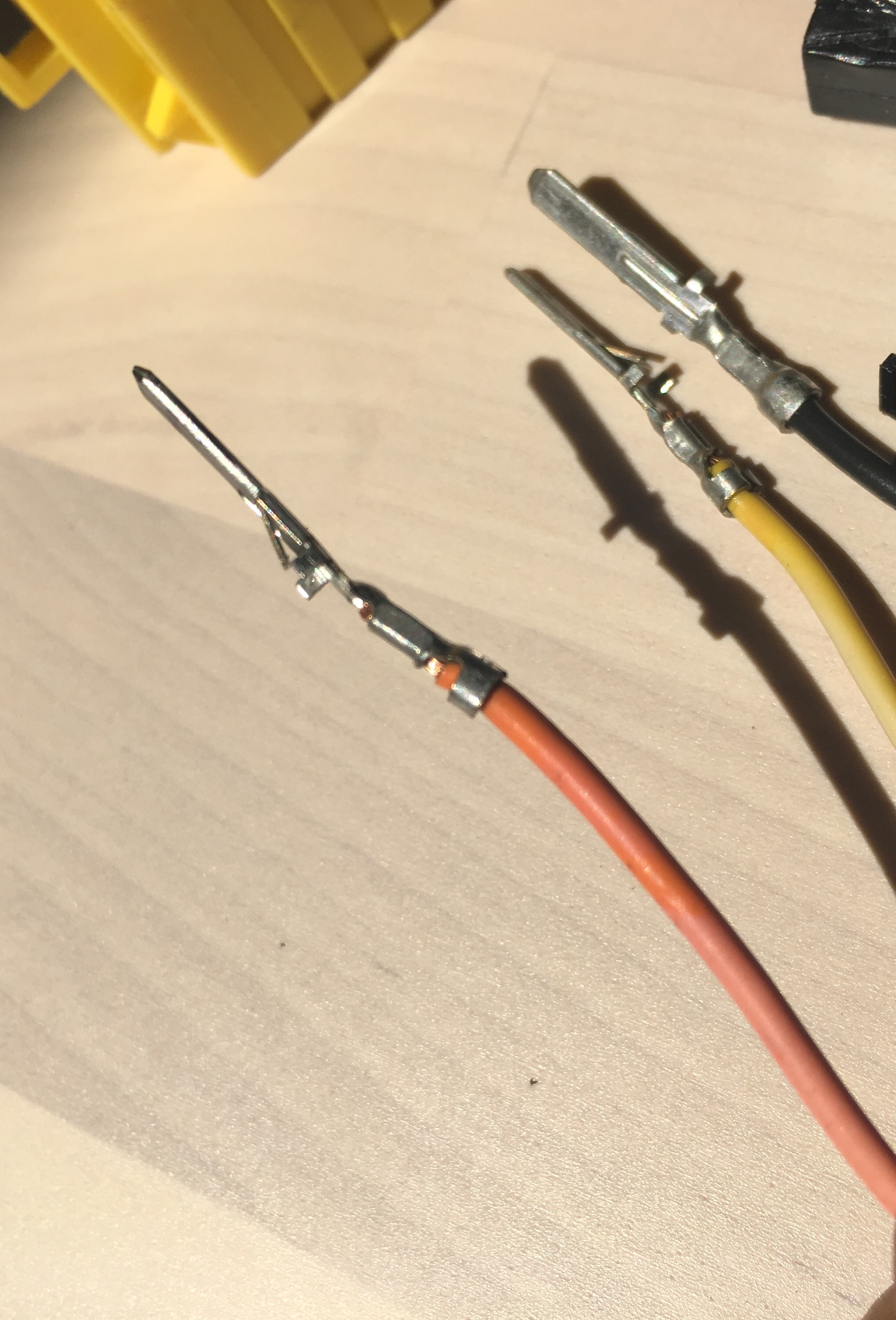

For those interested in the power connection: I took some of the male end AMP connectors out of the male end of my old rear windshield wiper motor. I stripped and soldered my CB power wire to the wire lead with the metal tip and inserted the male tip into the empty accessory connector housing, essentially making this a "plug and play" set up.
