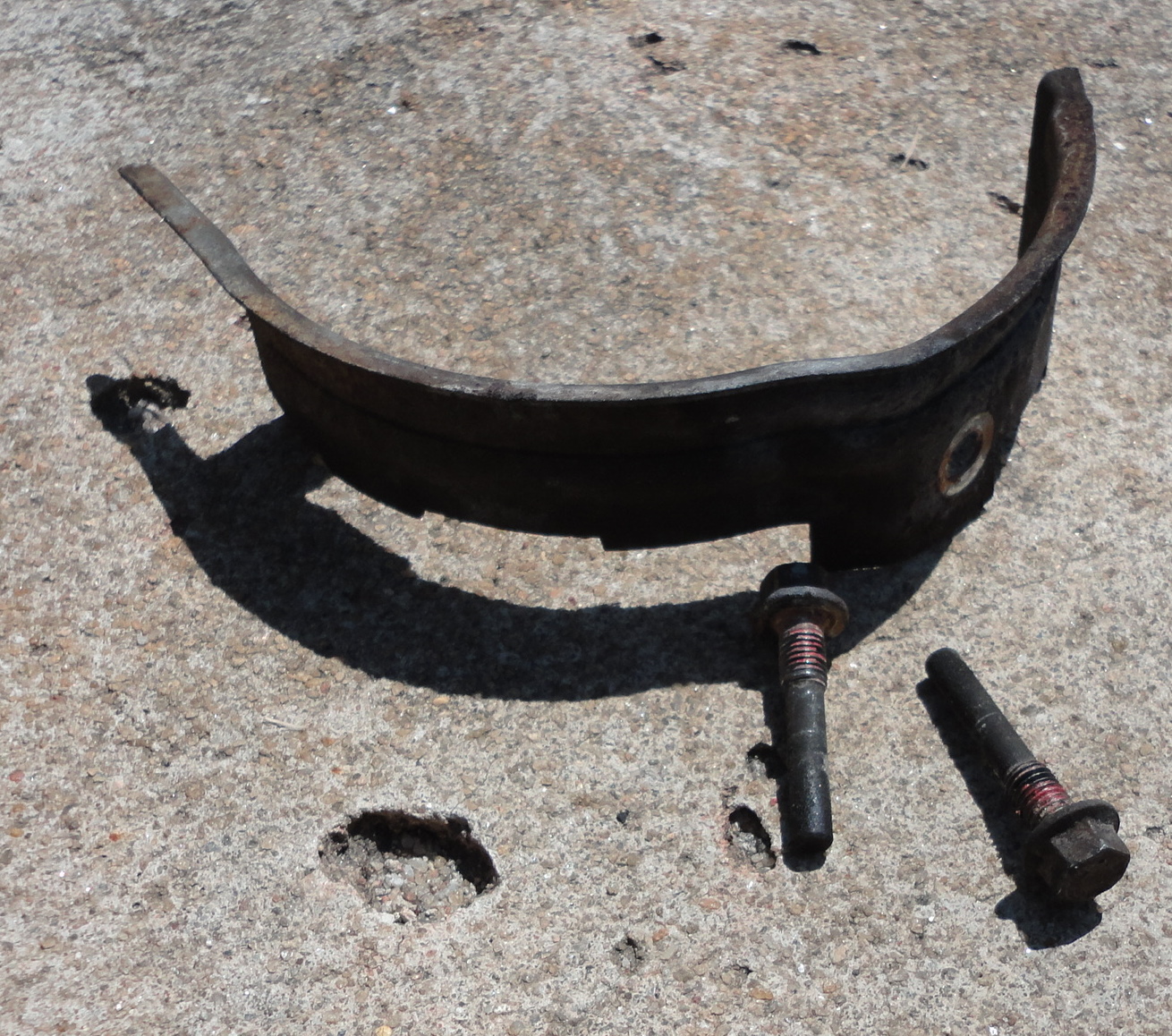

This.skloon wrote:They look like the lower timing belt shield bolts
P80 lower timing belt cover bolts 974674
- rspi

Ok, if these special bolts hold the timing belt guard around the bottom of the crankcase pulley then I have two standard M7 bolts left over. That may be a better option. Thanks for inputs.beigg wrote:Bingo!MrPc wrote:Those bolts look vaguely familiar..... By any chance, do you still need to install the belt guard that goes around the bottom of the crankshaft pulley? It seems to me that those bolts are similar. IIRC the long nose helps get things lined up and the threads started. (Although I still found it a kinda hard...)

The now-extra M7 bolts may be for the upper, outer plastic timing belt cover, where it screws into the cam cover.

Can someone with VIDA post the part numbe r for these please?

VIDA says: 974674.abscate wrote:Can someone with VIDA post the part numbe r for these please?
