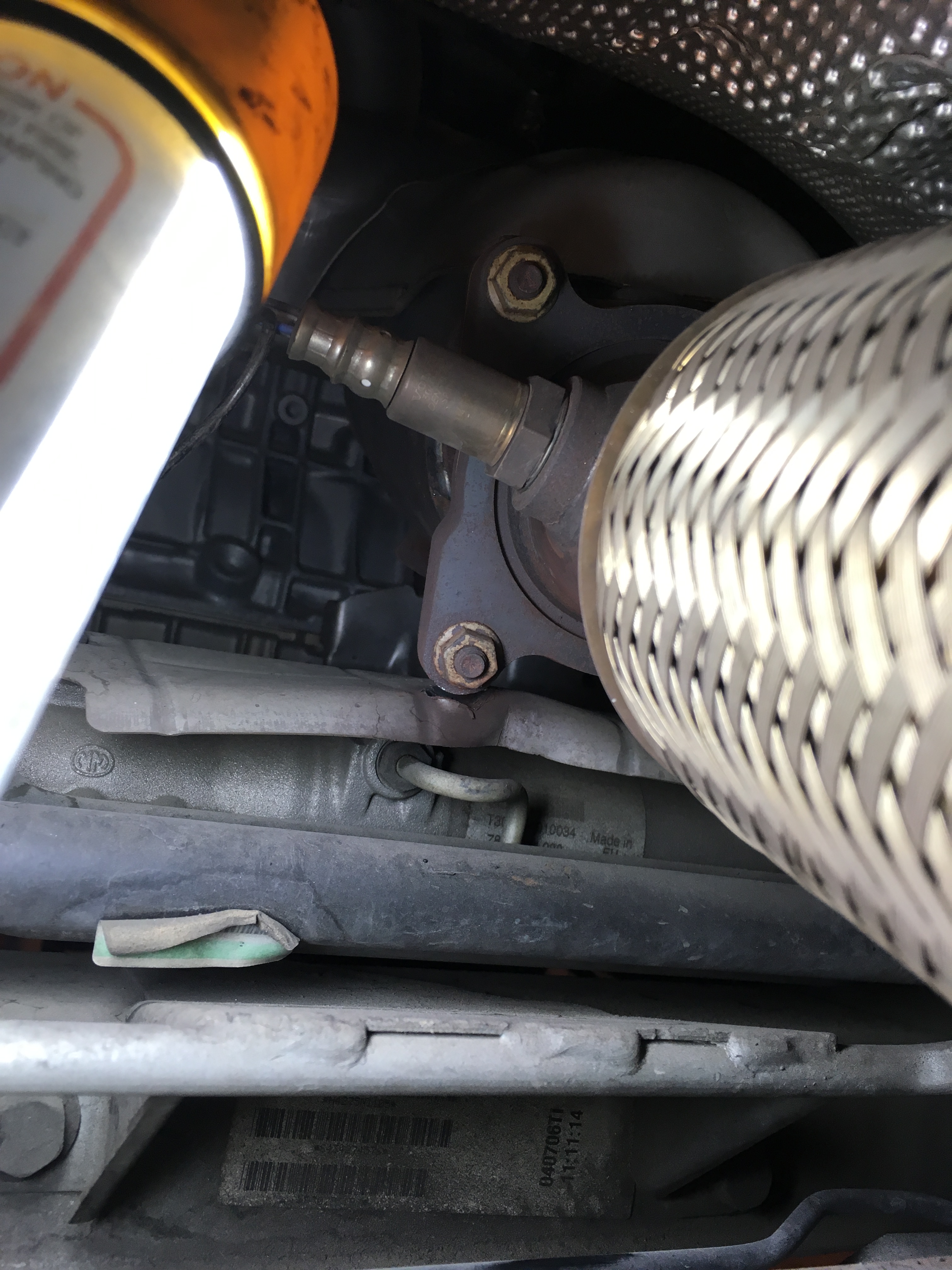

To future readers: the PN is located in 2 places: a sticker on the top of the rack, under the heatshield, about mid point. This was exceeding difficult to clean and see in situ. There is a PN engraved on the front of the rack, driver side, at the bottom of the pinion shaft region. This I managed to read. Picture below are not from my rack, just examples I found online to show locations.

This has the o-ring sealed flanged push-in lines, both for the inter-piping and the external high pressure piping. Not variable assist, plain rack.

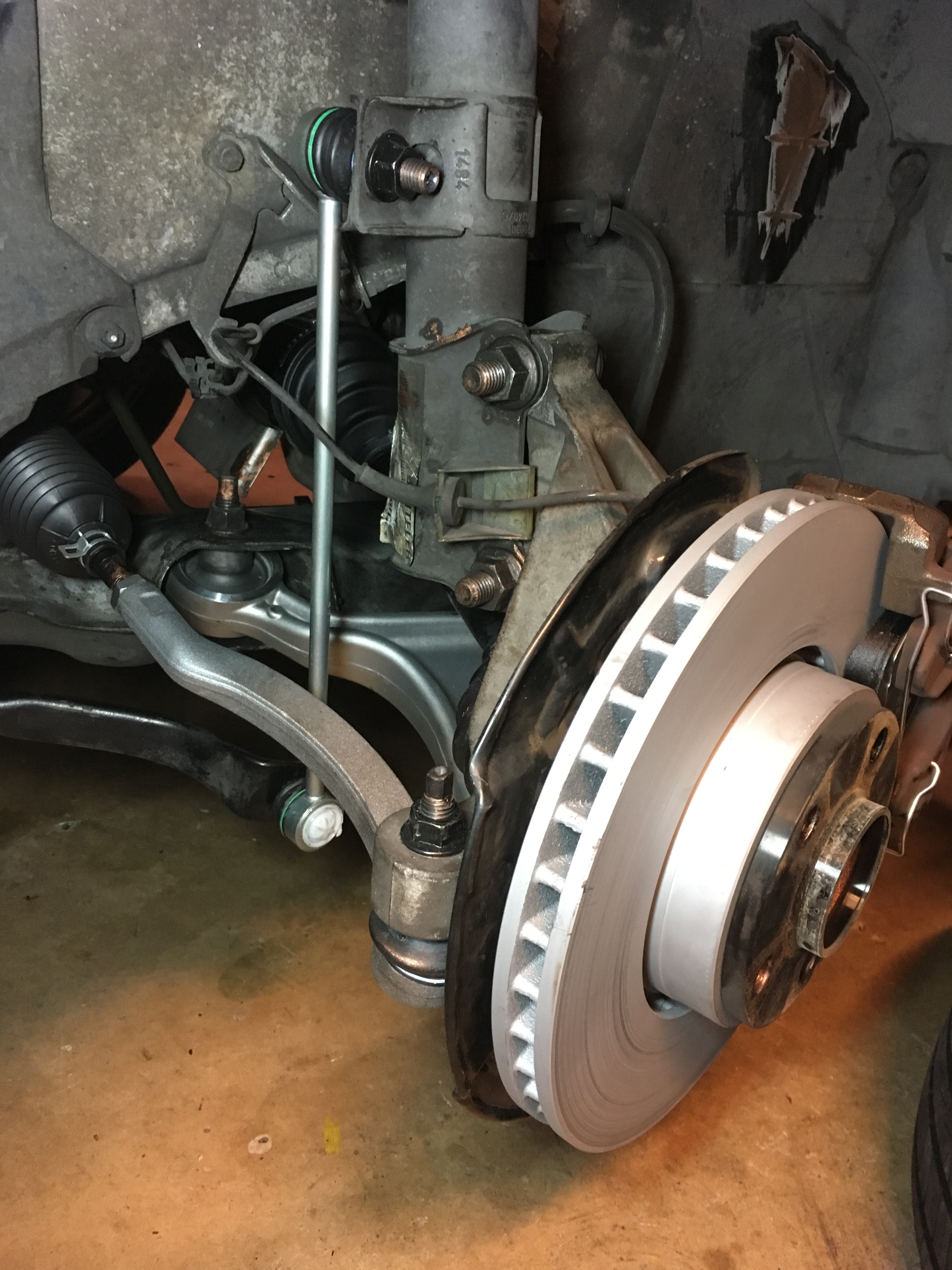

Update, suspension R&R completed. Replaced the following parts:
  • LCA, Lemforder 3497601, 3497501
    Lower ball joint, Lemforder 2555002
    Sway bar drop links, Lemforder 2555302
    inner tie rods, Lemforder 2681801
    Outer tie rods, Lemforder 2667702, 2667602
    Rack and Pinion bellows, Lemforder 3024901
    front brake rotors, Bosch quiet cast 52011348
    front brake pads, Bosch quiet cast semi metallic BP794
    Rebuilt half shafts. These axles have 126k miles on them and the joints were perfect. Rebuilt them with Rein 272441 boot kit.
    (not suspension but replaced this too) Vacuum booster switch, Volvo 31400692
Looking good eh?
Not replaced, and still quite problematic, the steering rack :cry:
I'm impressed by these Lemforder parts. The rubber boots are nice and thick, they are manufactured well; welds are beautiful, castings are high quality and the machining is perfect. Steel parts are plated with some type of Zinc coating, and include all the hardware! The lower ball joint kit even includes the half shaft retaining bolts (volvo 30640878). The bolts have thread-locking compound pre-applied. The nuts have pinch-style interference threads. Really nice kit.

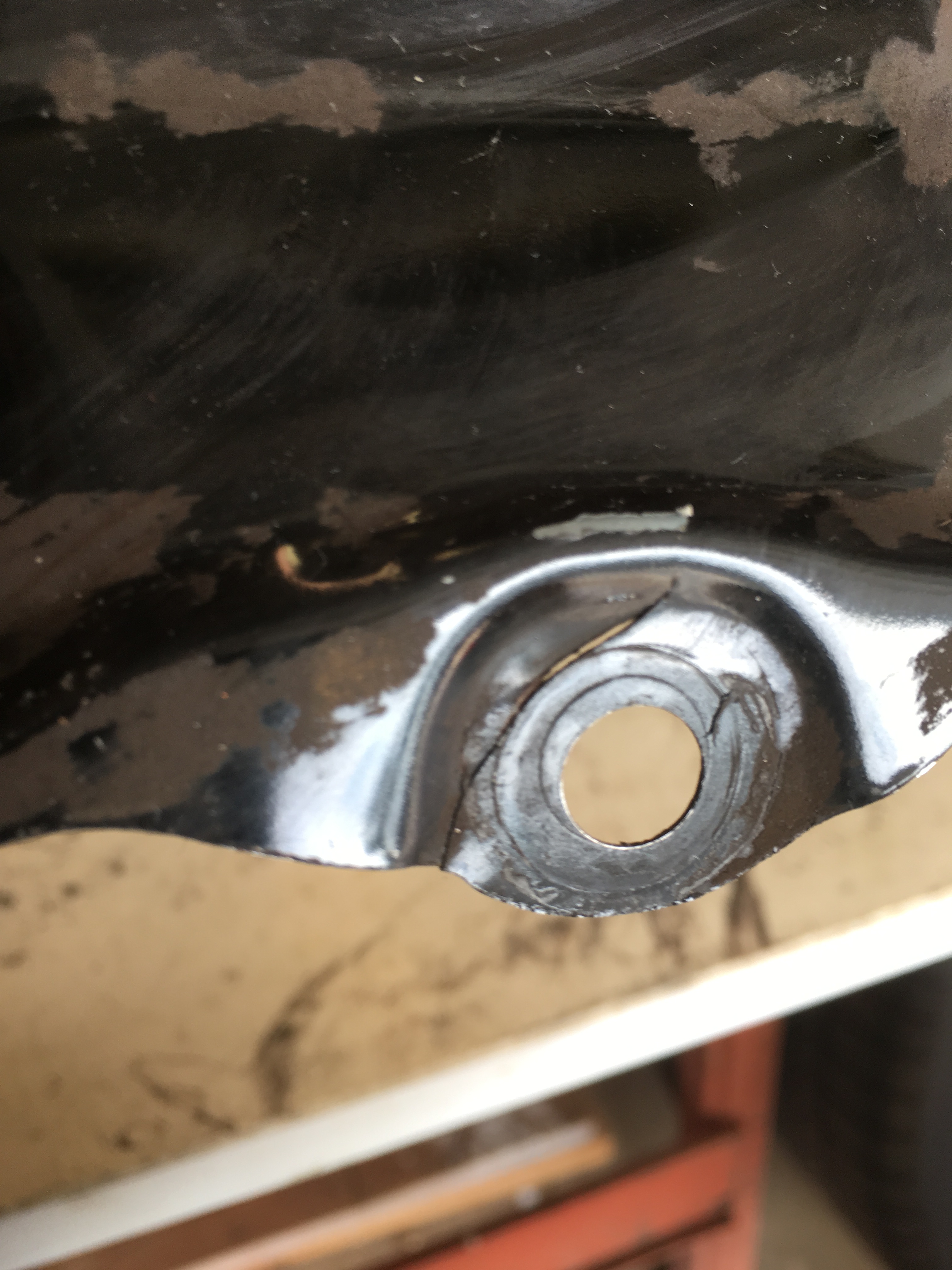

My brake dust shield (Volvo 30760816, 30860817) both have fatigue cracks at the top bolt. Meh. They don't make noise. Will fit a thin large washer there later.

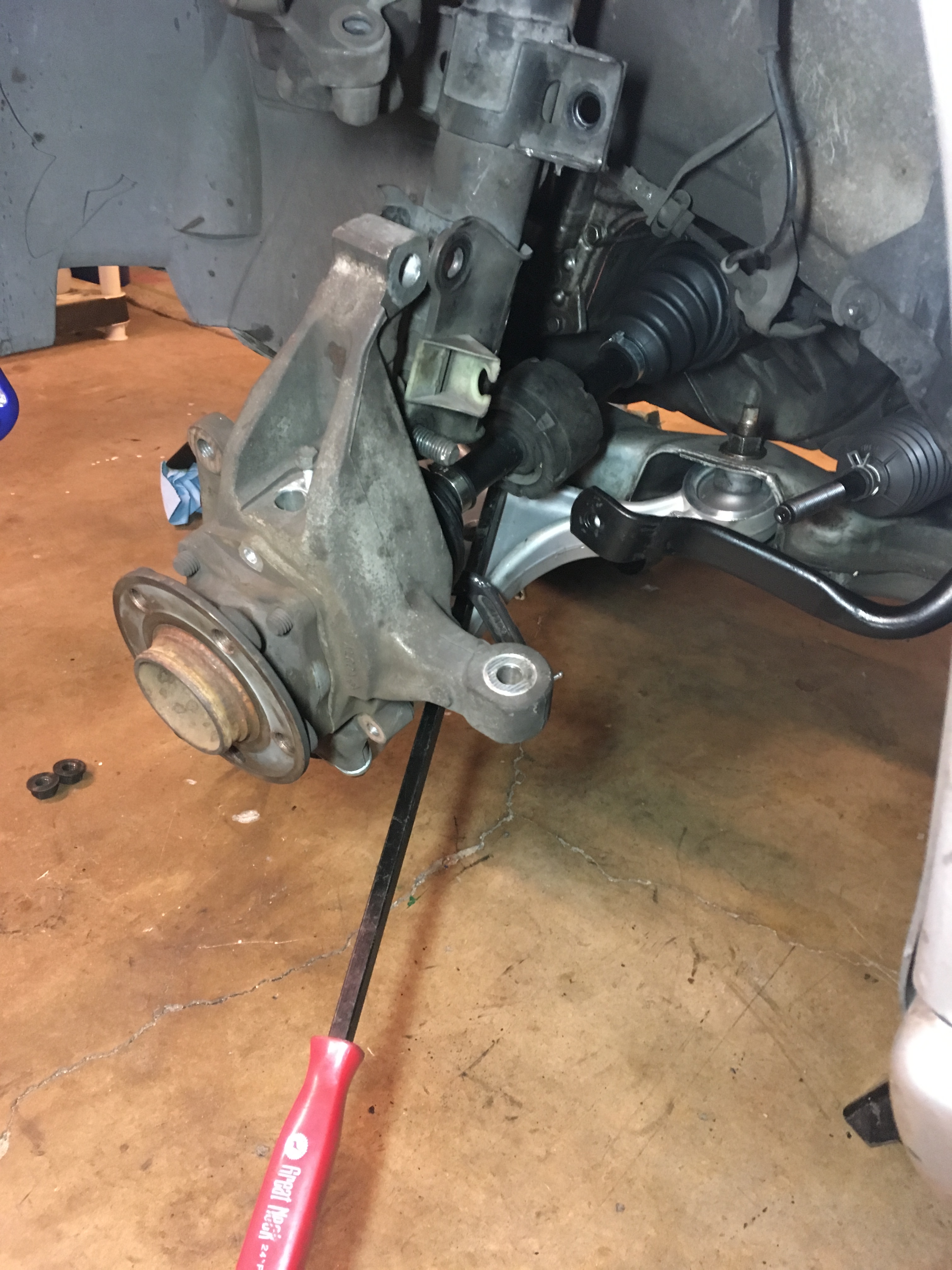

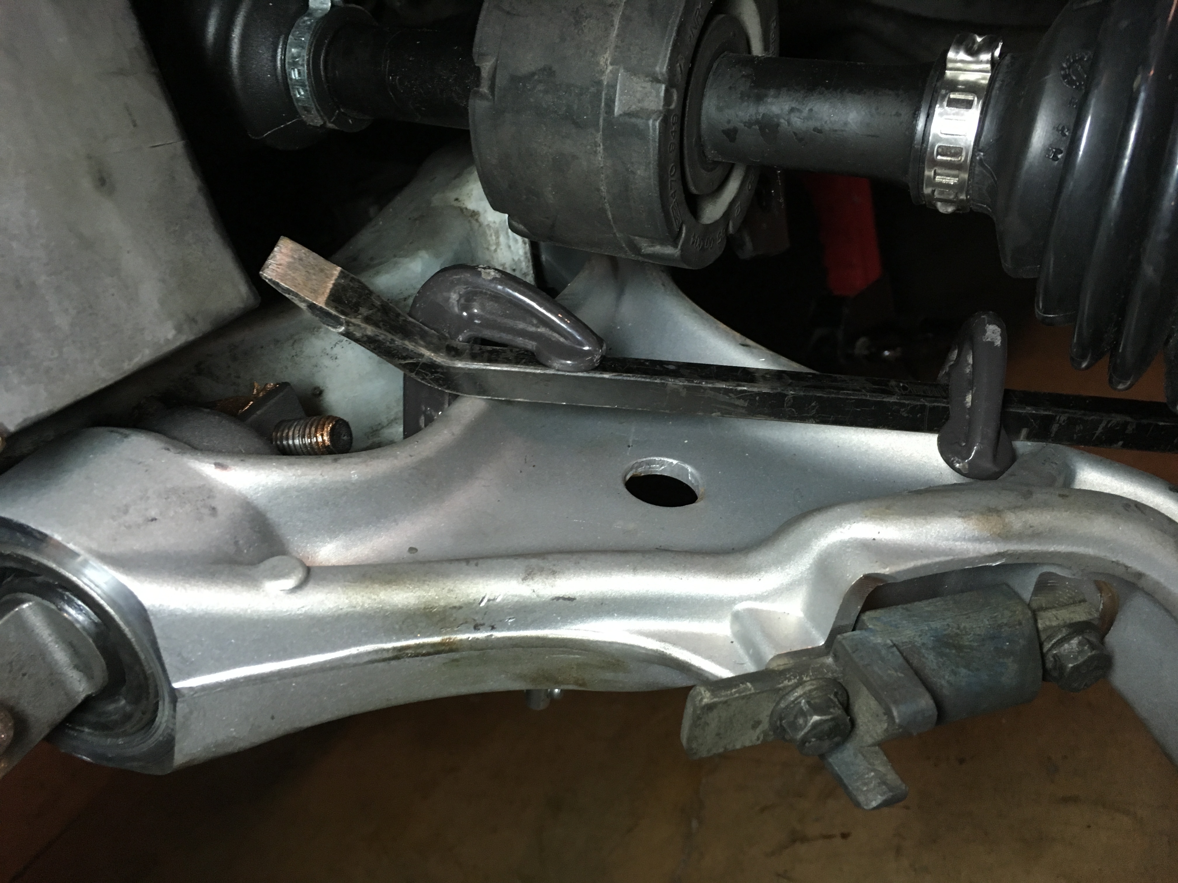

I've heard a lot of fuss about how hard it is to replace the lower ball joints. This was pretty easy. A cold chisel and some screwdrivers as wedges, came right out. Use the bolts to line the new part back up and tap it back in with a cold chisel or drift or other thin wacking instrument of your choice.

The new lower control arm bushings are stiff! If you can depress the LCA by hand to remove the knuckle from the strut - your bushings are shot. To compress the LCA sufficiently I used some 2" C-clamps to secure a large pry-bar. Reef on that to get the knuckle bolts back it.

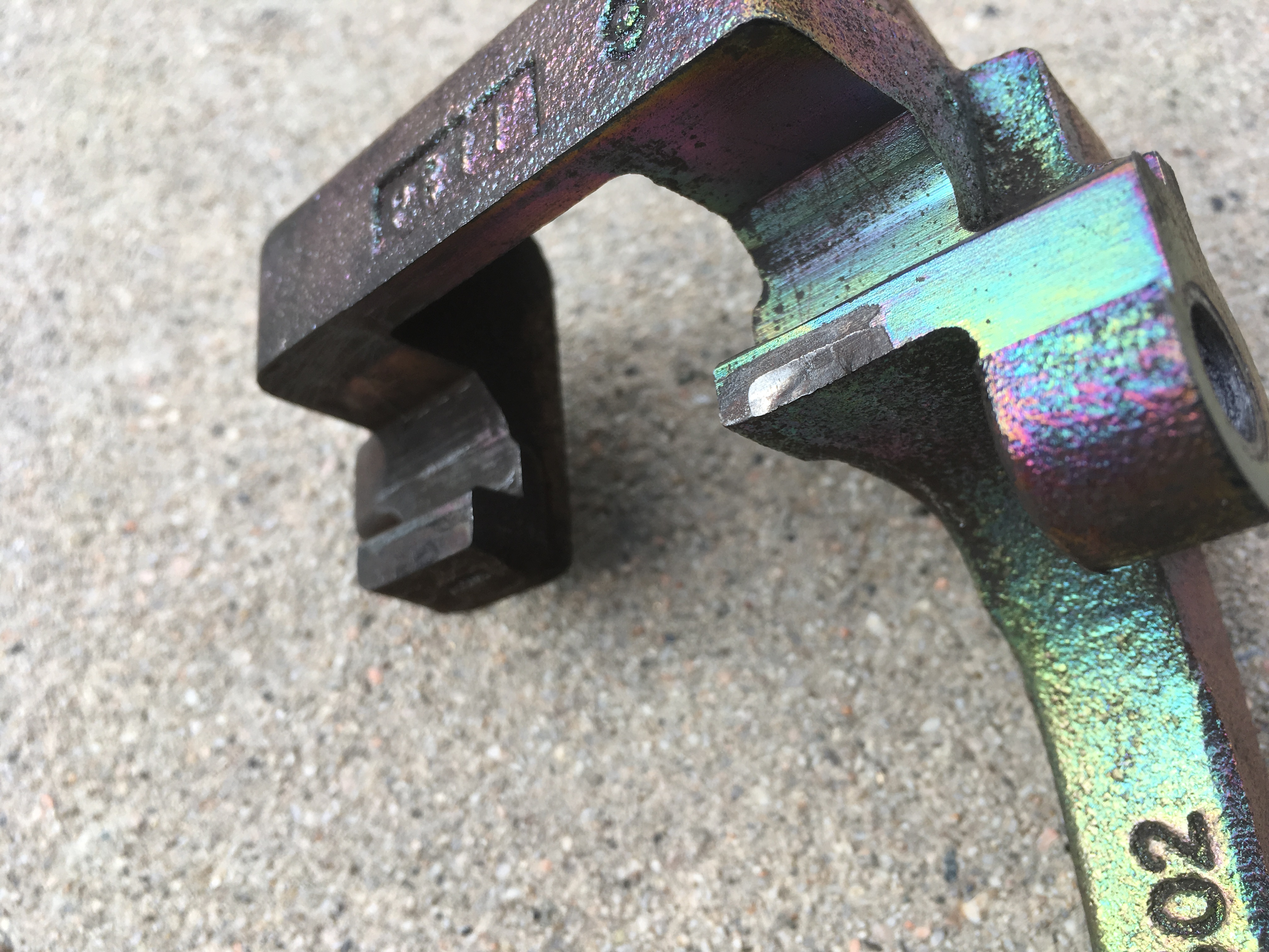

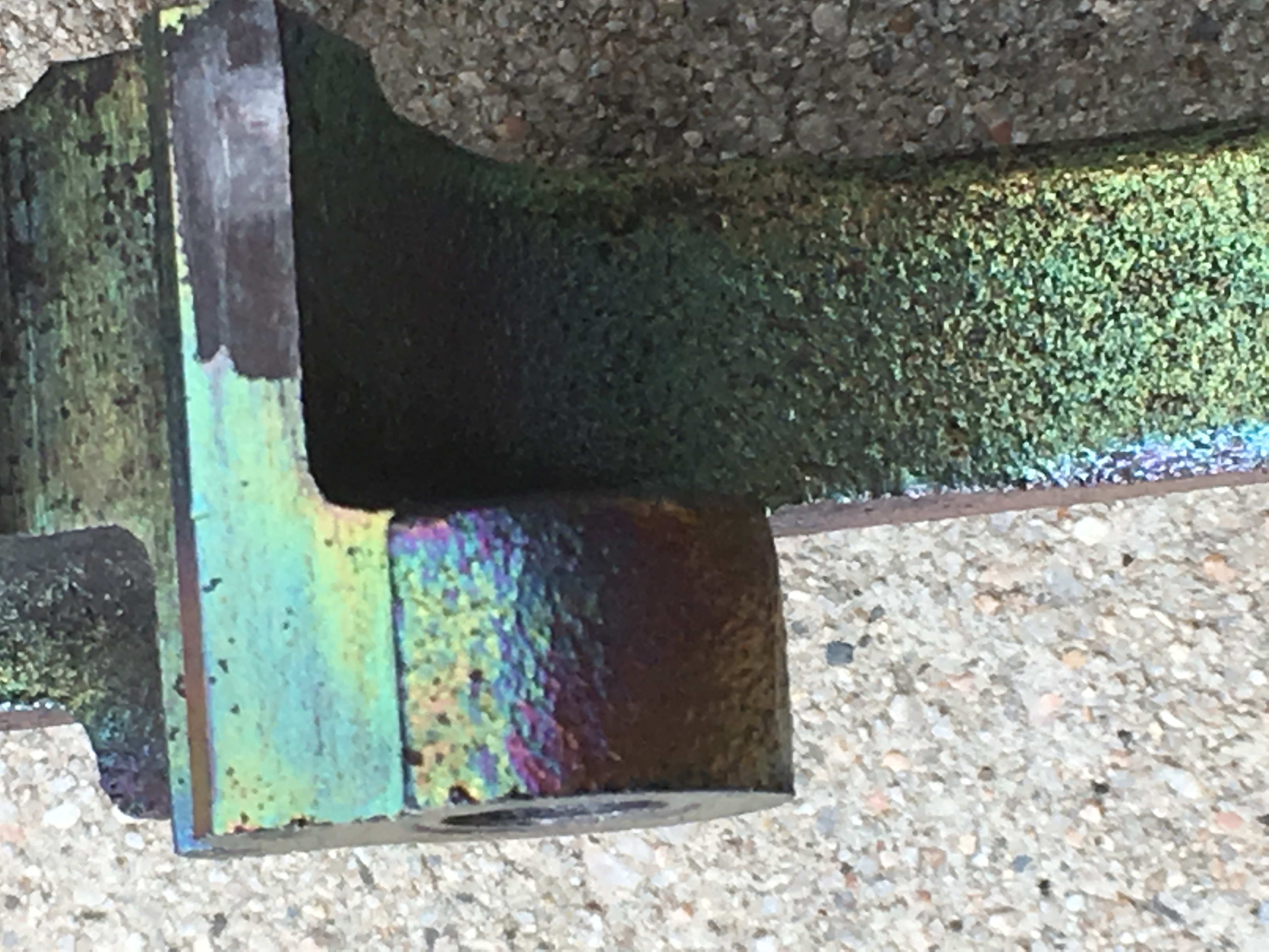

Caliper slide pins look to be in excellent shape, cleaned and reused them. Caliper bracket cleaned up nicely. Interesting to see the Cr6 (?) plating has changed color by temperature.
@ 173k miles, and untold hundred thousand brake applications, the caliper bracket is at end of life. See the wear patterns from the pads, this will impede free motion of the pads and cause premature and uneven disc wear, which usually manifests itself as pedal pulsation. Given these are $55 from Volvo they are now on the repair list. BTW, many other manufacturers use disposable stamped metal slides exactly because of this wear issue, Volvo is missing the boat here.

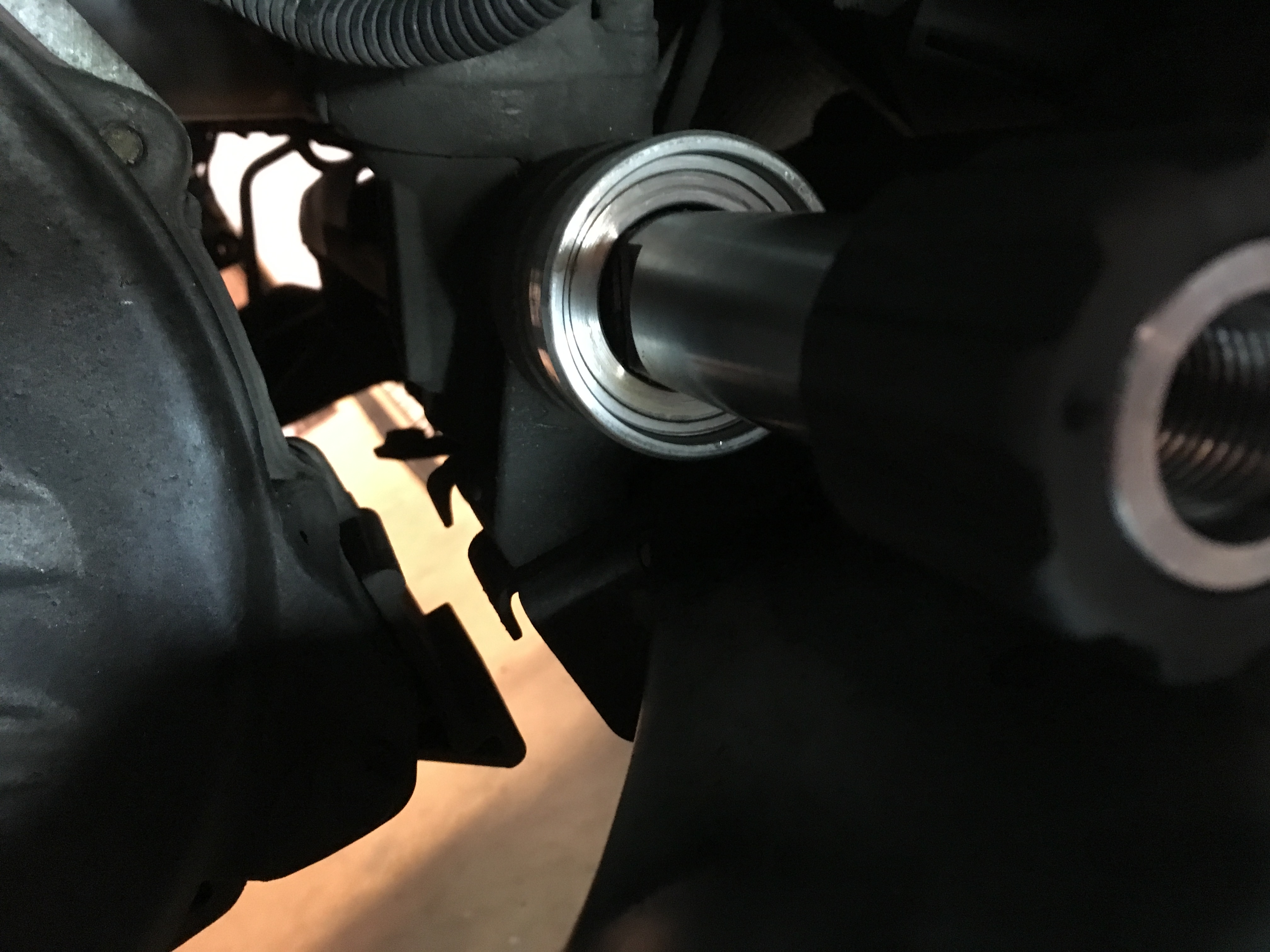

After watching some informative videos about the inner configuration of a steering rack and pinion I'm beginning to wonder if the issue is a loose yoke. See the cartoon starting @ 2:40.
If the pinion bearings are bad, or the yoke is somehow loose then the rack would exhibit exactly these symptoms I'm experiencing. Perhaps the fix is as simple as increasing the preload on the yoke spring? It still boggles the mind it doesn't leak oil considering how much movement there is between the rack and the housing.
