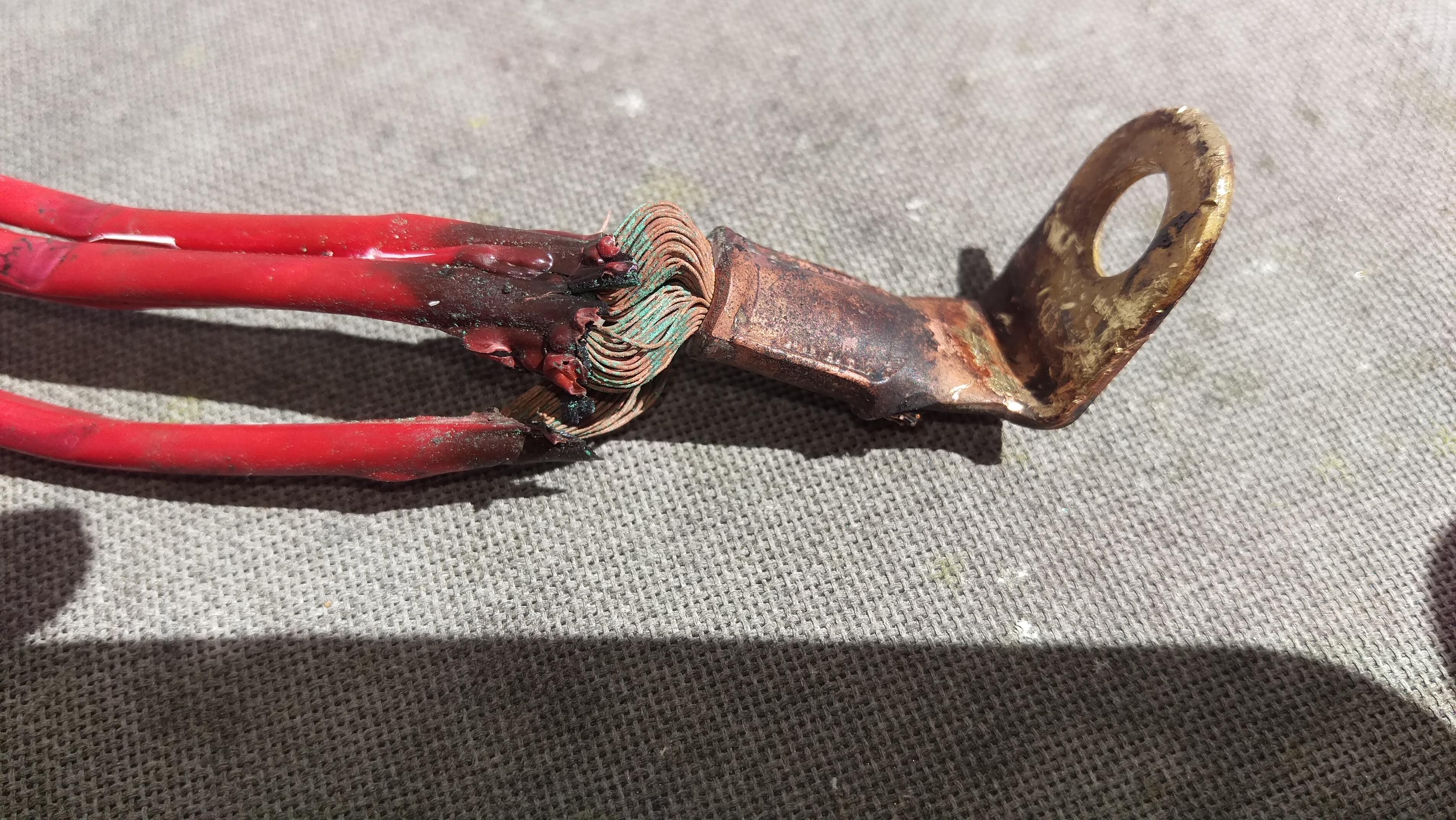

I was looking at it and still don't like the OEM solution - even more so now that I see what they did. This particular part shouldn't move much so their usage of the ~4 smaller gauge wires really isn't a great idea. I'm thinking of removing the ends and replacing it with an 8 Gauge cable which should be good for ~50+ amps and potentially allow additional current with little to no measurable drop. My belief is this was designed this way in order to allow flex - flex that shouldn't occur. I plan on bypassing the existing loom and adding some loom of my own. I just have to find some time to do this, my crimpers, a cold chisel, a hammer and my ~250+W soldering gun and my rosin paste.
This likely won't happen until next week. Rumor has it next week will be dry, so I may make a little workup for it. They're running $60-80 for that wire OEM. I think it is a good part, but I think mine will last longer and be easier to inspect.

Car died on road to work earlier. Cut out, restarted and cut out about 100 yards away - now it refuses to restart, no gauges, nothing. This is actually good news as intermittent issues SUCK, I'd much rather she be on the side of the road dead as it is easier to troubleshoot... Opened hood, smelled a small hint of ozone toward the right. Checked and sadly confirmed that the little B+ wire from Main fuse box was loose on the B+ terminal that connects to the battery post. Tightened it down, no issue, immediately fires up.
In my haste to troubleshoot this issue I didn't check the basics as I should have... I had checked the terminal to the battery post, but not the auxiliary that heads to the main fusebox *face palm*
Time to buy the battery hold down clamp - I am willing to bet that since the battery slides slightly to the left side as I make a right hand turn, this would explain the seemingly random cut outs as that cable proceeded to loosen. Will also install a split-ring lock washer of correct size assuming she doesn't have the issue for another couple of days.

Replaced cable yesterday Per TSB instructions. Easy to follow. But note: Old cable i removed by cutting off end at battery and puling cable out from the TOP of the fuse box. The new cable is installed by passing the battery end DOWN through the top of the fuse box and through the bottom grommet. To do this, you must straighten the terminal that attaches to the battery first. The grommet at the bottom has great stretchability.
BTW, nut on B+ cable was only finger tight. My theory is heat/cool cycles loosened the nut and that led to arching which damaged the wiring by overheating. B+ cable was replaced in 2013 by a guy I really trust. I am 99% sure, that nut was tight when he installed the new cable in 2013.
Check every 6,000 miles or so to be sure nut is tight and use dielectric grease on both ends.

Once you read the TSB it is obvious you can fabricate a new cable for a few bucks and run it the same way the OEM cable was run. I had an OEM cable on hand so I used it. I plan to keep an eye on mine...at the first sign of over heating,I will run a "helper" cable. So far, even with lights and AC, the terminal in the fuse box runs cool.
But, periodic checks on nut tightness at terminal will save the day!
