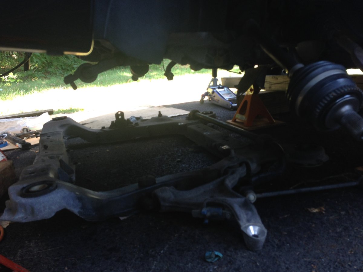

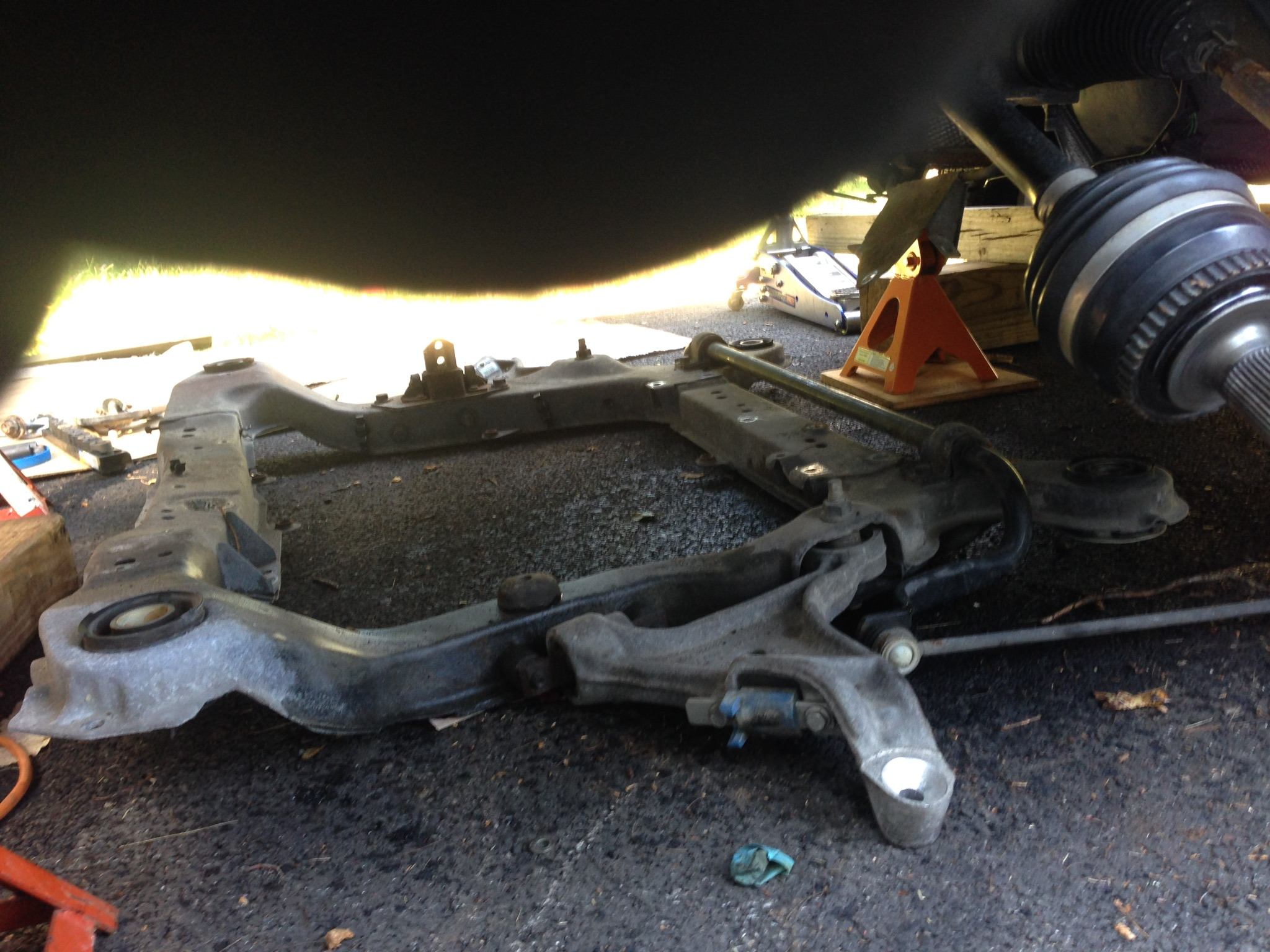

1 1/2 hours dropping subframe - this is a Southern car so things were really good rust and corrosion wise.

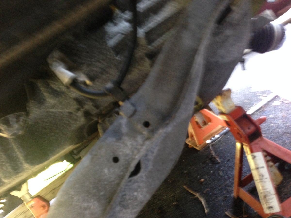

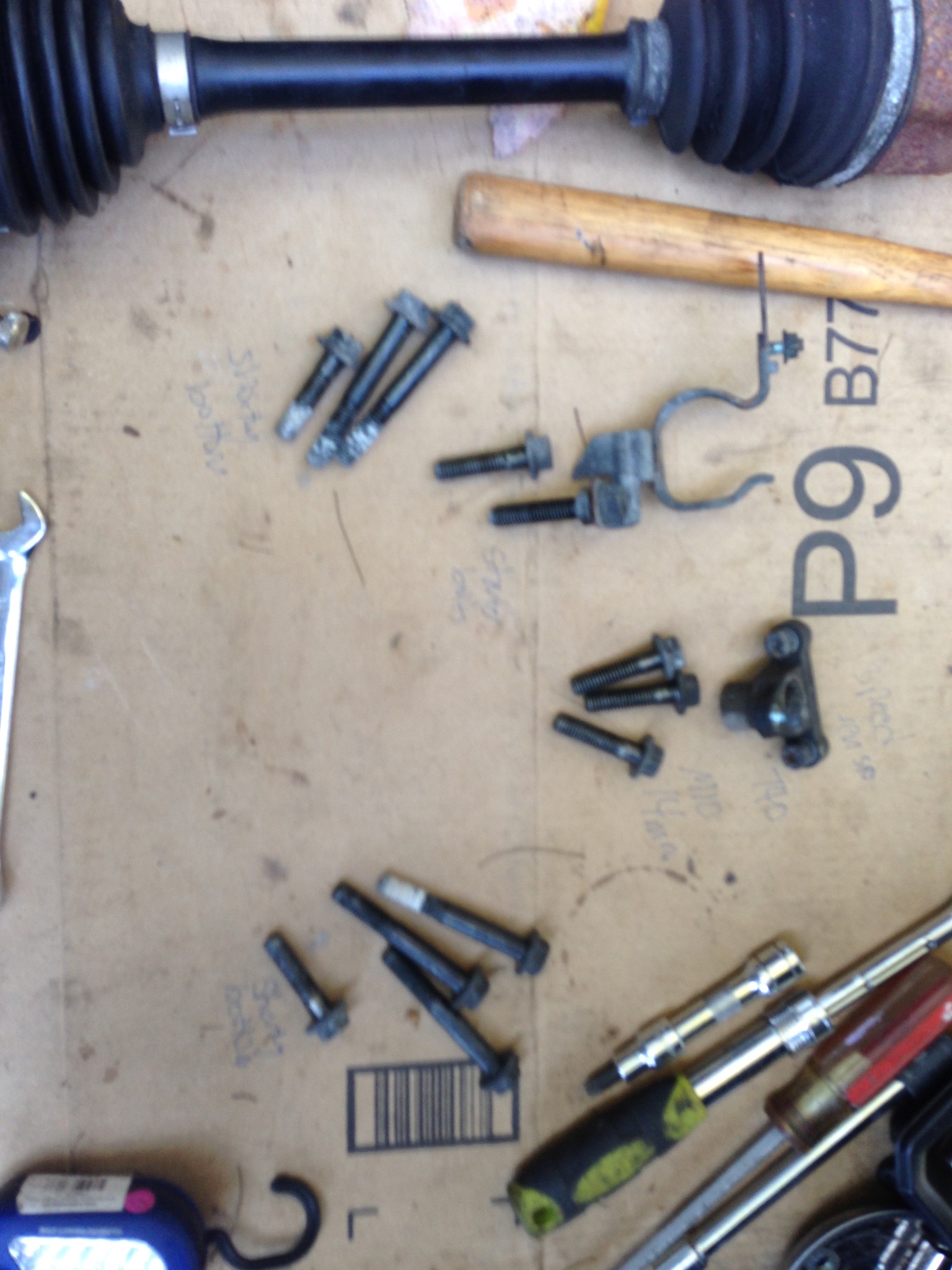

I found two connections not documented in VIDA - both on the front top of subframe, M6 bolts holding PS tube and ground cable - both obvious
The sub frame is not heavy - maybe 100 pounds total? Easily moved by one person, and easily lowered in stages by hand onto blocks while watching for things hanging up.
VIDA cautions to make sure the steering rack threads clear the subframe - mine did without intervention.

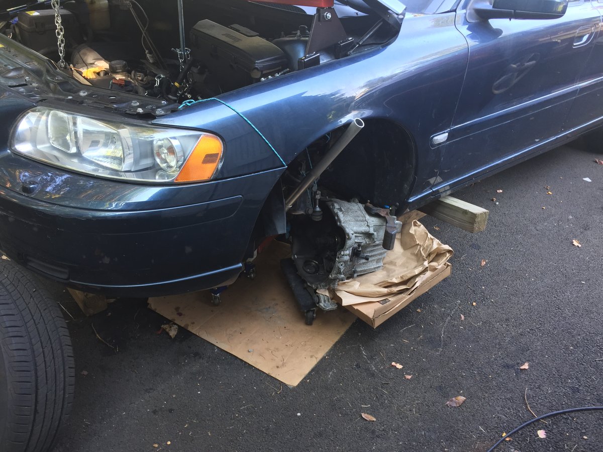

Another 2 hours to get the engine dropped, trans out, and clutch/seals sorted

Wire harnes screw was forgotten.

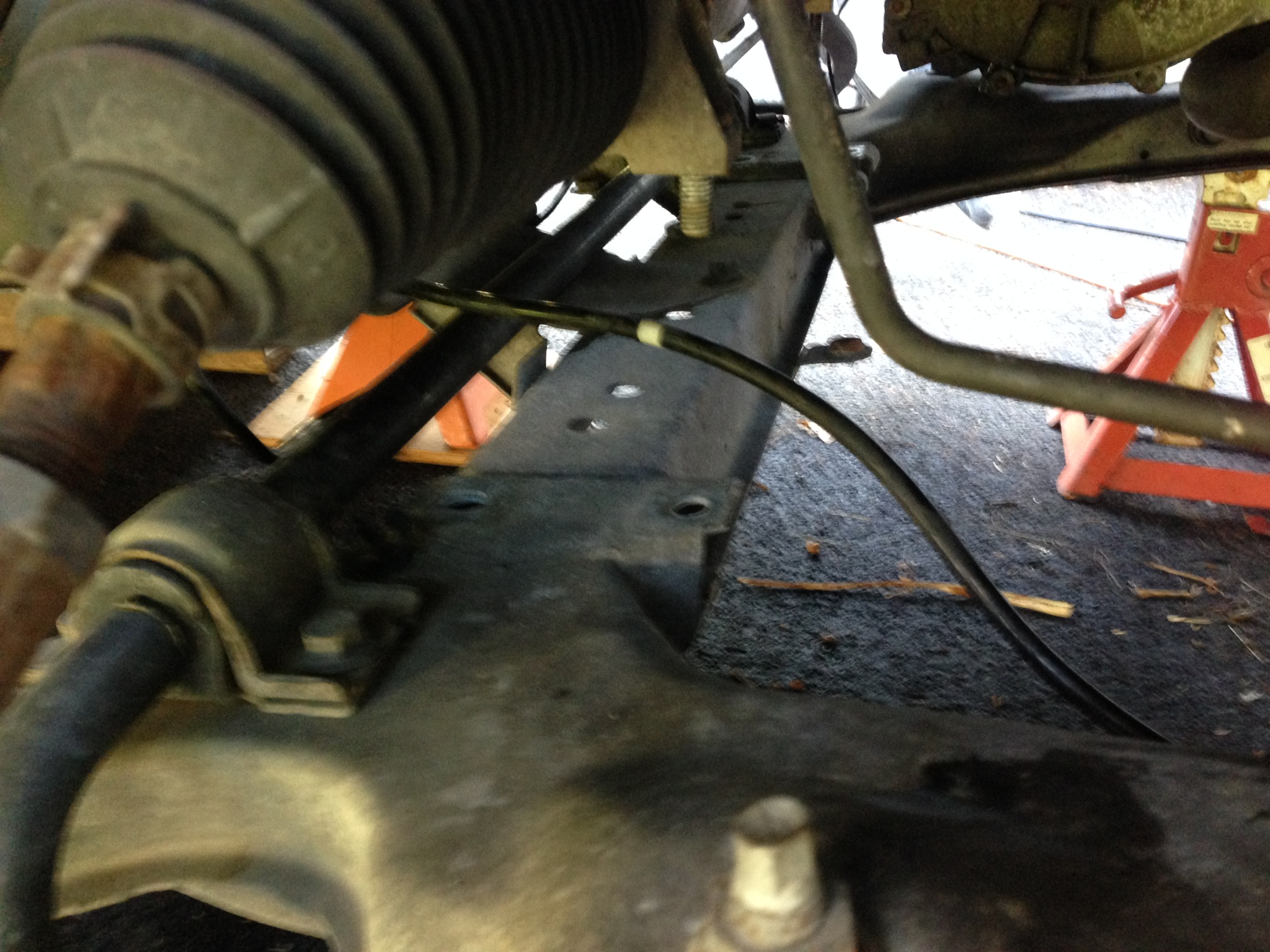

Subframe drops easily by hand, can lower by steps easily
Ker plunk
Ker plunk

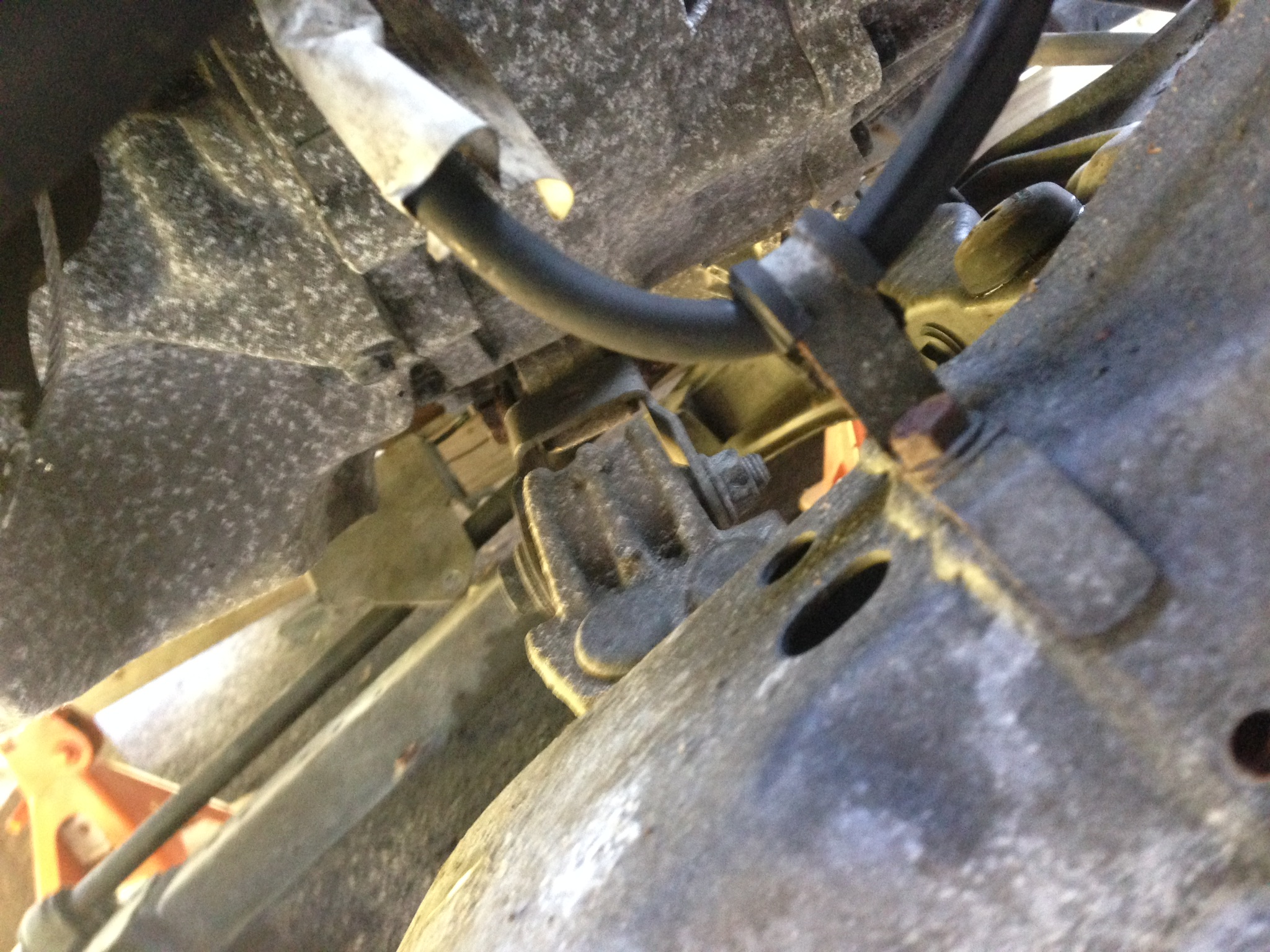

Also PS pipe brace on top of subframe

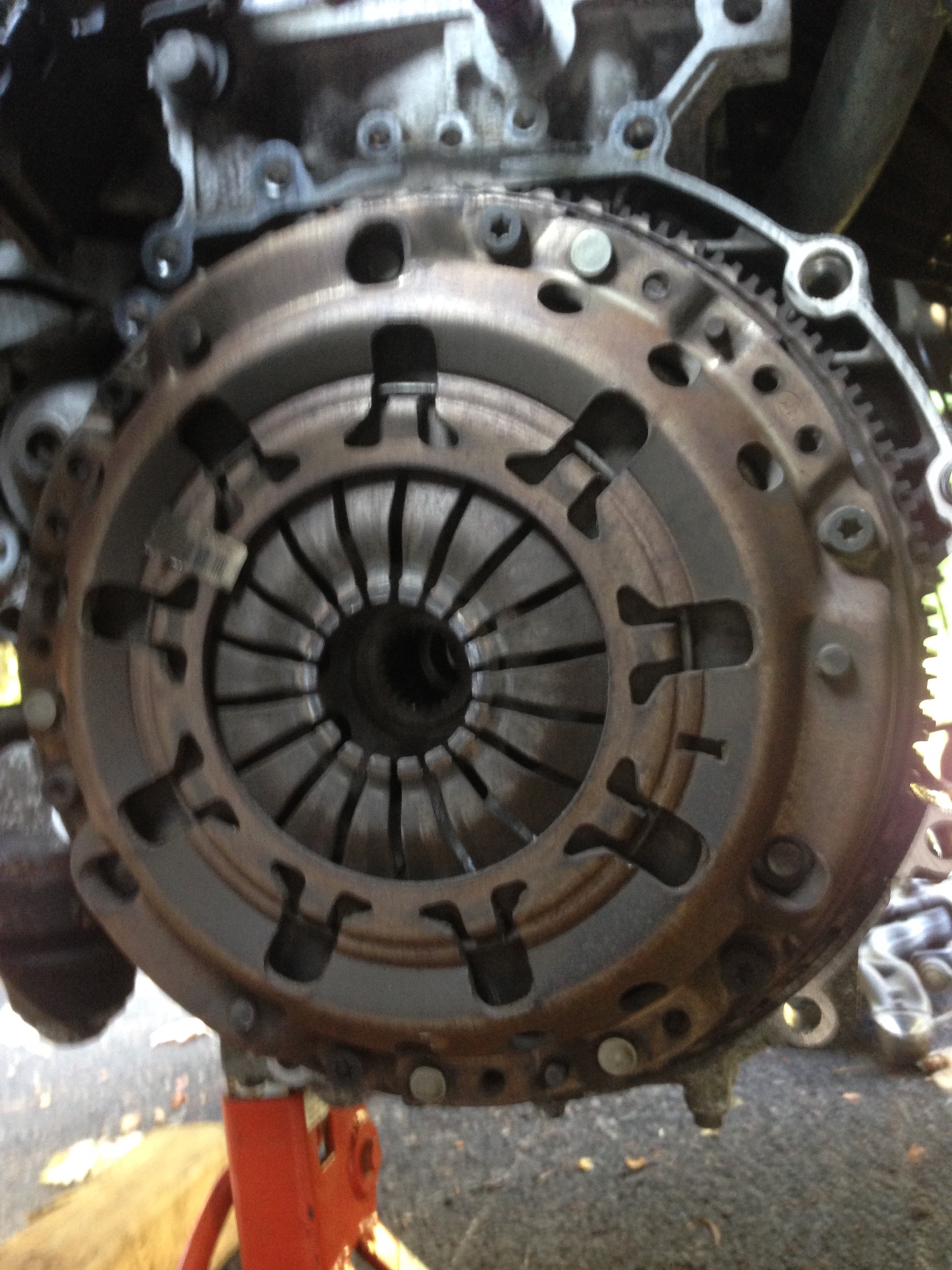

HAve to read up on counter holding and releasing clutch plate with DMF

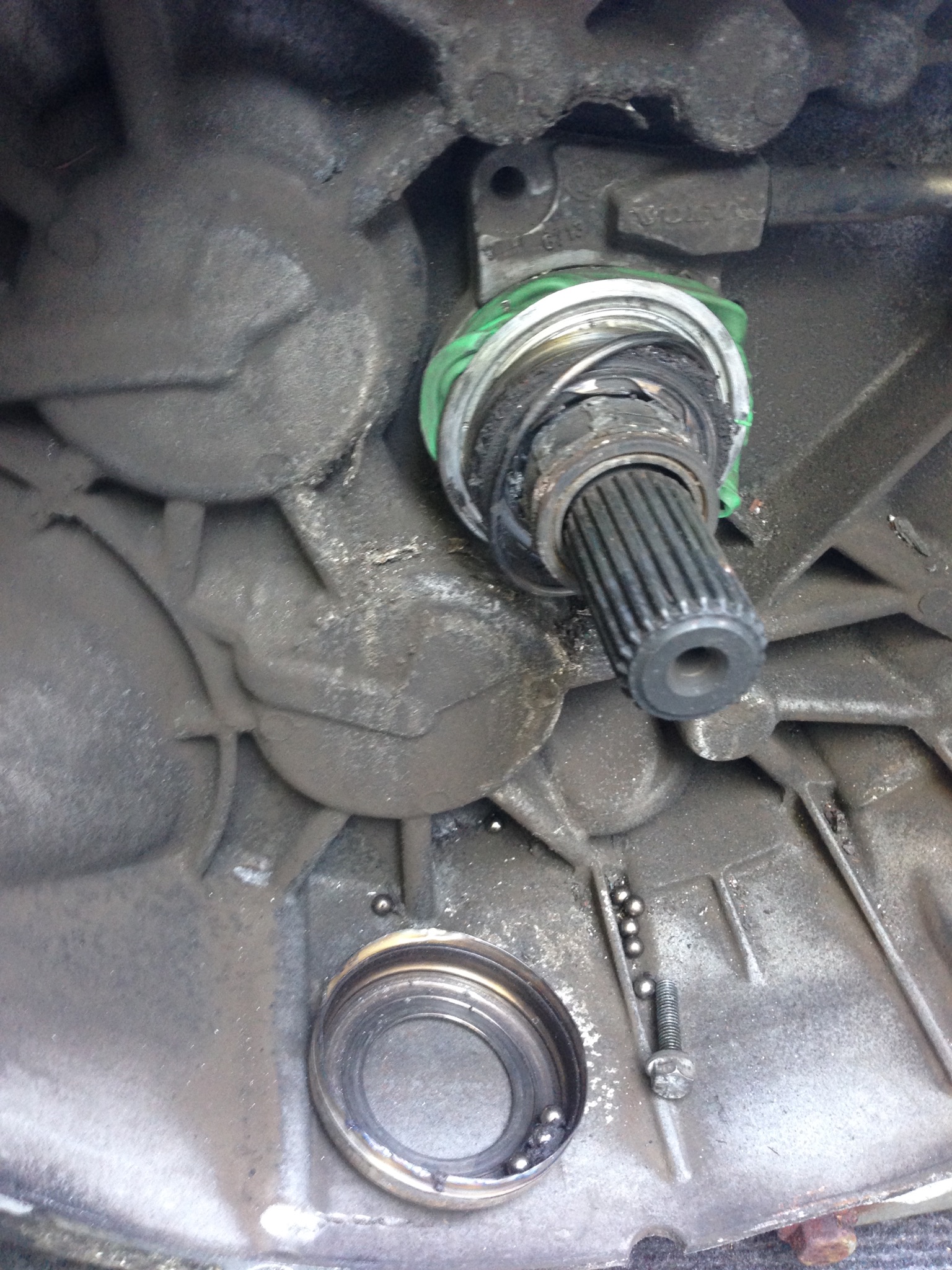

YES!! One M56, delivered for your inspection...
Hey VOLVO!!  You were supposed to mount this with TWO M12s !!!!   Detonated Release bearing, Clutch slave cylinder

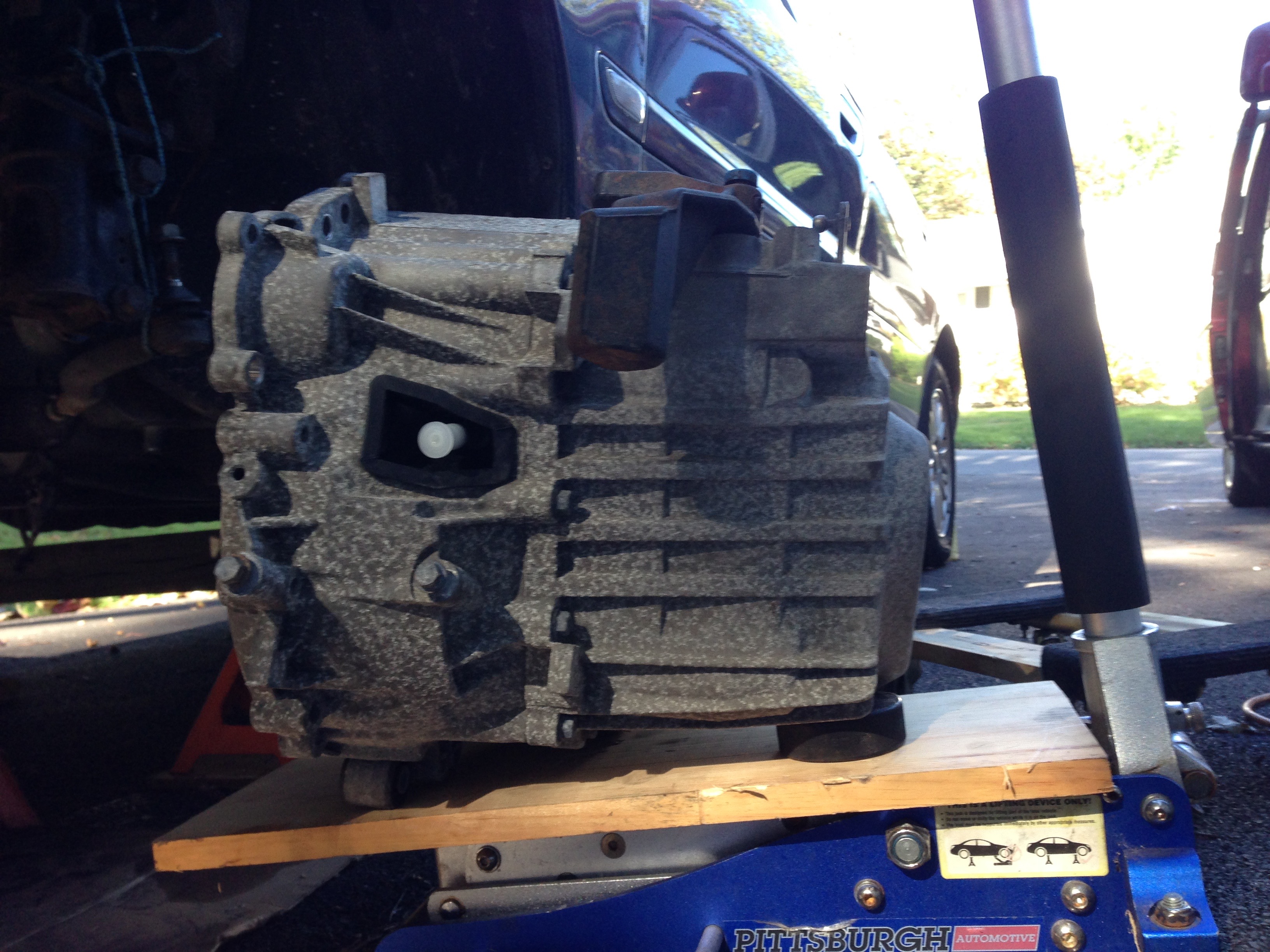

VIDA " Release 7 screws" - yeah, all 12 of them.

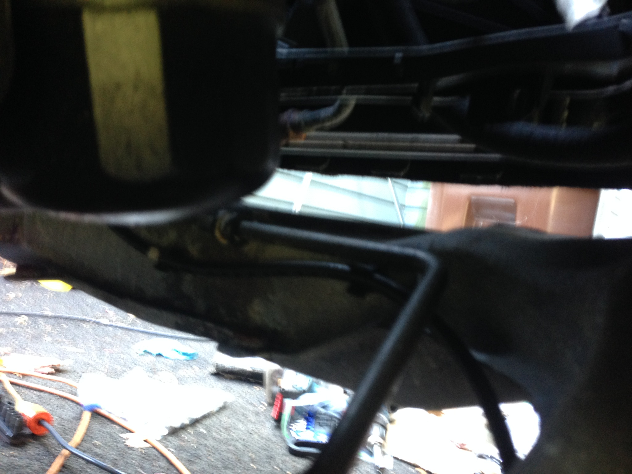

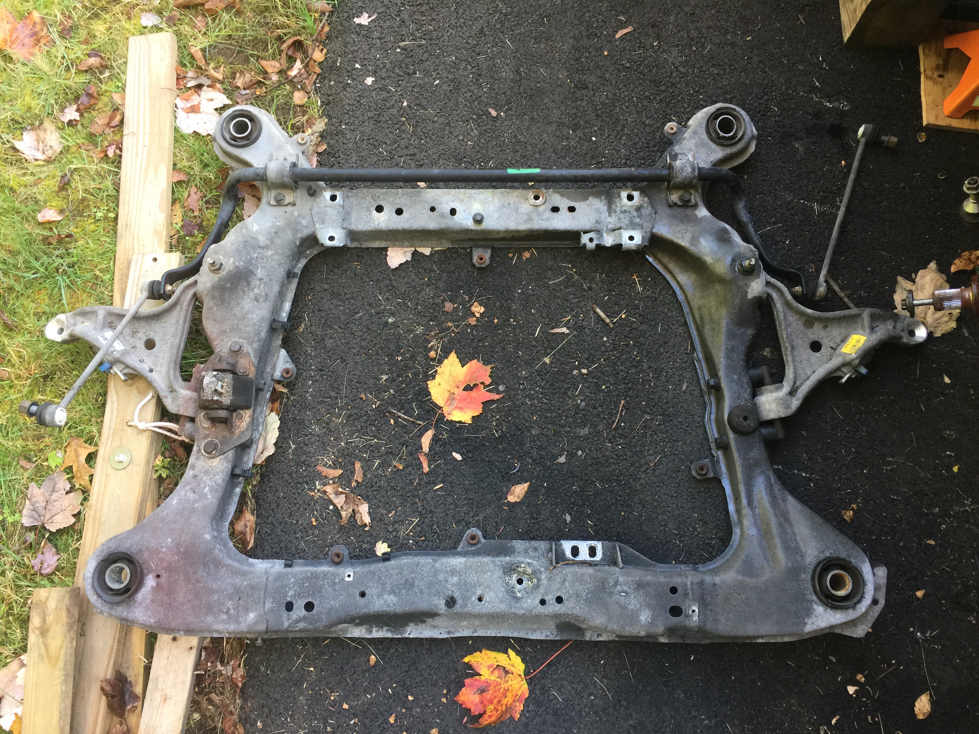

Corvid view of the subframe - You can tell this one is Canadian

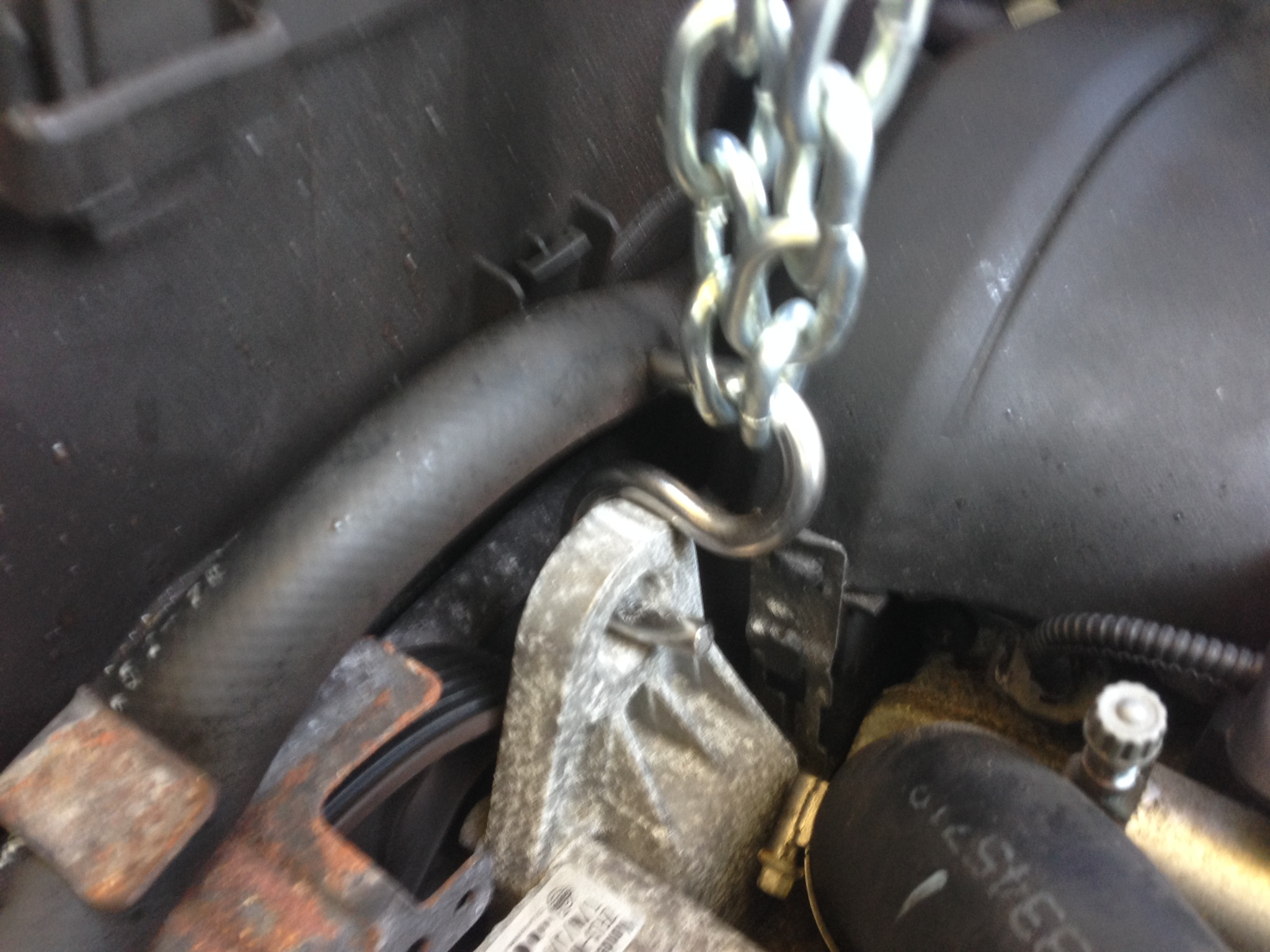

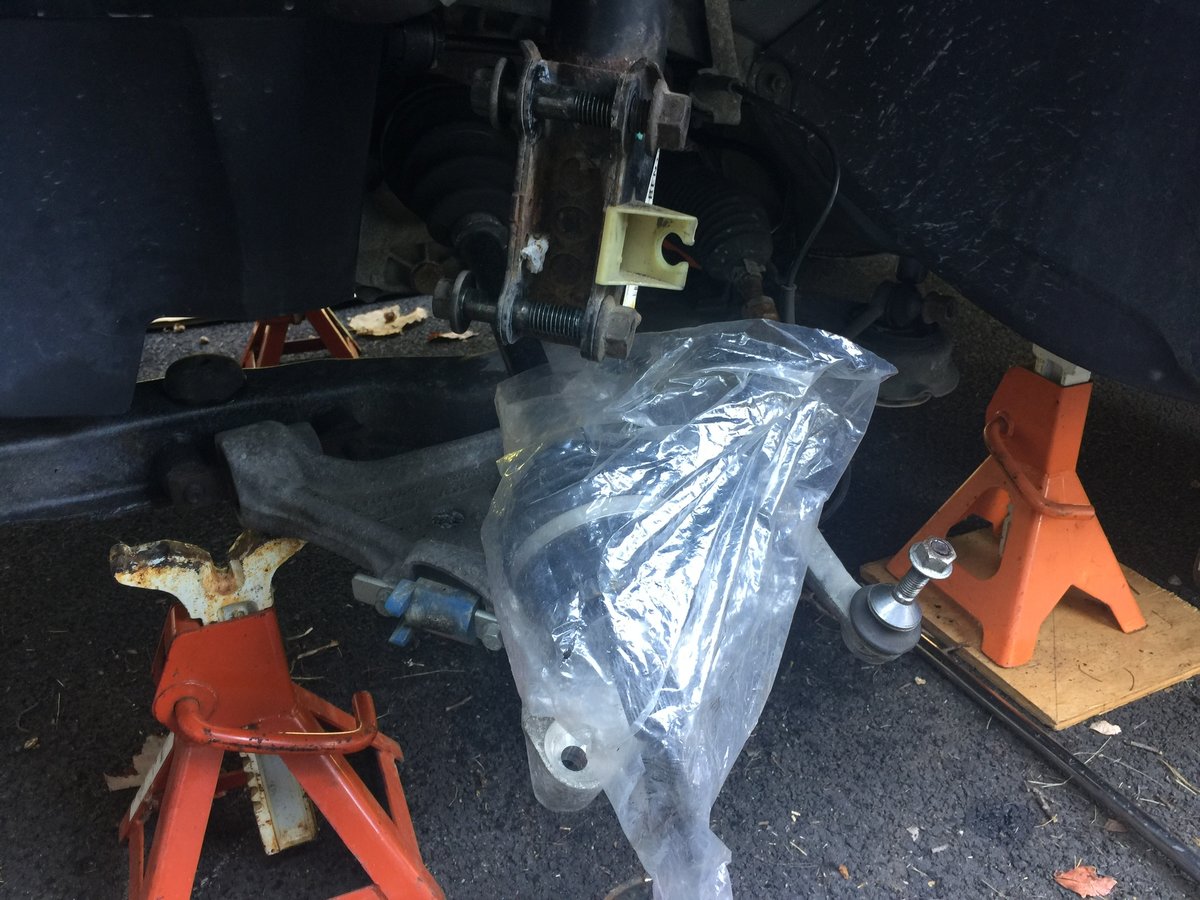

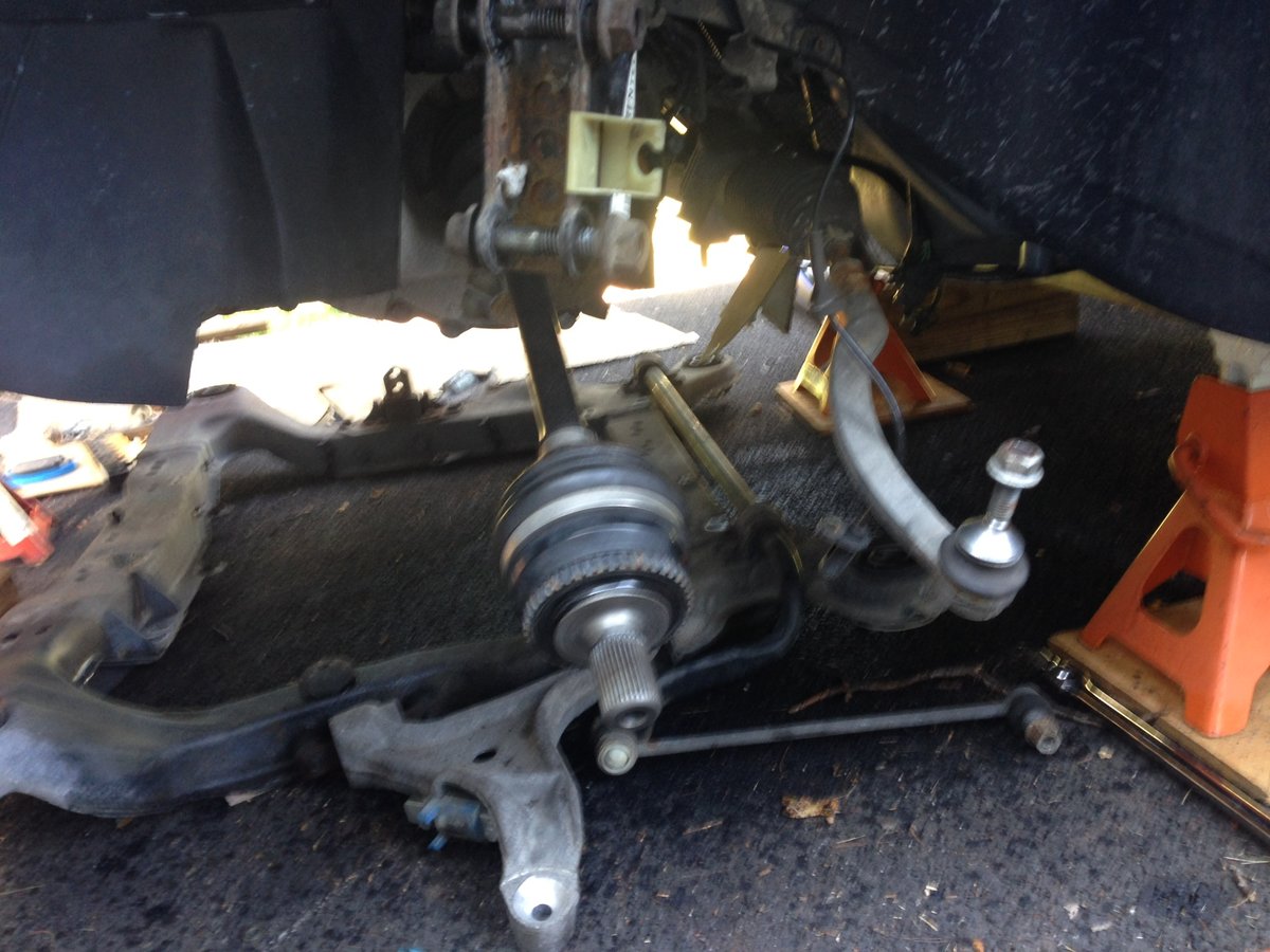

NO! S Hooks are  a REALLY BAD IDEA

You don't want the PS rack flopping around when you drop the subframe
VIDA makes reference to a fancy flexible retractor - I tied the pass side of the rack to the engine lowering bar, making sure you don't go through the sway bar, and then put a jack stand under the other end of the rack to keep it from flapping in the breeze.
