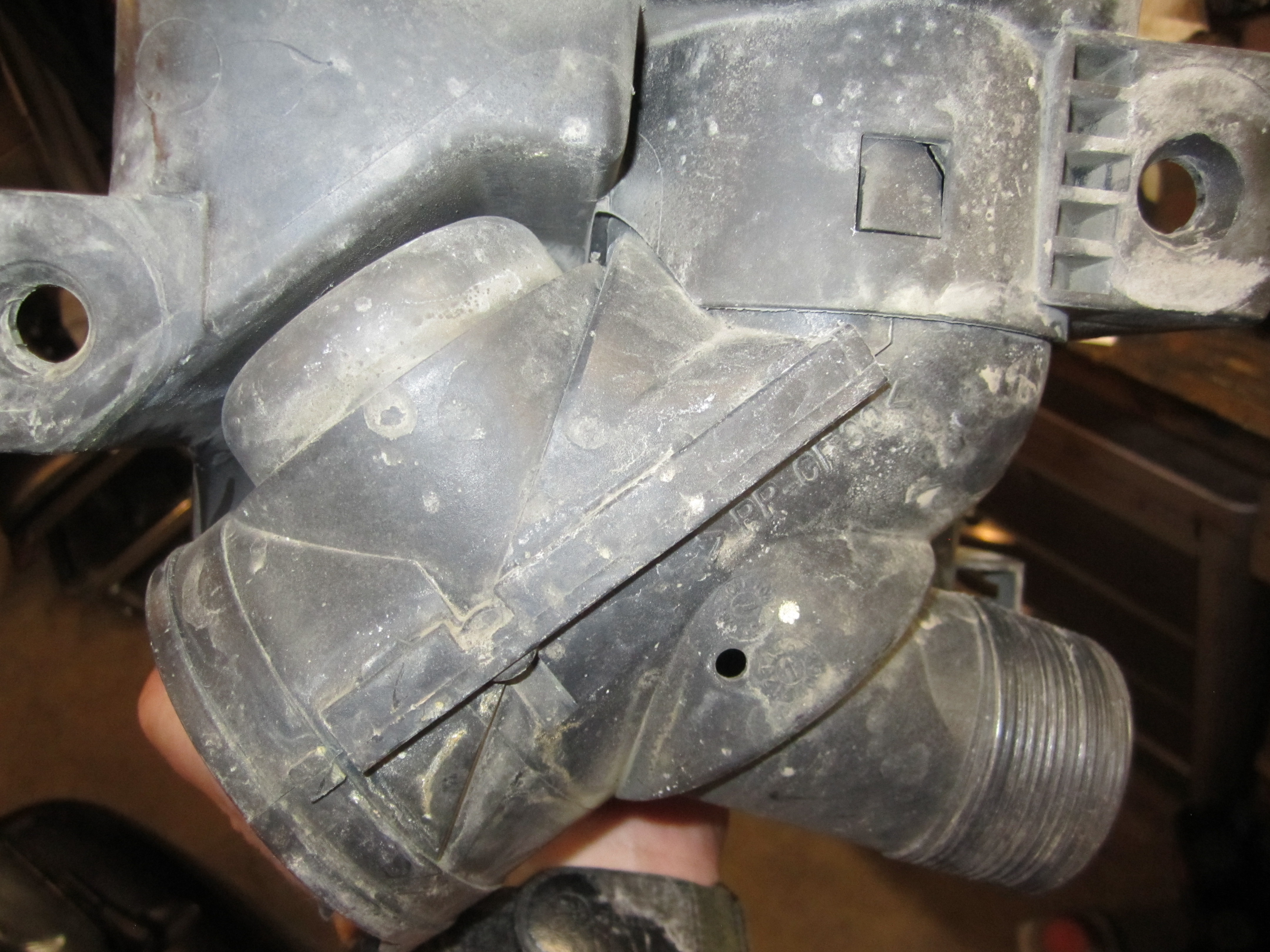

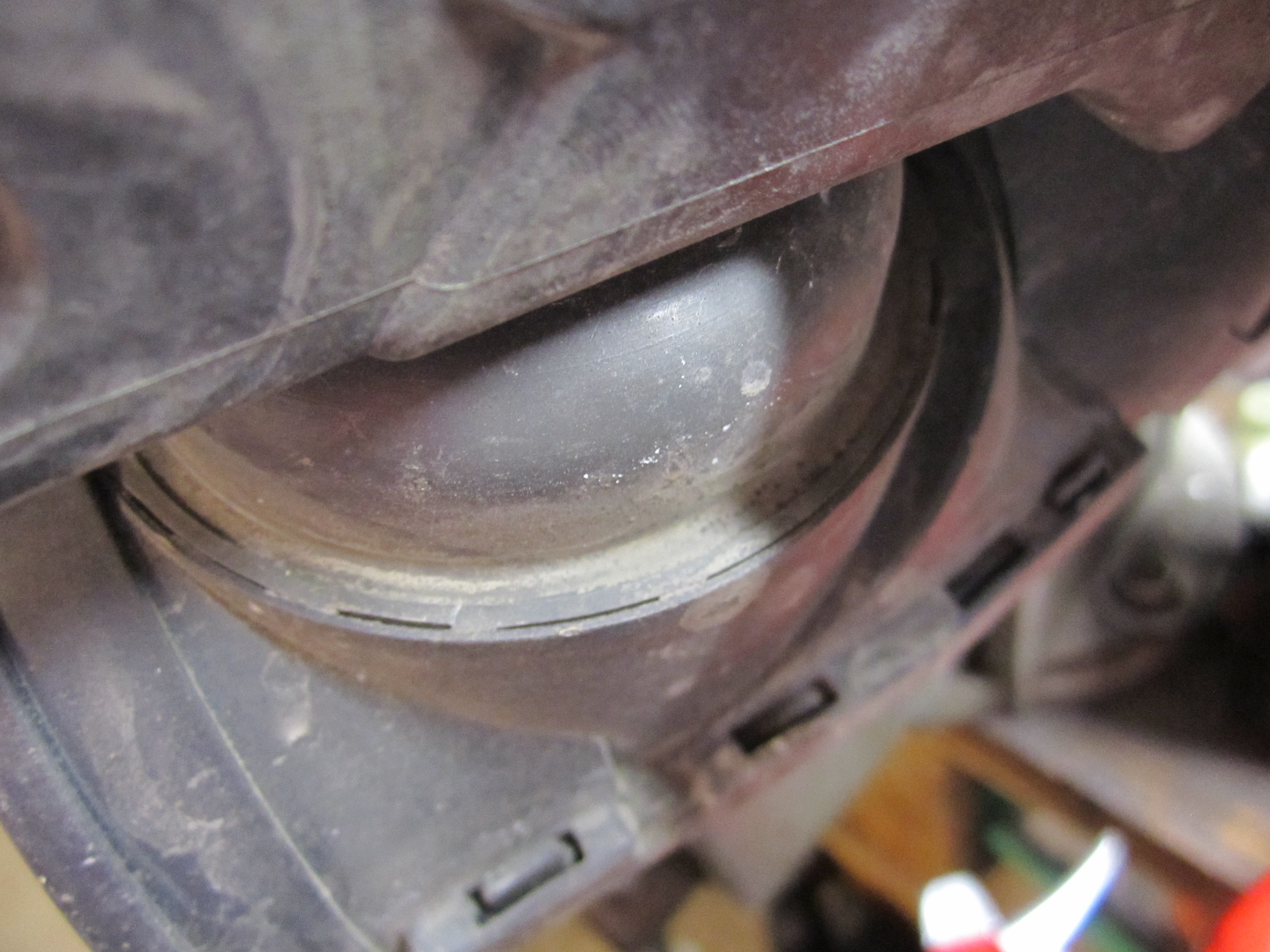

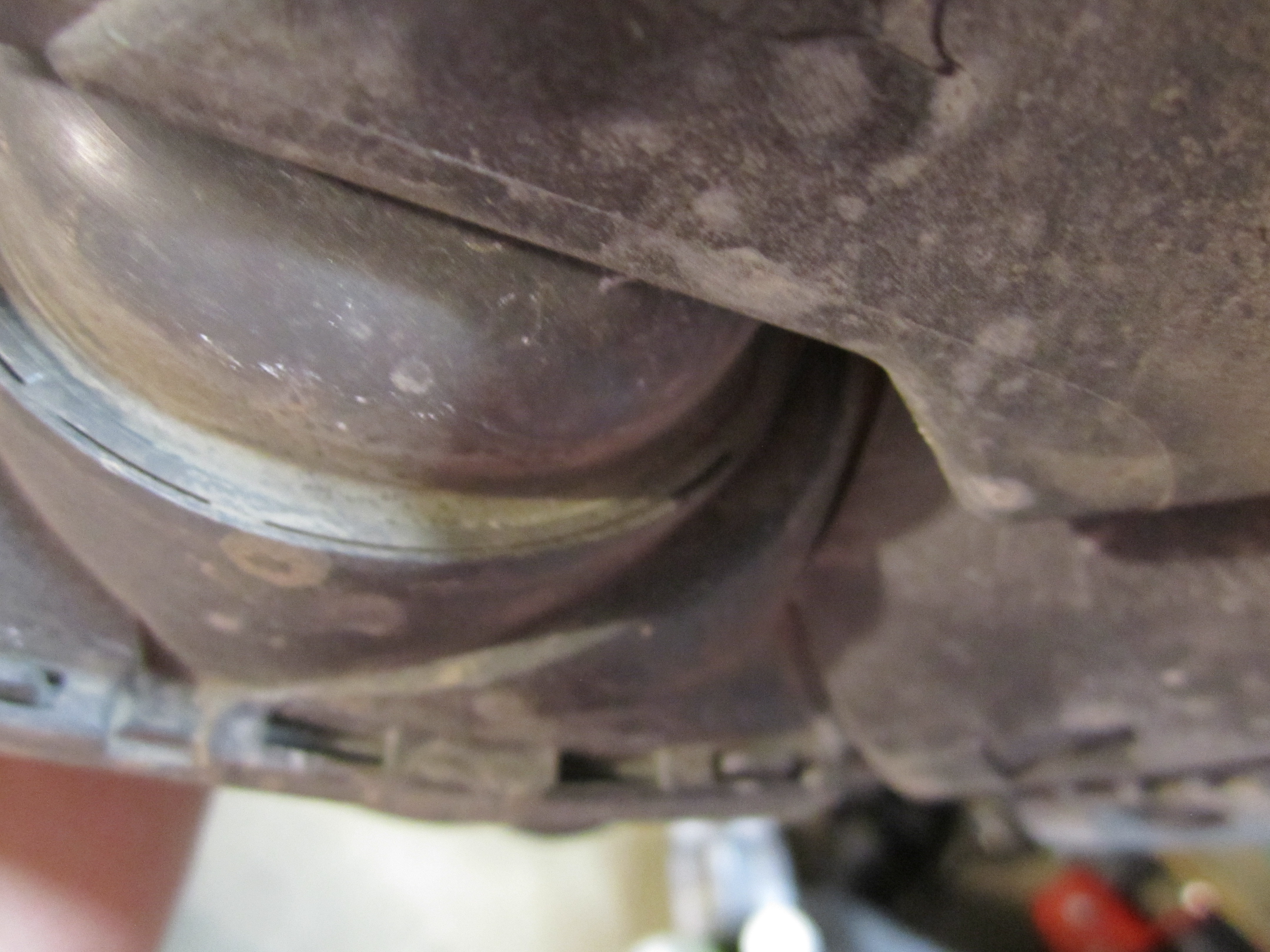

I have taken some more pictures of my spare thermostat housing to see if it is the same. It has similarities to the first pictures that Chuck posted and I can see little 'dimples' possibly that might be the pry points.
Are the little slots the points you are talking about that are the pry points? They are very small.

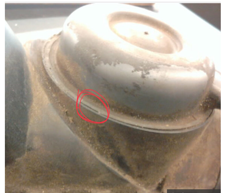

Neil, The area I’ve circled in red is what I am assuming to be Klaus is referencing as possible options for pry points.
- 748CCC25-36A4-4AB1-A80F-EF8AB3F3E4CF.jpeg (427.37 KiB) Viewed 1008 times
- Posts: 15506
- Has thanked: 2210 times
Likewise, that is what I am thinking.
