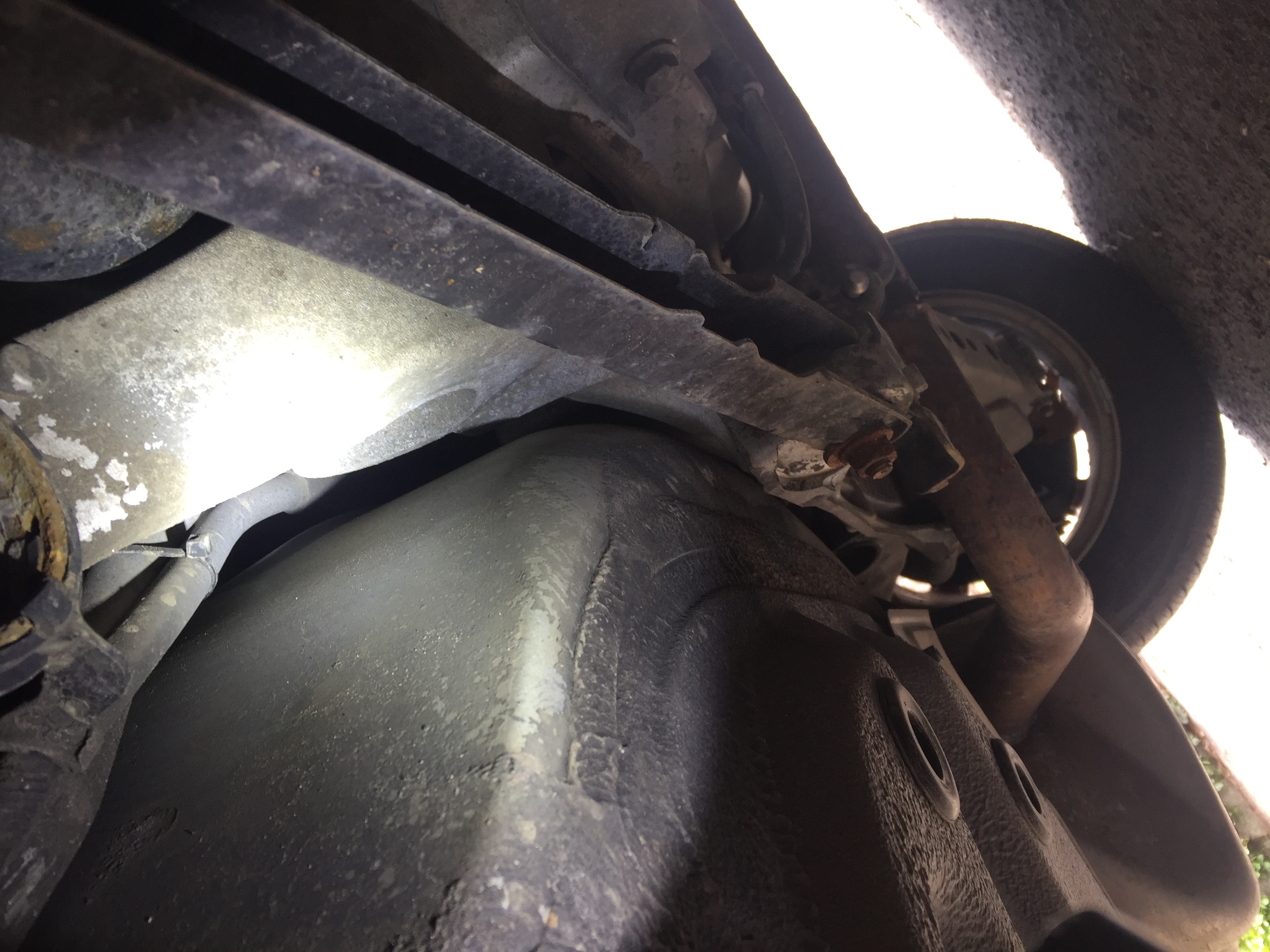

I bought a used PEM. Going to replace mine soon. Any tips on how to replace it on a metal fuel tank?

I already showed you the trick in my previous post above.alexv702003 wrote: 05 Apr 2018, 19:28 I bought a used PEM. Going to replace mine soon. Any tips on how to replace it on a metal fuel tank?
- Posts: 36149
Back right wheel up on a ramp.
7mm hex on a small 1/4 drive ratchet, undo the hex bolt until it comes off,then reach up and pull the metal spring , sort of stamped sheet metal version, off.
Ease the wiring from the metal clip,opening with small screwdriver helps
Then slide the PEM to the right, lift up and out.
Total, about 5 minutes
You can also search threads for part 8634953 and 30769225 for procedures and pics
I think the 30769225 is more inclusive

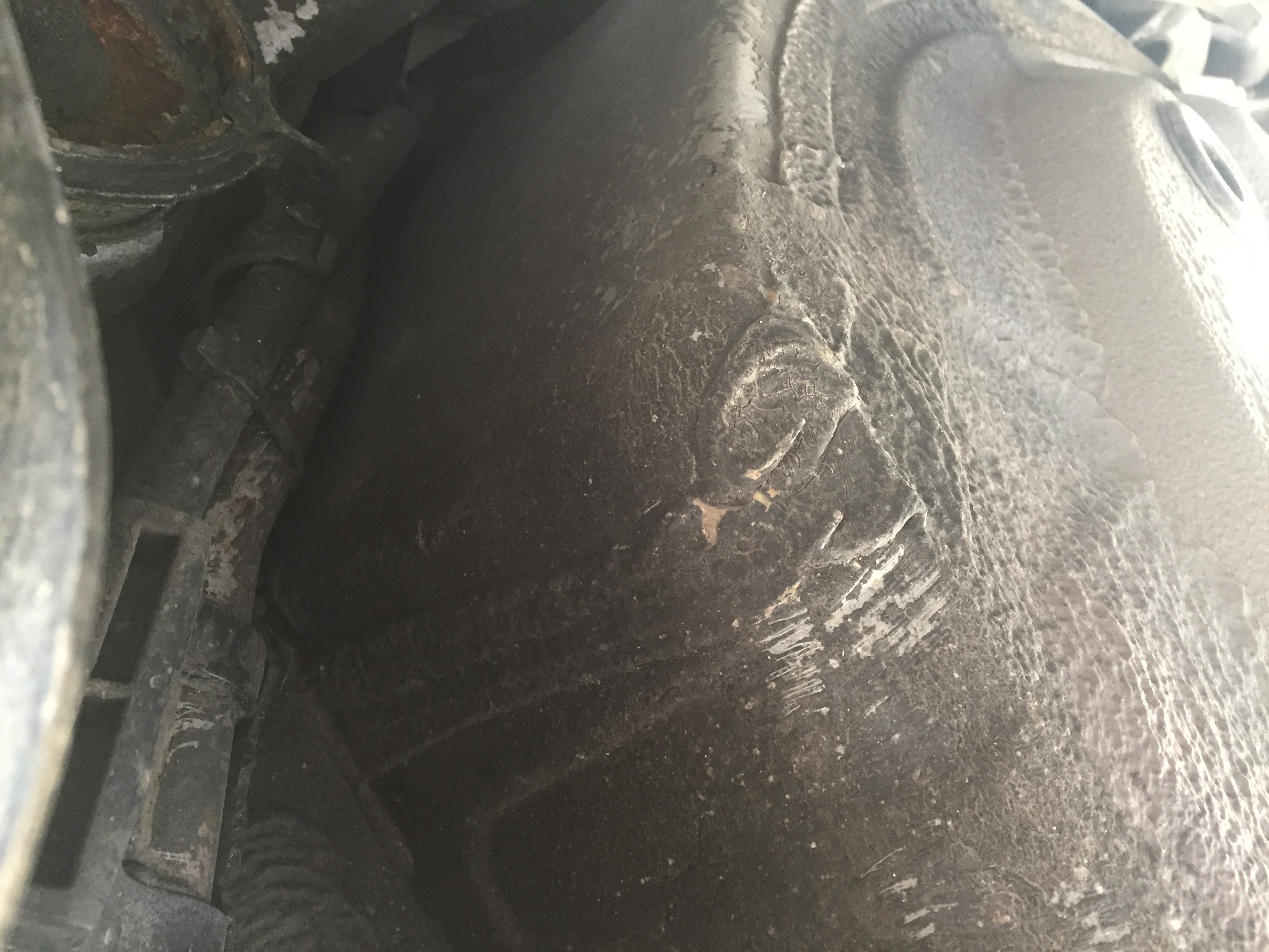

- You keep saying "metal fuel tank" in your posts, but looking at it, it does not look like "metal" to me.
- Also, post better photos (camera closer to the ground so it covers more area).
- Search forum for other locations: under REAR seat, trunk etc.
- Post back what you found.
- Posts: 36149
It is toward the rear of the tank, if its on the top.
