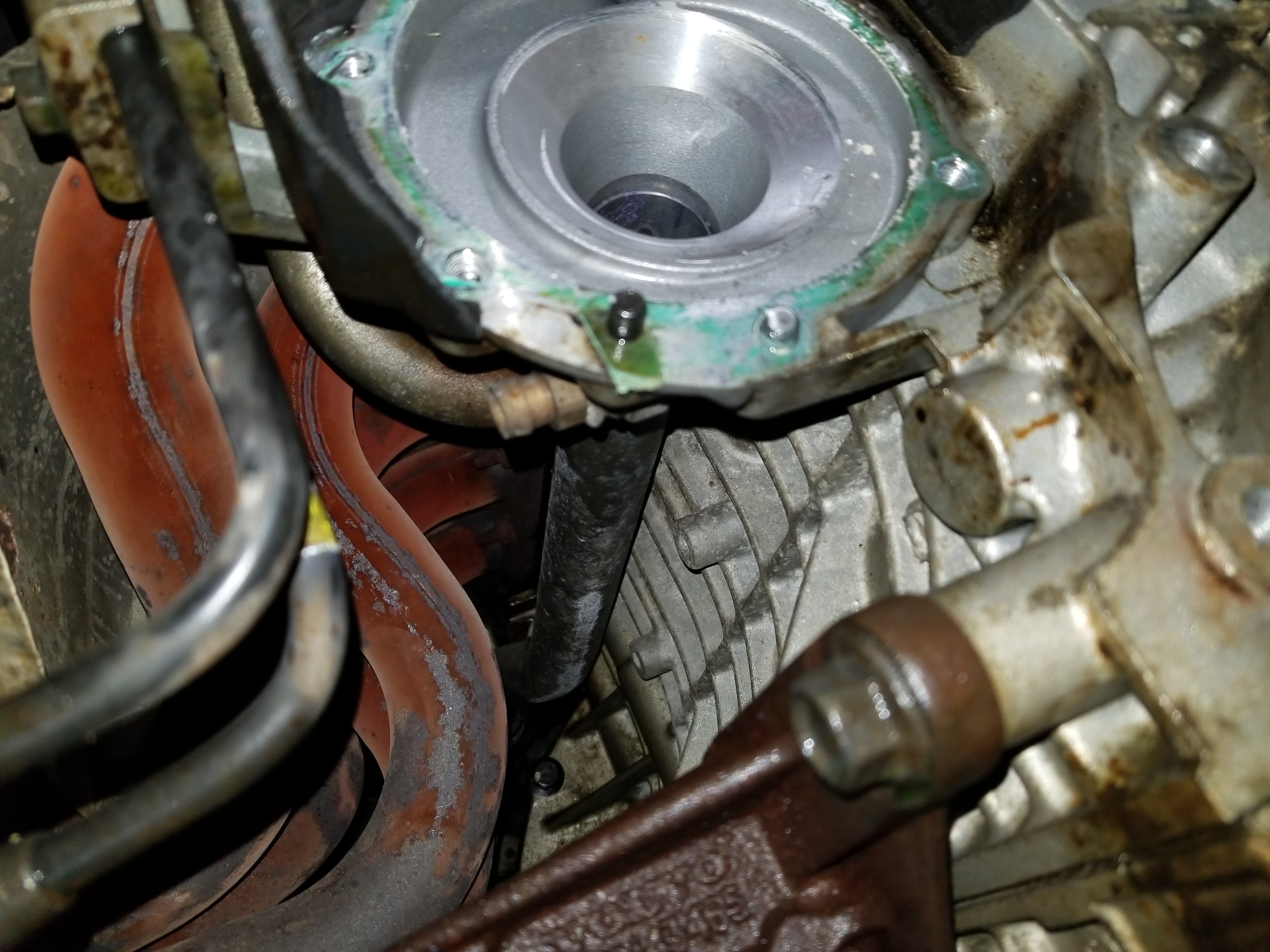

I think I would go with a bolt defect for this one. That bolt would not shear at 30 or even 60 foot pounds - I think it would strip the engine case first, too.

That's exactly what I thought.abscate wrote: 11 Feb 2019, 07:48 I think I would go with a bolt defect for this one. That bolt would not shear at 30 or even 60 foot pounds - I think it would strip the engine case first, too.

So leak was caused by a small amount of old gasket remaining... Looks like I should be able to get that broken bolt out too.

- Clean the mating surface with fine sand paper really well before installation.
- I add a bit of grease on the gasket (Volvo gasket only) to help hold it in place during installation.

Well.
So far so good.
Got the entire project completed. Didn't need as much coolant as I thought it would.
So far no leaking.
Took it for a 30 min drive, and still no leaks.
So I'm going to say it's "holding" hahahaha.

Just looking a little back at the snapped bolt, there is one reason for snapping that wasn't mentioned but that really kills a bolt very easily: an accidental smear of grease on threads - even just a slight amount from a dirty finger and it will lower the actual torque measure by a factor of 2 or 3 which would cause even a larger bolt to snap with very little effort at the handle. Perhaps little chance there was grease for a pump job, but worth being careful when handling bolts. Usually when unsure I like to clean my bolts with some acetone or even some Liquid Wrench (I believe it doesn't have lubricant in it, I hope I'm not wrong)

if you are able to get in there to drill, get a reverse pitch drill 1/8 and run the drill in reverse. center punch and often the biting of the drill walks the bolt out(better than further in) Besides snap-on Im not sure if avail. at Home Depot etc. or not.

I found that #0000 fine steel wool worked really well for me in removing the last bits of stubborn gasket material.

My timing marks were virtually gone so I had to make new marks to make sure that nothing moved. Looks like nothing moved mechanically. I'm actually pretty sure its going to be spark plugs. Its been about 30-40k miles since the last change. Also it was idling a little rough before the water pump and timing belt repair. Distributor, and wires were replaced at the same time. New coil pack about 10,000 miles ago. I was listening and it sounds like there is a small misfire. So new plugs first and then we'll go from there.oragex wrote: 12 Feb 2019, 01:46 Subaru sound sounds like an ignition coil issue/misfire, or a timing issue. www.youtube.com/watch?v=nDwtZCWU7u8

All the brands I used were from FCP euro's kit: https://www.fcpeuro.com/products/volvo- ... 252wp-oega
Funny thing, that aisin pump is most definitely a volvo pump with the word volvo ground off. I trust aisin, they make good products.
I think liquid wrench has a oss between teflon and ceramic in it to make it easier to pull bolts off.
Honestly I think I got a bad bolt. It happens.
I replaced the aisin/volvo waterpump gasket with a fel-pro one and it was actually a little thicker and sturder.
