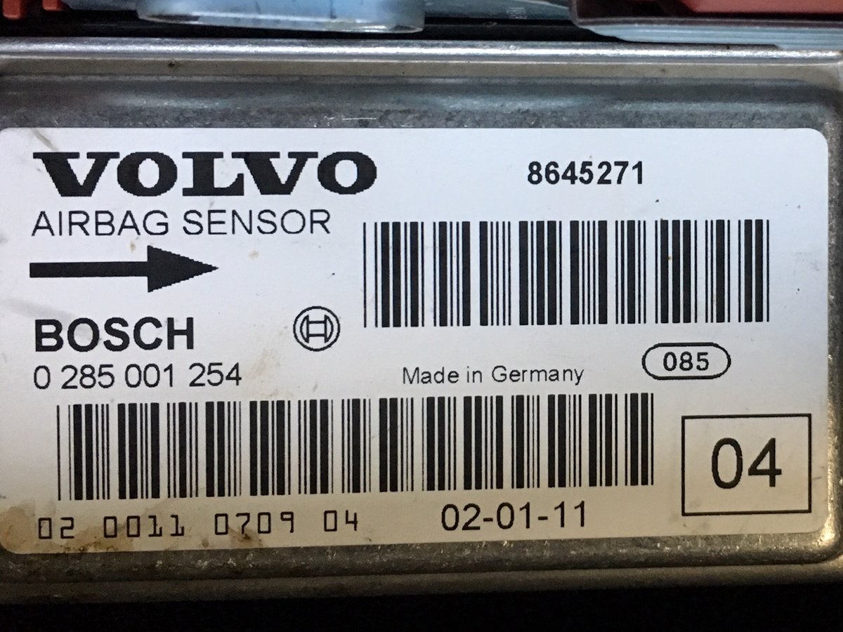

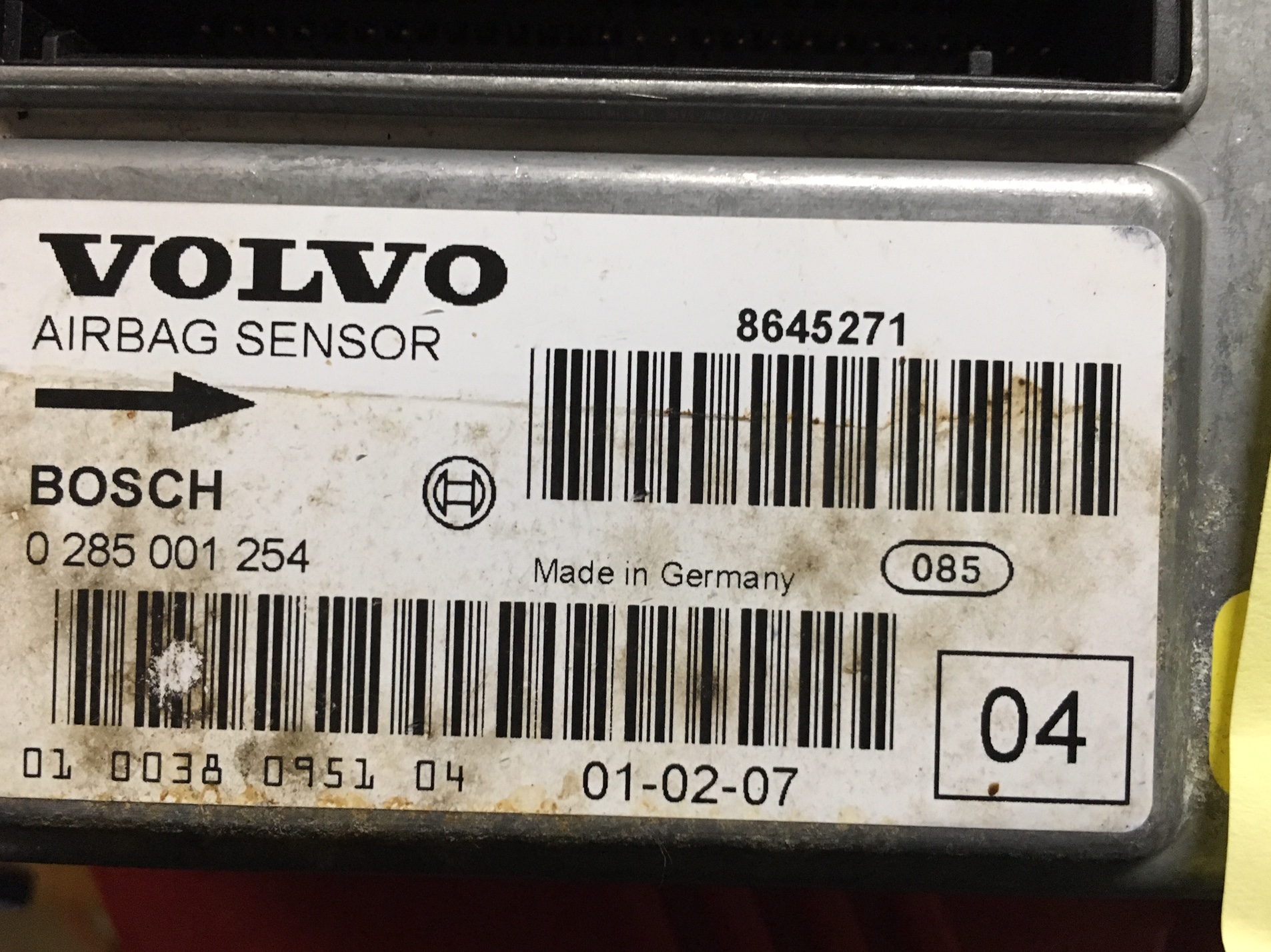

For Yagger: the two SRS Modules. Sorry to clutter up the forum with this. I'll delete them once they aren't needed. There does not appear to be a way to attach a file to a PM. If there is, please let me know.
First, the original and then the second module.

Just an update. I bought a good used 2002 SRS module, installed it, cleared codes, and it works like a champ! Thanks everyone who replied to the post! This has been a looong process of researching and learning!
