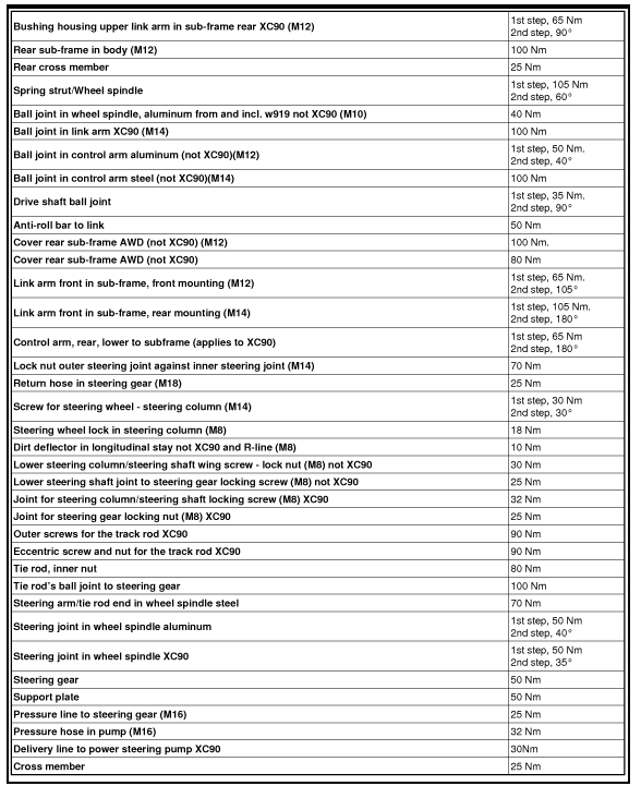

I also found 40 Nm for the ball joint. Are these 3 value correct? I'm finding differing opinions online.

There are variations for aluminum and steel control arm mounts, so you have to get your parts identified to get the right torque
That Autozone guide lists instructions for Volvos, 1999-2005, which span two very different front ends - thats not confidence inspiring.

Interesting. The parts i'm getting are mentioned earlier in the thread - all Lemforder aluminum LCAs and ball joints. I'll keep looking for the right torque specs.

I posted the sheet from all data above, but don't see control arm torque..

Thanks for your help. I guess i'll use 50 Nm, 40º for the ball joint as per all data, and 49/77 Nm, 90º for the control arm bolts as per autozone, and hope for the best.
