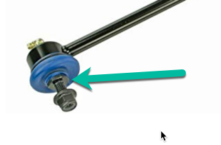

Here's a picture illustrating what we both mean. In this case it's more than just two flats.
Cone wrench would go where green arrow is pointing.
