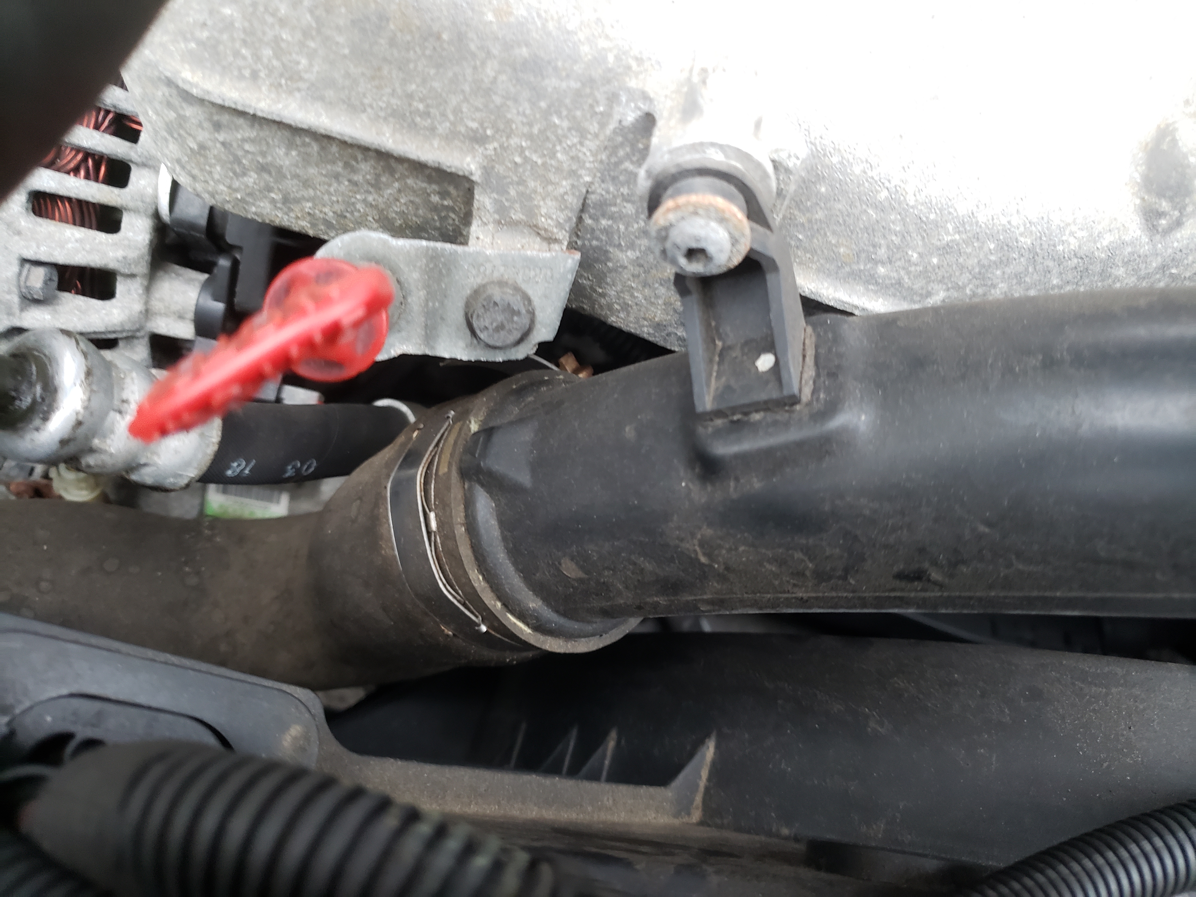

Was looking at the engine (haven't gotten the tools yet), and noticed that the turbo hose clamp at the front of the car had the screw facing the engine block.
How am I supposed to get a flathead in there?

Try a 7mm socket with 1/4" ratchet from underneath.
If you cannot reach the top hose clamp then you'll need to remove the bottom hose clamp off the intercooler. You'll need a 7mm socket with extensions or a long flat screwdriver to reach it.

Once you undo the two Torx screws holding the plastic over-engine tube, you should be able to pull the hose away from the engine and access the clamp screw. Might need to release the clamp at the back of the engine first.

+1EngineeringBloke wrote: 14 Apr 2019, 18:06 Once you undo the two Torx screws holding the plastic over-engine tube, you should be able to pull the hose away from the engine and access the clamp screw. Might need to release the clamp at the back of the engine first.
Try this first by removing the torx bolts then bending the hose.
I replaced those torx bolts with allen headed bolts. Easier to get an angled allen wrench than torx bit on that front mounting bolt.
