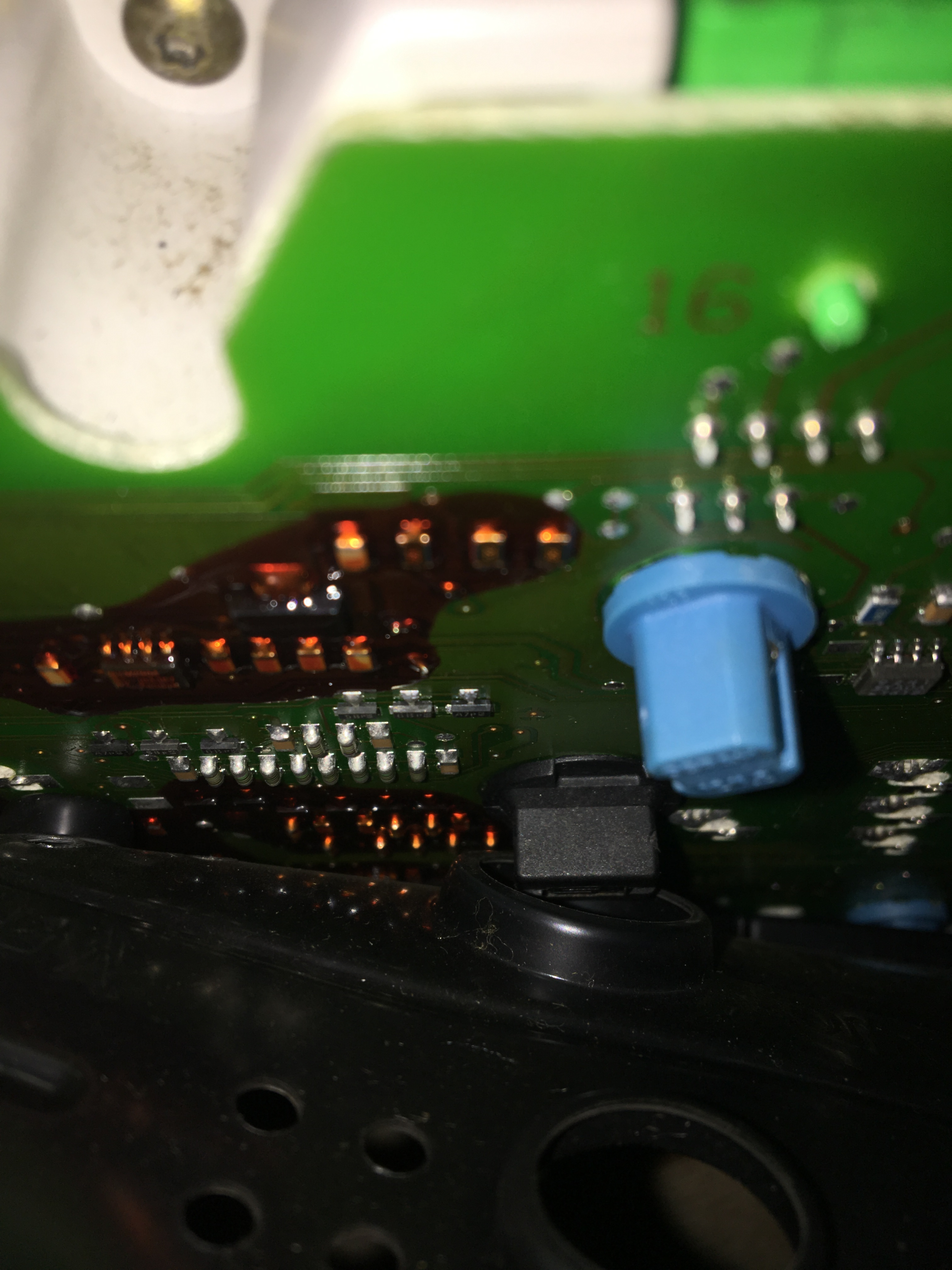

I’m honestly not sure what this stuff is, but am I wrong in thinking that the best idea may be to just find another cluster? LolEddystone wrote: 27 Sep 2019, 21:30 I have a 1993 940 that had a wonky fuel gauge that was intermittent, and things went downhill from there. I pulled the instrument cluster and resoldered (heated and added a bit of new electronics solder) all of the connections. Everything started working again. The heat/cool cycle and hidden corrosion (tarnish, really) eventually cause cracks and make solder joints that look good actually non-conductive. For anyone with electronics experience, this whole job takes about 15 minutes.
The caramel color might be electrolytic capacitors that have leaked and failed. These capacitors look like little cylinders. Generally speaking (all applications) they often fail simply due to age.
Your problem may be due to something completely different.

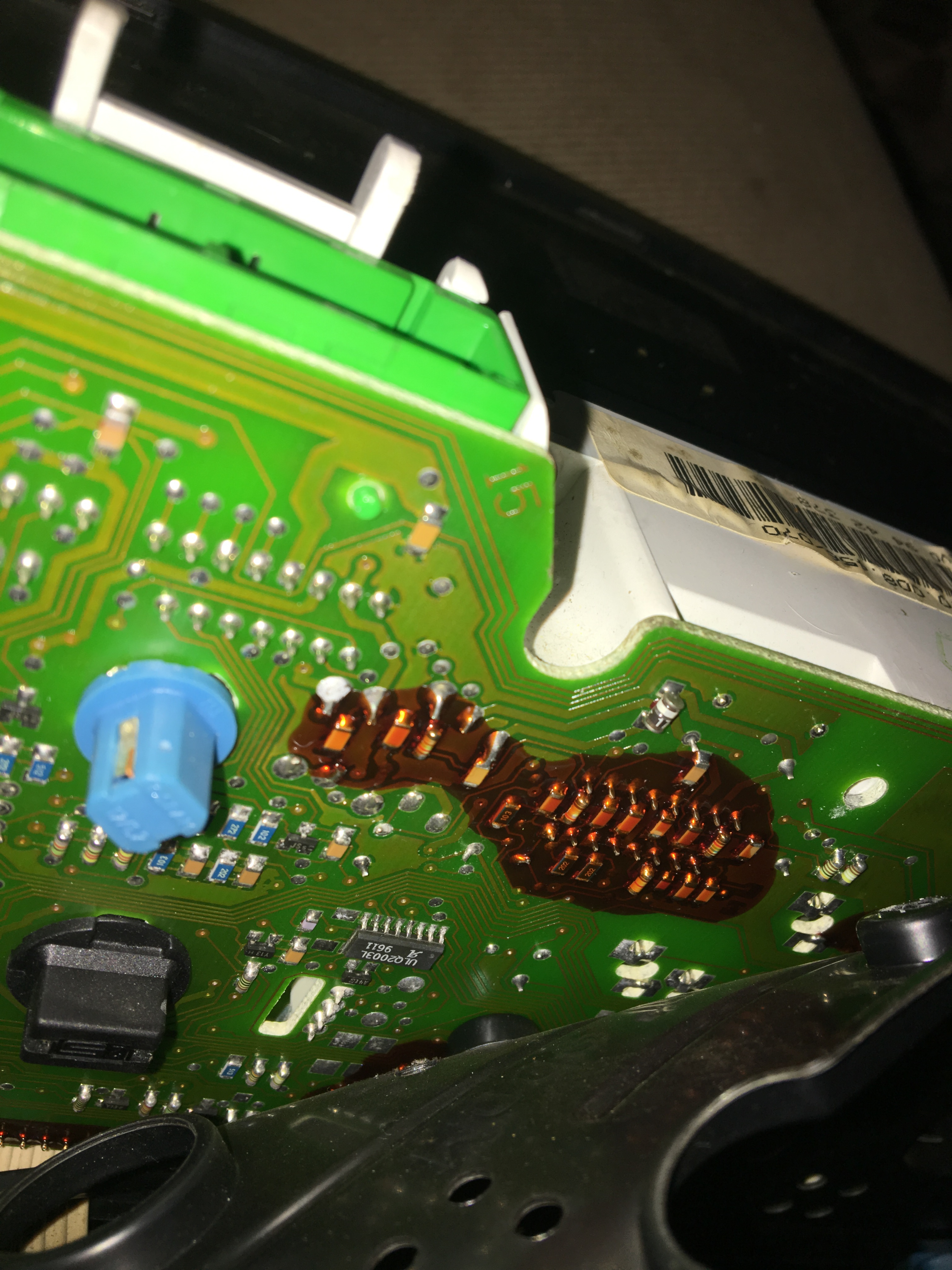

That looks a factory applied conformal coating.
If you take a closer look, it’s been used around
surface mounted capacitors and resistors.
It’s used as protective layer.

That’s odd, I’ve looked at pictures of other 850 clusters and didn’t see the same coating. But if it’s intentional, then that’s good I suppose.BEJinFbk wrote: 28 Sep 2019, 11:01 That looks a factory applied conformal coating.
of the surface mounted capacitors and resistors

It is definitely applied during manufacturing. Seen it plenty of times over the years. Not seeing it on others might be due to the rolling changes often made during production. Such as, it's been discovered these sections need corrosion protection.

Okay I gotcha. Thanks for clearing that up. Not too sure if I should still try buying another cluster or not though, I don’t believe it to be the wiring harnesses, and I don’t believe it to be the ABS because usually it’s just the speedo and tach that die if that’s the case from what I’ve read, and Ive tried jiggling the key in all sorts of ways, so I don’t believe it to be the ignition switch eitherMRScott wrote: 28 Sep 2019, 11:33 It is definitely applied during manufacturing. Seen it plenty of times over the years. Not seeing it on others might be due to the rolling changes often made during production. Such as, it's been discovered these sections need corrosion protection.
