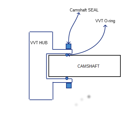

2. Second link is a thread and "jordank" and I discussed the engineering aspect of the VVT. NOTE:
a. The cam seal is the seal preventing oil from leaking to the outside world.
See photo sketch by "jordank".
b. The VVT O-ring is there to keep oil pressurized for advance/retard functioning. So if the O-ring is bad, the VVT cannot activate the solenoid.
Also note that with mileage, the gear mesh inside the VVT gets loose, thus the play which you cannot fix.

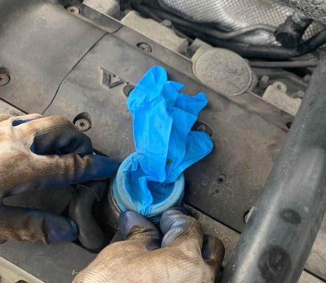

I did the glove test and seems like PCV is not problem. I am getting good suction with the glove. See the picture below.

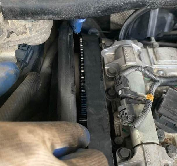

I did notice that the timing belt was not riding in the center of the gear. It was toward the right edge. Not sure if this indicates anything. See picture below. It's kind of hard to tell if there any play in it with the belt on. I will remove the accessory belt and timing belt and report back.

Post by cn90 »
Part of the TB is missing.
Pls see my post previously, this is why I recommend the whole thing (TB kit, Aisin WP, cam seals, new VVT hubs)...

cn90 wrote: 02 Nov 2019, 20:59 Part of the TB is missing.
Hi,
I did put a timing belt kit in two years ago and I noticed it was odd that the timing belt on the exhaust side was off like what you see in the picture. I will take out all of the belts and see if there is any play in the VVT gear. Its probably bad.

Post by Achilles »
