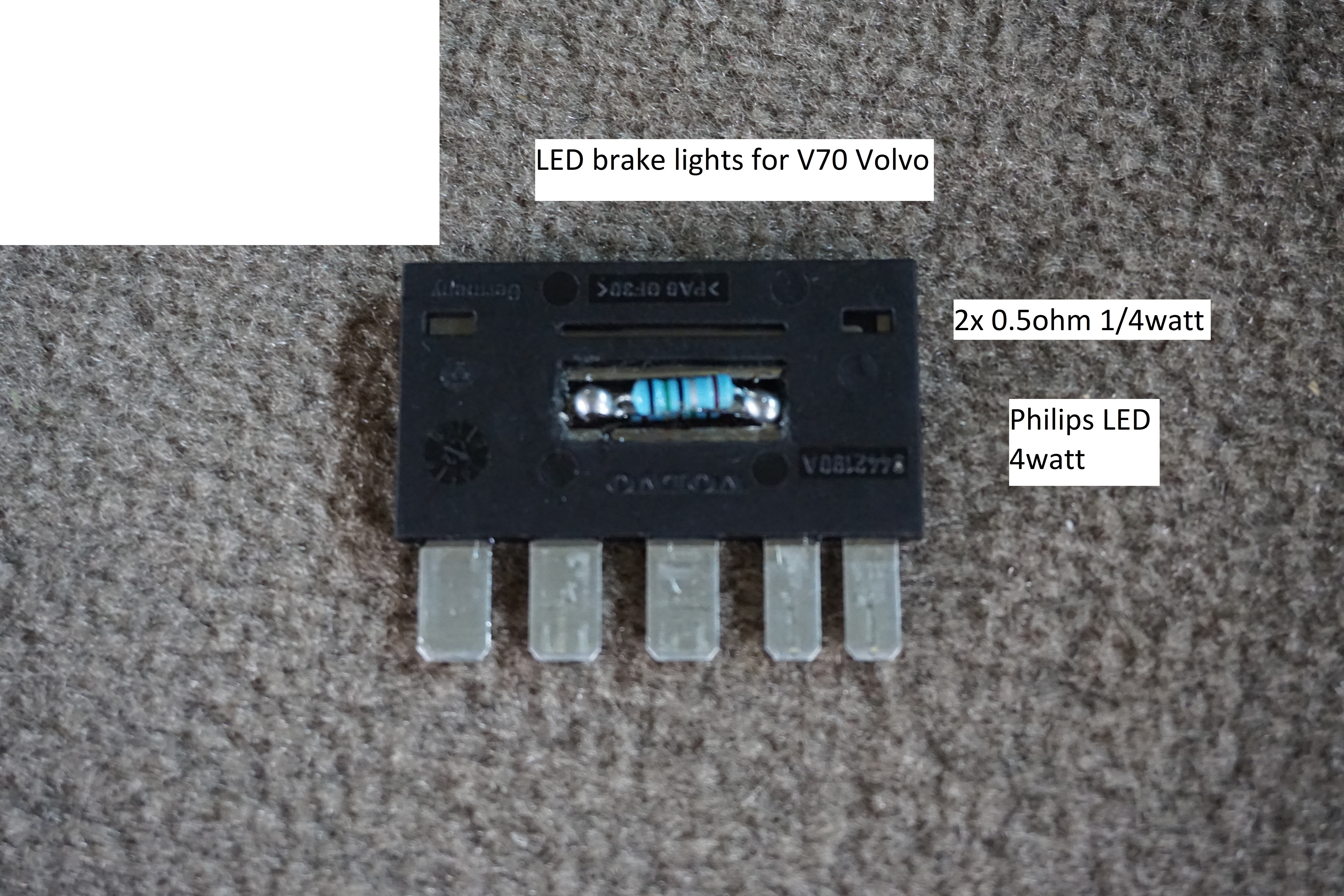

thats cool but for tail lights dont use a load resistor for canbus it defeats the purpose of using LEDs. I used the shunt mod added a small 1/4 watt resitance to the shunt (no heat) and uses a fraction of the current of a incandesant. This method works for all lights exept indicator/turn lights
