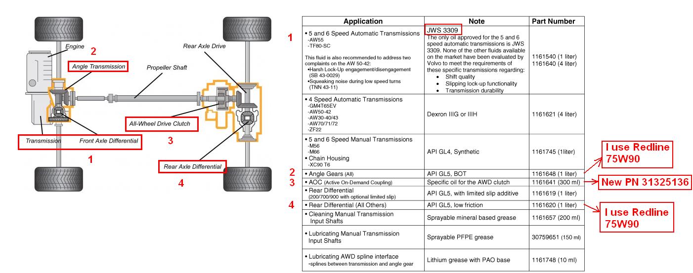

No the 2.9 had a chain drive transfer case, the 2.5 has an angle gear.
So from some images and research and quote me if i am wrong. The angle gear is bolted to the side of the transmission and the Haldex AWD system is the rear diff and basically the angle gear is connected to the drive shaft that sends the power down to the Haldex system for the rear diff and the engine is mounted with the transmission side ways in the engine bay because the 2.5T was originally FWD and AWD was a optional extra.Masscomguru wrote: 13 May 2020, 07:14 No the 2.9 had a chain drive transfer case, the 2.5 has an angle gear.
2.9T has the engine in side ways as well in the engine bay but the transmission replaces the angle gear that is used on the 5 speed. the drive shaft is connected into the transmission of the 2.9T and then sends the power down to the AWD system which is a chain driven system that sends power to both the rear and the front instead of the front being attached to the transmission.

If I recall you are missing a part. There are three fluids up front so three different parts: transmission, angle gear/transfer case, chain drive system. Chain drive is on the far outside and then the angle gear/transfer case.
https://www.volvopartswebstore.com/show ... ct=1184103
