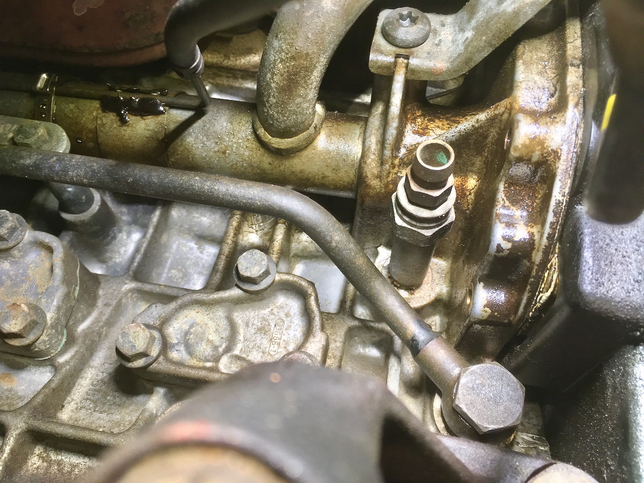

I can't tell from the pic, can you rule out the "oil squirter cover" to the aft?

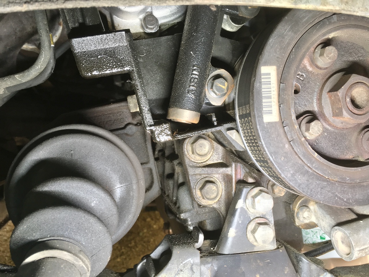

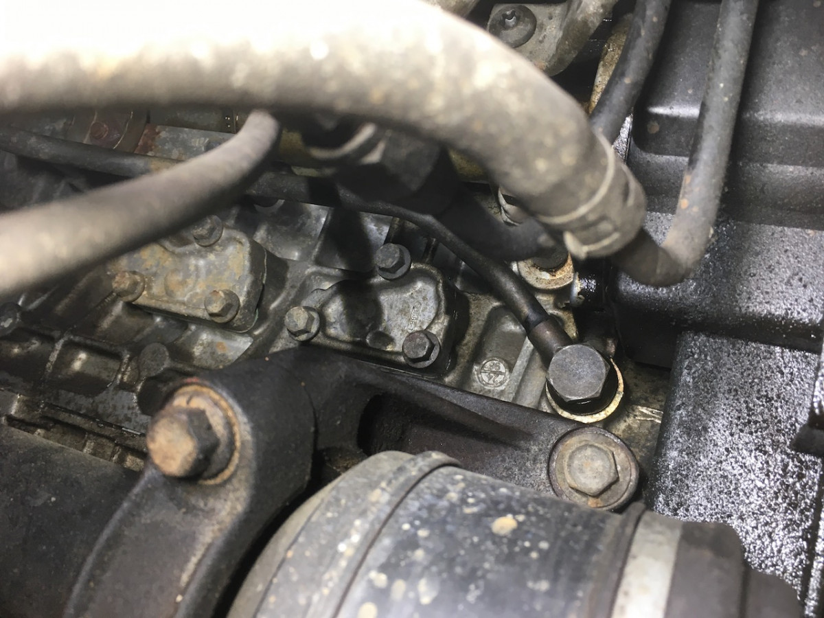

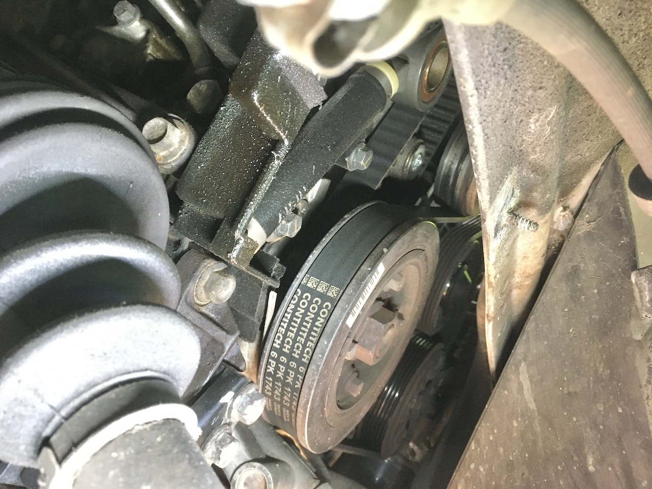

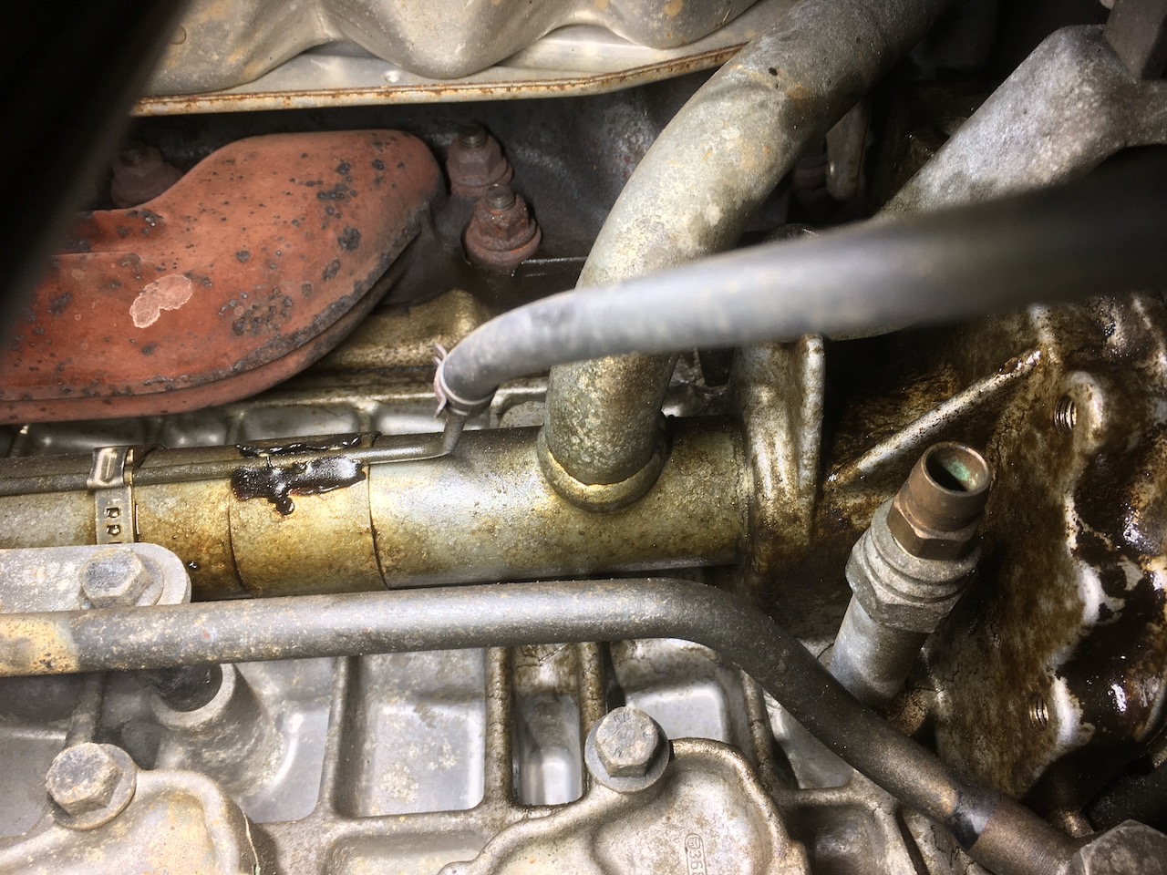

I got into the area again today to inspect it some more. I don't see oil residue around the turbo oil line or in the oil pump area behind the crankshaft. What is the oil squirter cover? Did I get it in one of these pictures? Thanks again for the help and advice!

These covers. They will occasionally leak, but I don't think it looks to be coming from there.

Great pics. I agree it's not the cover gaskets. Looks to be from higher up.

Looks like cam seals failed. They leak down behind the plastic cover behind the timing belt.
- Posts: 36138
- Been thanked: 4064 times
Classic cam seal leak.

This definitely looks like a cam seal leak, but if they're dry, they're dry.

Dry or wet, unless jreed removes inner tb cover, hunt is on.
