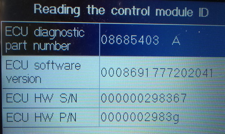

The scanner shows this for the BCM ID
- 1.jpg (188.43 KiB) Viewed 651 times

It is original BCM on your car. Basis on my experience, if you have internal fault errors in this module, easiest way to replace it. Some people ask us to fix it, but it is more expensive and I think not so efficiently.. If I get same problem on my own car I choose replacement module. In worsest case need to reprogram replacement BCM.
You can get prices from opened sources ))
For example:
re-manufactured BCM cost ~$550 + (Shipping cost)$40 = $590
BCM repair service cost - ~$500 + (Shipping cost)$40 = $540
If you get BCM from ebay (like example) and get online data transferring service, you can get lower cost for everything (~$170 - $180). No shipping, no problems with adaptation, no worries... Yes, there is insignificant risk to buy used BCM with some issue, but in my practice, I never get this cases yet. )

Appreciate the information, I will look at the junkyard. I'm also curious what causes these issues so if time permits, that would be material for perhaps a new video. Cheers.
