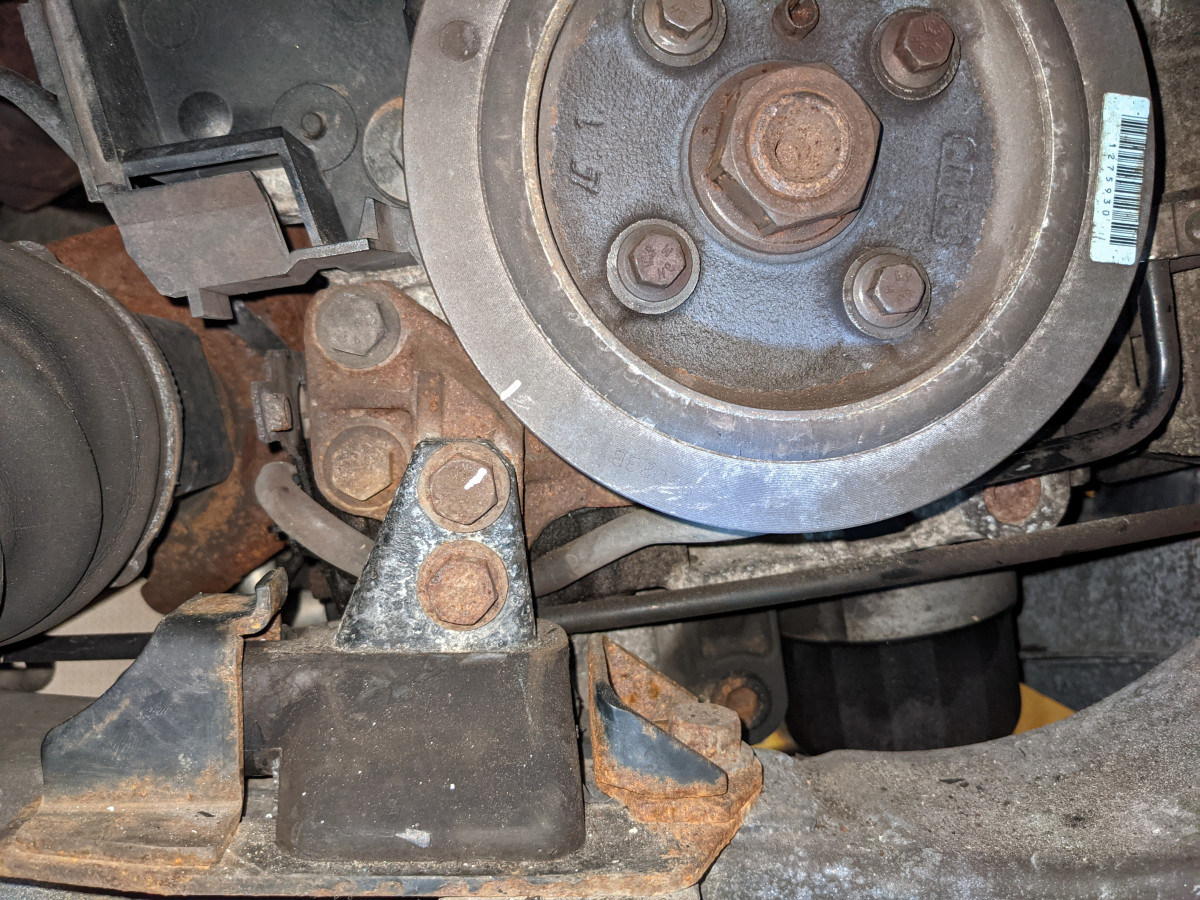

Where can I look to see evidence of the grinding? How bad does this engine mount under the crank shaft look? If I replace the engine/torque mounts, might I be ok to not replace the axle and/or its bearing anchorage?

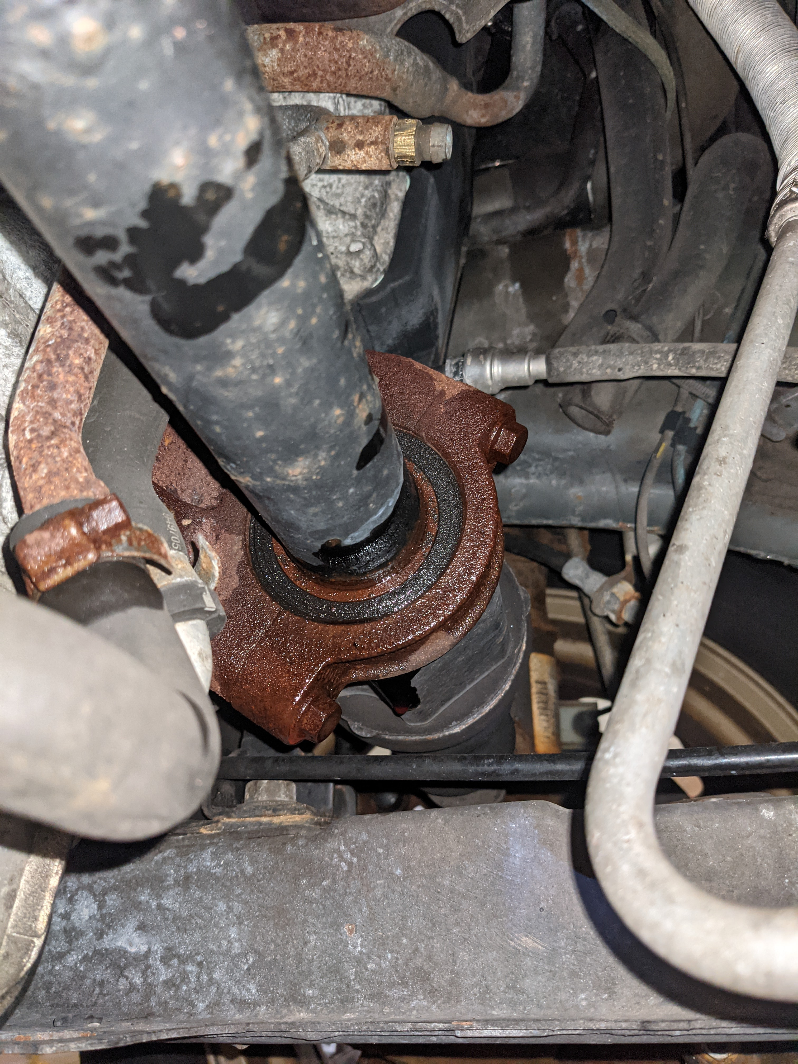

The mount looks fine , the drive shaft carrier bearing is pretty rusty
Can you spray some pb blaster on both sides and see if it changes the noise ?

Abscate beat me to it. Do what he suggests and see if it makes a difference. The bearing is supposed to be sealed but it is not 100% effective. However, if the bearing has gone dry then it will get really noisy.
If the engine mounts are broken it will put additional load on this bearing as it is mounted to the engine. Replace any broken mounts and oil the bearing to see if that improves the noise level. If it reduces the noise noticeably, it does not mean it is fixed the bearing will still have to be replaced.
Is the mount actually broken under the crank pulley? If you are not sure, place a floor jack with a piece of wood between it and the oil pan and gently raise the engine near the mount and see if there is any separation between the rubber part and metal portion.

You don't need the mount. All it is is a means to support the bearing. Yours should be able to cleaned up easily.
The bearing is supported inside this support.
The axle does not need to be replaced either. The bearing itself can be replaced. If I recall the bearing is still listed under the 850 but for some reason not for the V/S/C 70. Same bearing. I did find one from a ford transit van in Turkey that has the same spec. The only difference was it was slightly chamfered on one of the outer race surfaces but that is not an issue.
My local dealer managed to remove the bearing for me, but others have removed it with a cold chisel. I ref0tted the bearing using a piece of steel fence pole which was the right diameter. Bearing is not cheap from Volvo. I think I paid $150 for it.

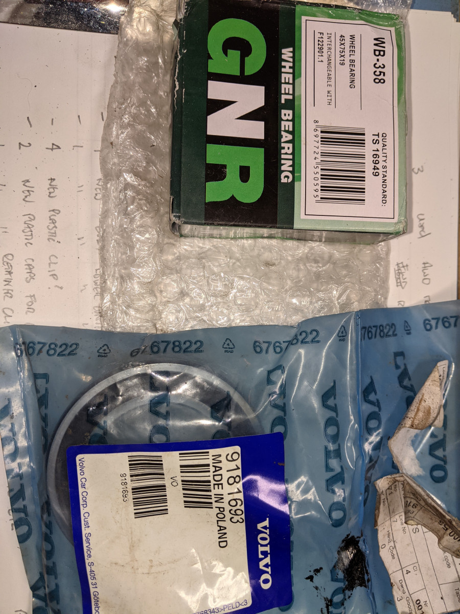

Just a quick follow up. Thought I had lost these during the move, but found today in an unmarked box!
These are both center bearings for the RH front axle on a P80 (in-case you have an AWD).
Center RH axle support bearing
RH bearing is Volvo OE. Not listed separately for a 98-00 V/S/C70. Part # 9181693 was listed for an 850.
LH bearing is a European bearing (Dutch made I believe) which was listed for a Ford Transit van. Bought in Turkey for about $10 US including shipping! I bought 2 and one has been running in a V70 for the last 3+ years and about 20,000 miles.
Dimensions for the bearing are on the aftermarket box in millimeters 45 x 75 x 19 (ID x OD x Width).

Suggestion. Crack and remove the two m8 12 mm hex bolts on the carrier, then articulate the axle out. Now try spinning the bearing by fingers feeling smoothness and listening for noise.
