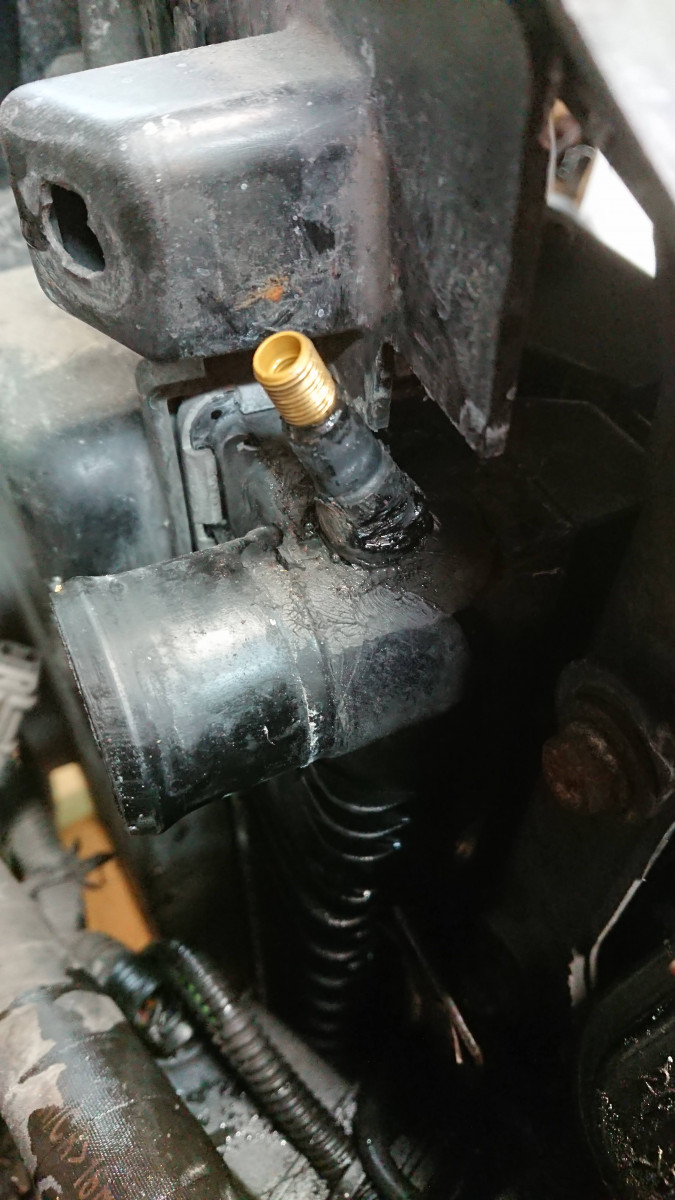

I replaced the radiator yesterday and found something rather unusual. I have to say the PO got really creative. I am a little surprised it lasted this long since I have been driving the car for 2 years now, and who knows how long this was installed before I bought it.

Is that a brass barb , JB welded into the hole on the radiator?

No, it's a regular tire valve. Actual valve part removed.
