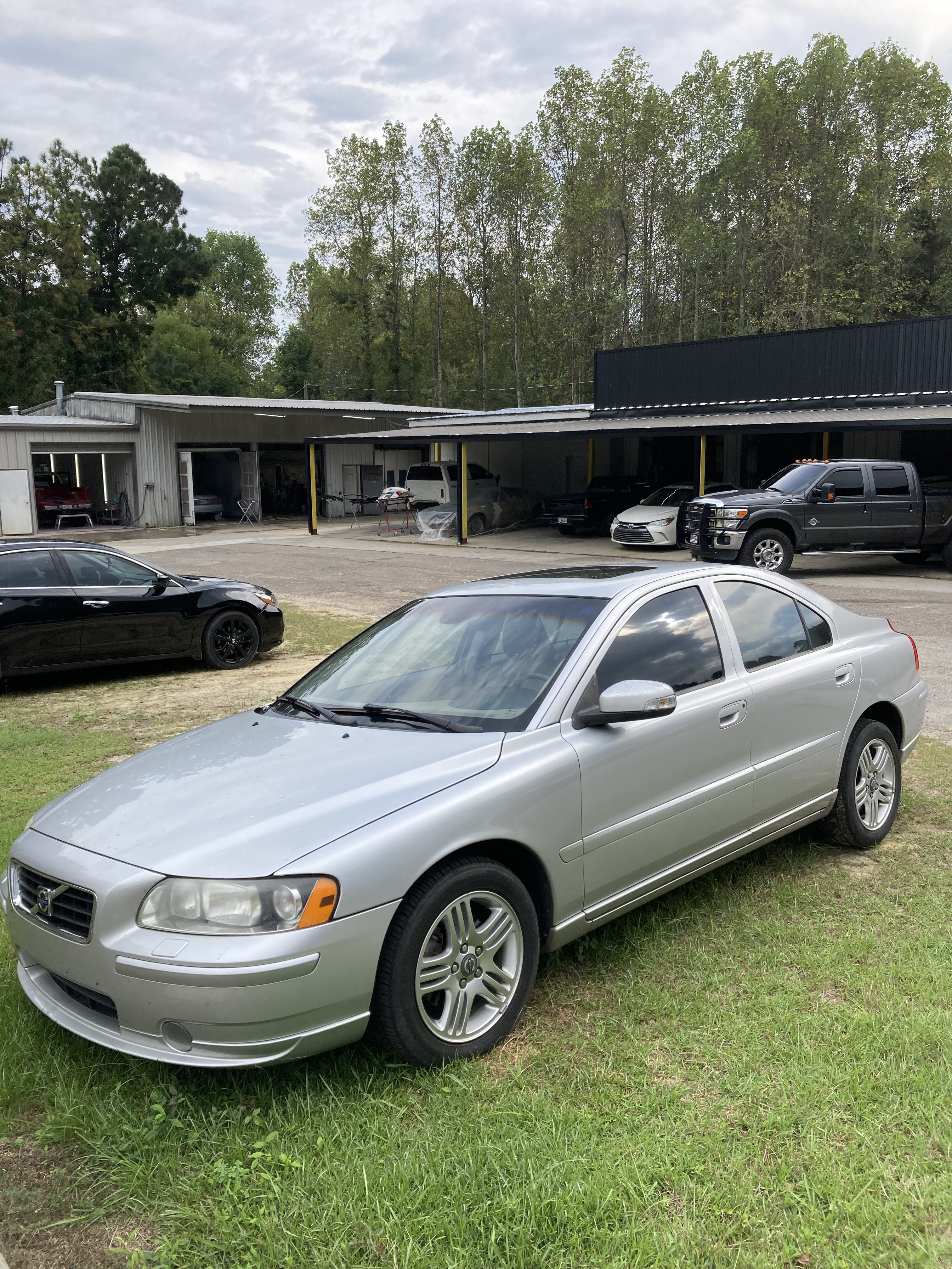

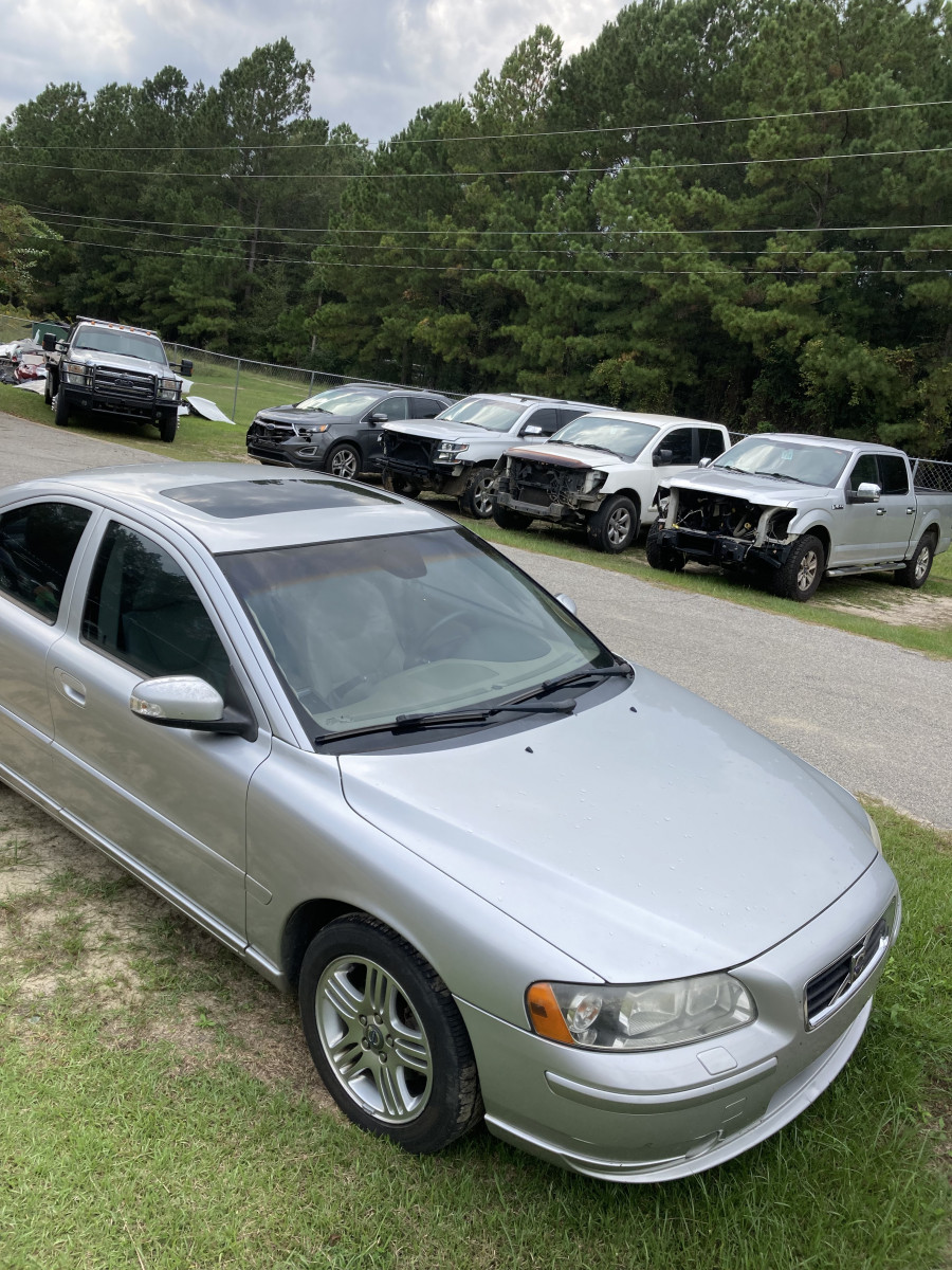

Here are some pics of said car. Has been really well maintained (with the exception of water pump failure) and the cleanliness of the car speaks for itself. What do you guys think it’s worth as is?

It’s a $500-700 project at best. It’s beyond economical repair for a driver, so you really market will only be scrap or someone who can take it in with the head swap knowledge.
Once its a non runner, its value is destroyed by the fact that you cannot assess all the other drivetrain components so the buyer has to take all those potential costs into account.
