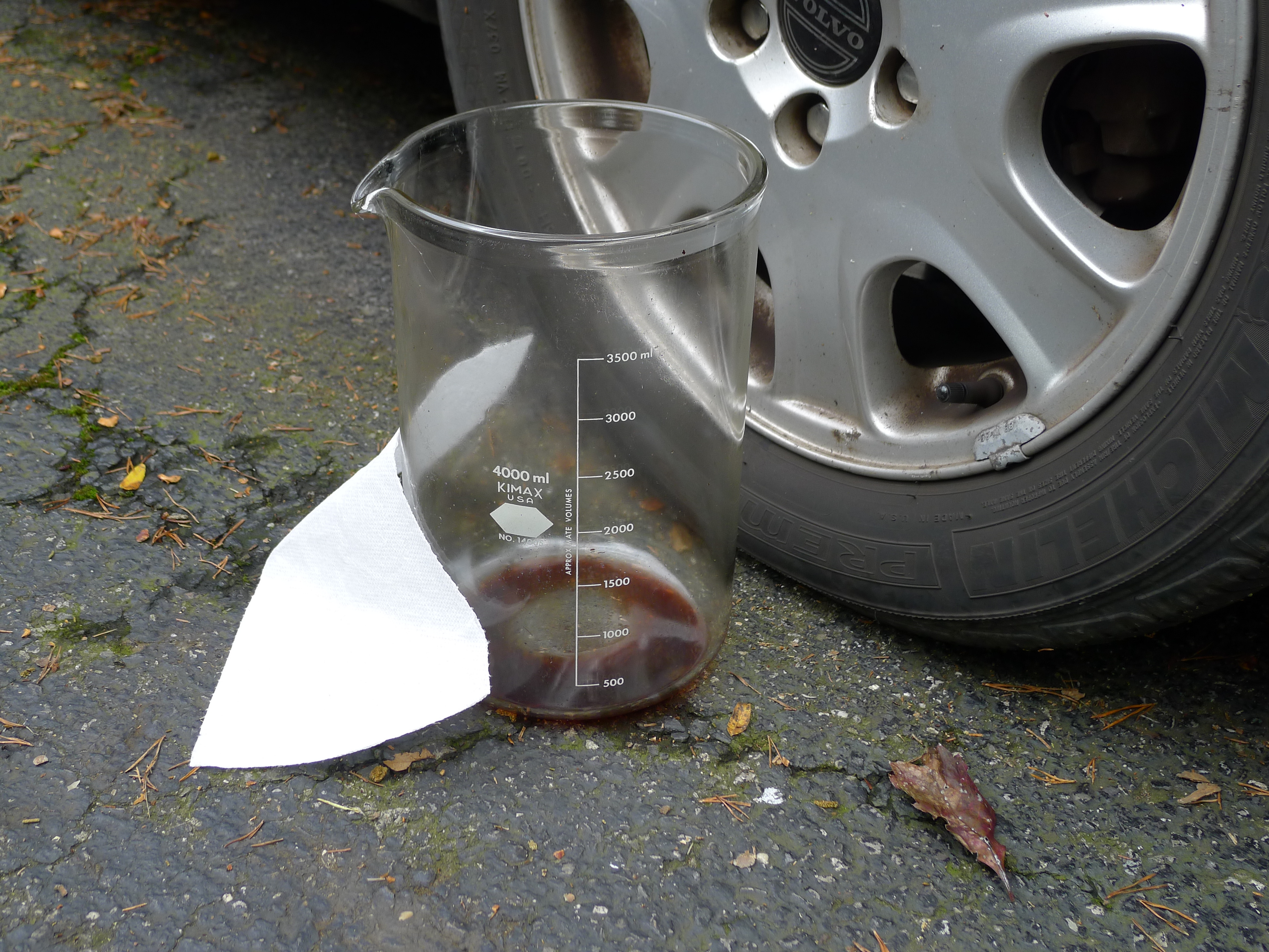

I use this laboratory gadget. I can't believe I didn't break it yet!
Also, to get an accurate reading, you should let the drained oil to cool down to 60 deg F.
But I get a good ballpark of what came out.

Made in USA, scale is in milliliters (1/1000th of 1.057 quart), "Approximate volumes" - America does not believe in metric system =)
