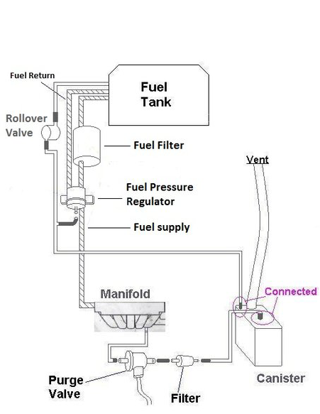

Here is a diagram showing the location of the roll over valve on the vent line running to the charcoal cannister in the fender area and from there to the purge valve near the radiator.

Darn, this looks a lot more complicated than I thought with many more possible places for leaks. Yikes!
I do never-the-less appreciate the diagram as it makes it much clearer how this works. One that may not be fun is a pipe to the fuel pump.
