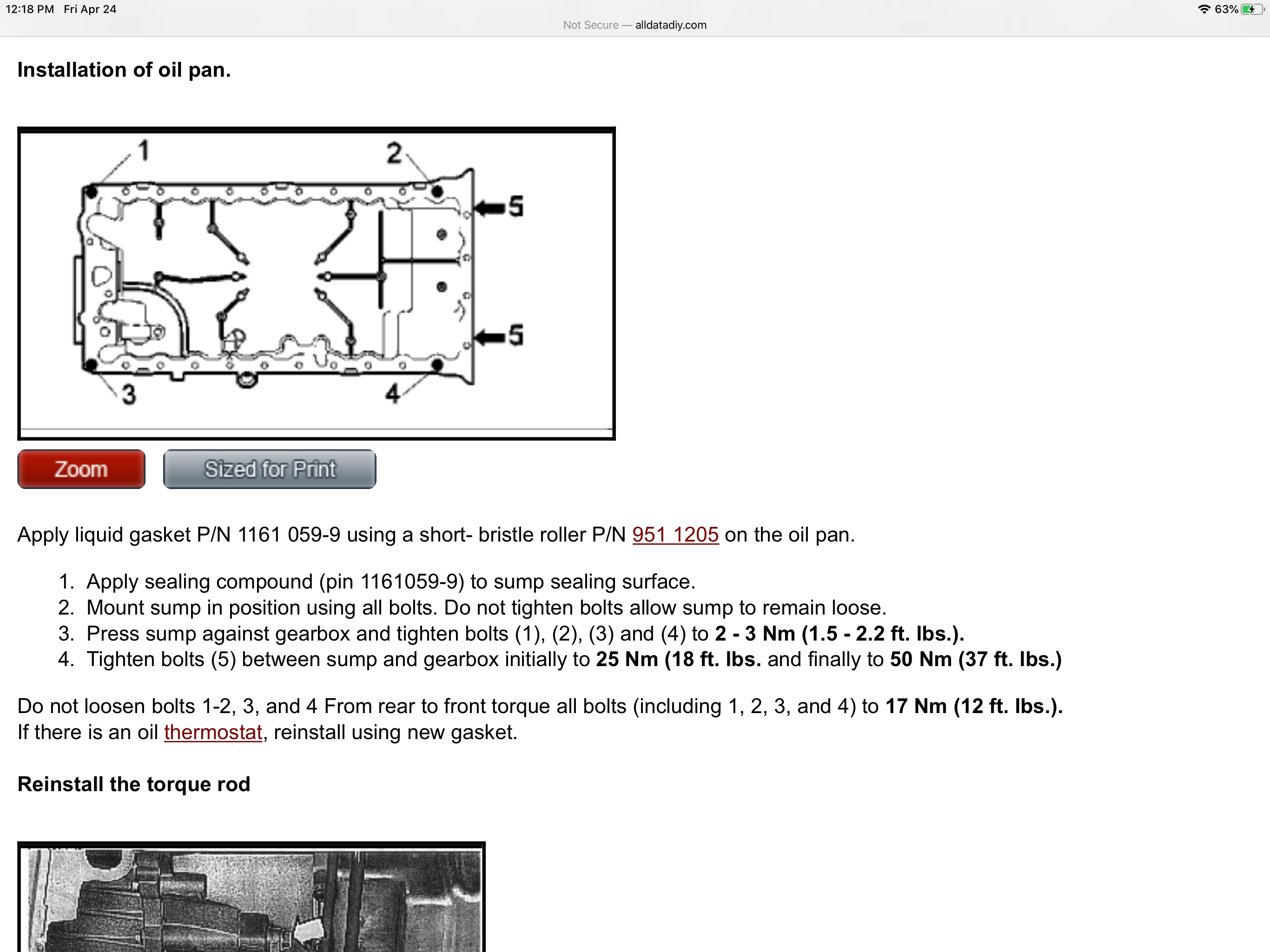

I didn't see notes for the bolt tightening and my Haynes manual doesn't list the oil pan, should I go inside out like on the same seal cover? Or star pattern like for wheels?xHeart wrote: 24 Apr 2020, 05:41The oil pan and transmission DO NOT exchange fluids therefore no sealant is used or needed between the two. But follow the steps of bolt tightening, including the 2 between transmission and oil pan, for a leak proof assembly.smacknab wrote: 23 Apr 2020, 13:44 Anyone know if the process is the same for a m56 transmission? The mating of the oil pan and transmission makes me worry a bit that I don't have the right seals etc

Check on pan alignment every step - till torqued. NO NEED TO RUSHsmacknab wrote: 24 Apr 2020, 07:30I didn't see notes for the bolt tightening and my Haynes manual doesn't list the oil pan, should I go inside out like on the same seal cover? Or star pattern like for wheels?xHeart wrote: 24 Apr 2020, 05:41The oil pan and transmission DO NOT exchange fluids therefore no sealant is used or needed between the two. But follow the steps of bolt tightening, including the 2 between transmission and oil pan, for a leak proof assembly.smacknab wrote: 23 Apr 2020, 13:44 Anyone know if the process is the same for a m56 transmission? The mating of the oil pan and transmission makes me worry a bit that I don't have the right seals etc
- Install the four corner bolts at the pan first, finger tight.
- Then the side bolts transmission to oil pan, check alignment and toque these 25Nm.
- Now install all pan bolts, finger tight first, then snug tight to 3Nm.
- TORQUE transmission to oil pan bolt 48Nm (check spec)
- Work pan bolts in pairs starting from the transmission edge - DO NOT TORQUE
- Initial torque pan bolts in pairs to 10Nm starting from transmission edge
- TORQUE pan bolts in pairs to 17Nm (check spec) starting from transmission edge
Hairline alignment shift is OK, you should see some sealant around the pan's mating edge.
If you are reusing the bolts, then, thoroughly clean the threads before installing bolts.

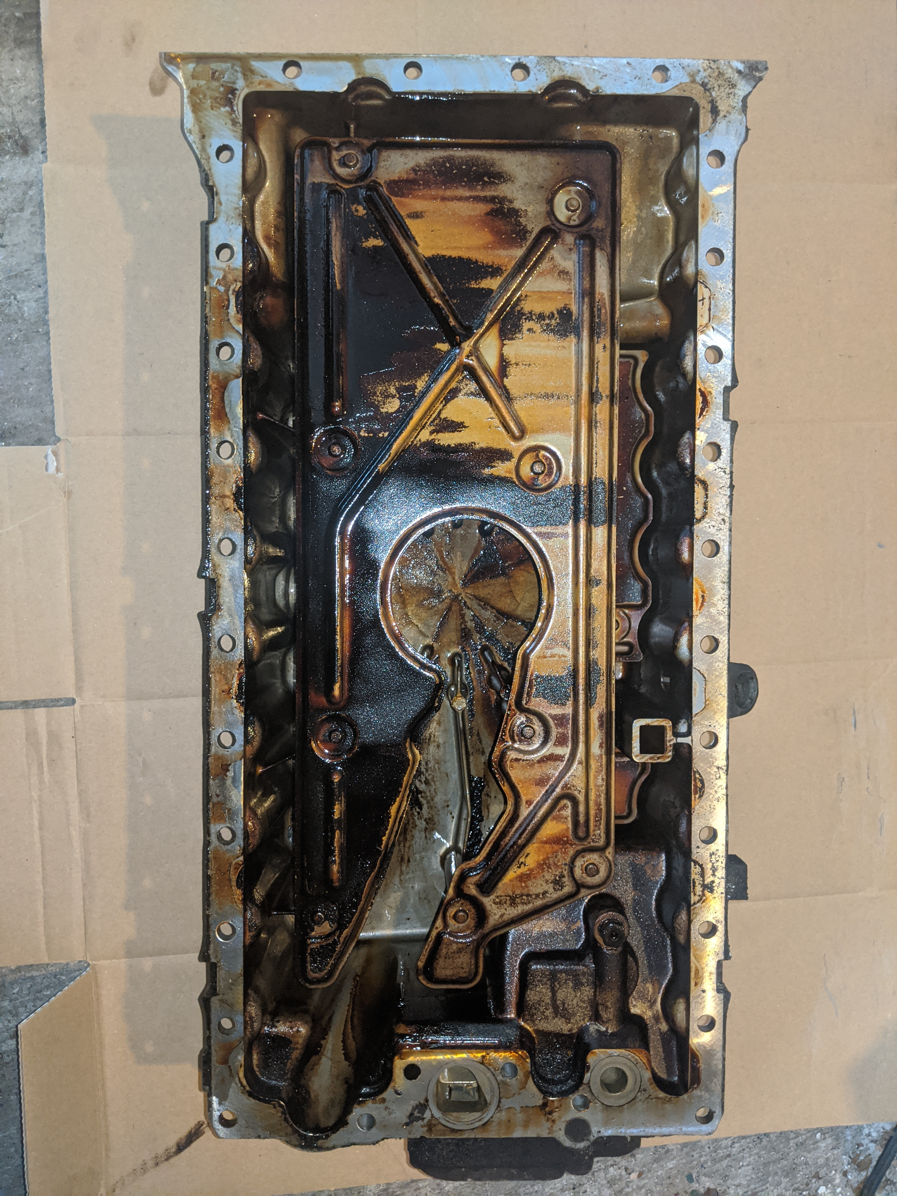

Thanks for the tips guys, just got the pan out. The bolt pattern tips are super helpful.
Do people normally clean the bottom of the block while it's open?
This is my pan, working on cleaning this now
07 V50 T5 AWD M66 ~146k miles
- Posts: 36147
Soak in Simple green and hot water.

Second the simple green. I soaked mine like that for a couple hours, then scrubbed the crap out of it til it was as clean as I could get it. Looks like that car has used some conventional oil under severe or longer intervals.
