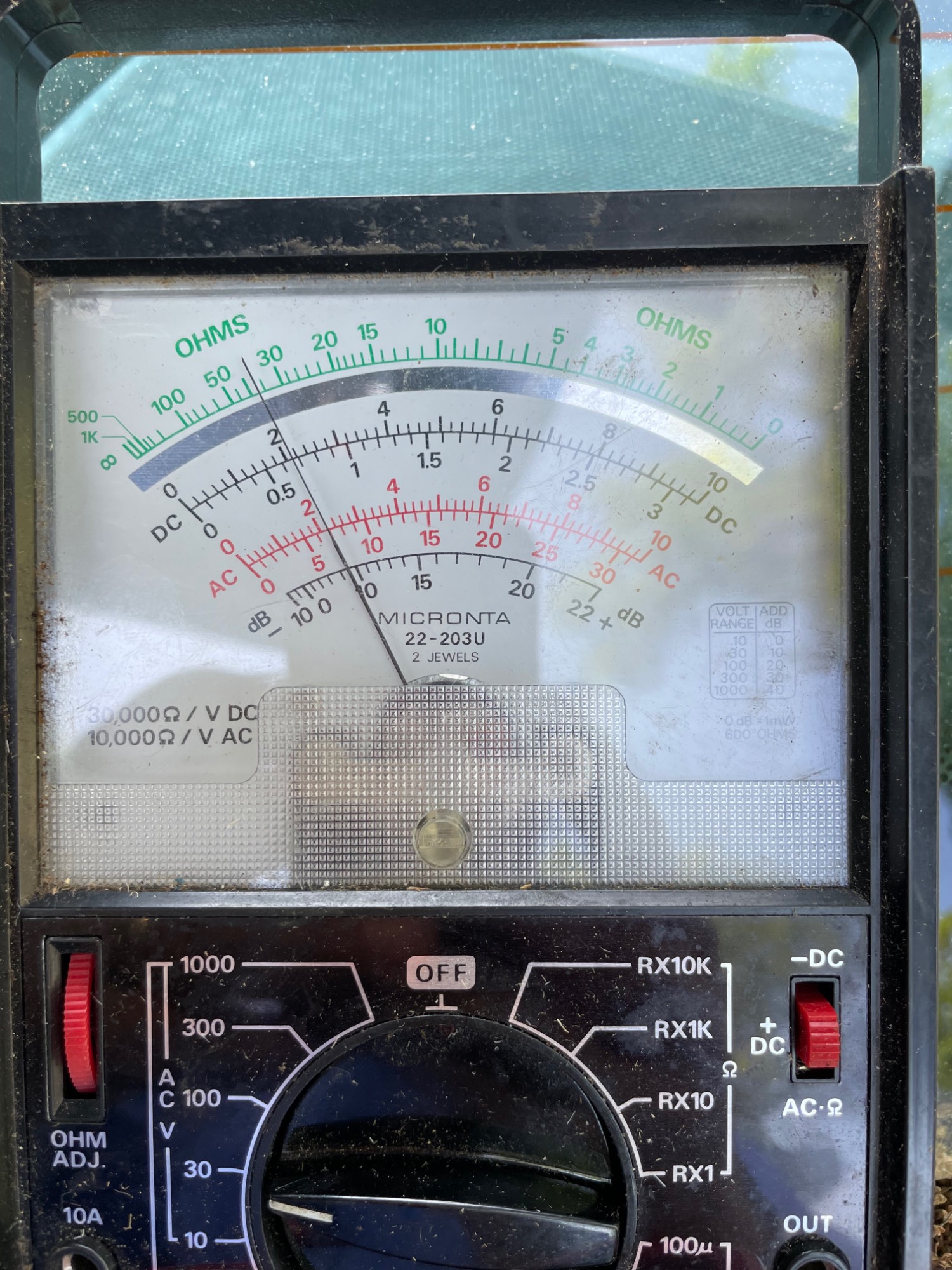

Can’t hear the fuel pump start on KPII, fuse in kidney ok , fuel pump relay 103 activates on KPII and will check for voltage at back connector
Phook. Brand new fuel pump dead after 5000 miles /6 months ?
Or
My bad wiring of fuel pump. Good news is I put slack in it to allow rewiring and testing without dropping tank

Next stop was inspection of wiring and the news was good there ……low voltage at pump side of connector and damage evident

That should not have burnt. I am wondering if a previous owner had an issue and fitted a larger fuse? It should be a 15A fuse in the kidney shaped main fuse box. I think it is is position #15.

Probably the old, failed pump from 2022 was pulling high current and old connections were oxidized, so the copper got dirty.
New splices and the Kat is purring again.
