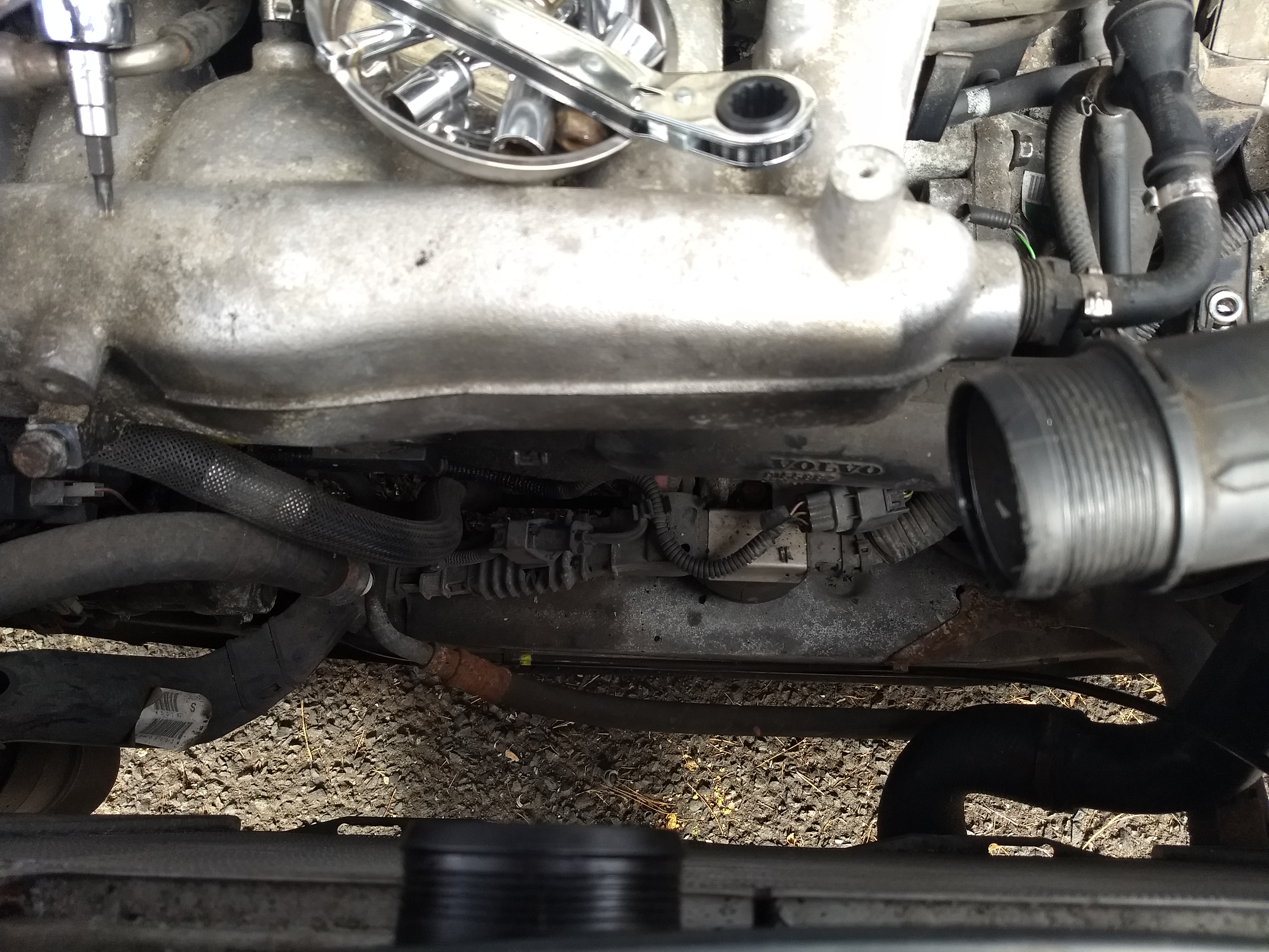

Bruno , we should be doing PCV anyway on that new to you...once the manifold is off, easy Peazy. Ive got a spare ETM gasket, too.brunocerous wrote: 20 Nov 2018, 15:18Thanks! I had been nudging it over but didn't want to crack or dislodge the intake pipe. Even loosening the clamp and rotating it out of the way would help, but I can't see where it attaches.bmdubya1198 wrote: 20 Nov 2018, 15:14 Usually I'm able to push the intake tube towards the manifold enough to slip the fan past. If you need to, you can remove the hose camp from where it attached to the ETM and slip that hose off, but the problem at that point is that it's much easier to do this when the fan is out of the way.
I can't stand the design of the '99+ intake.
The '99 intake is nuts!

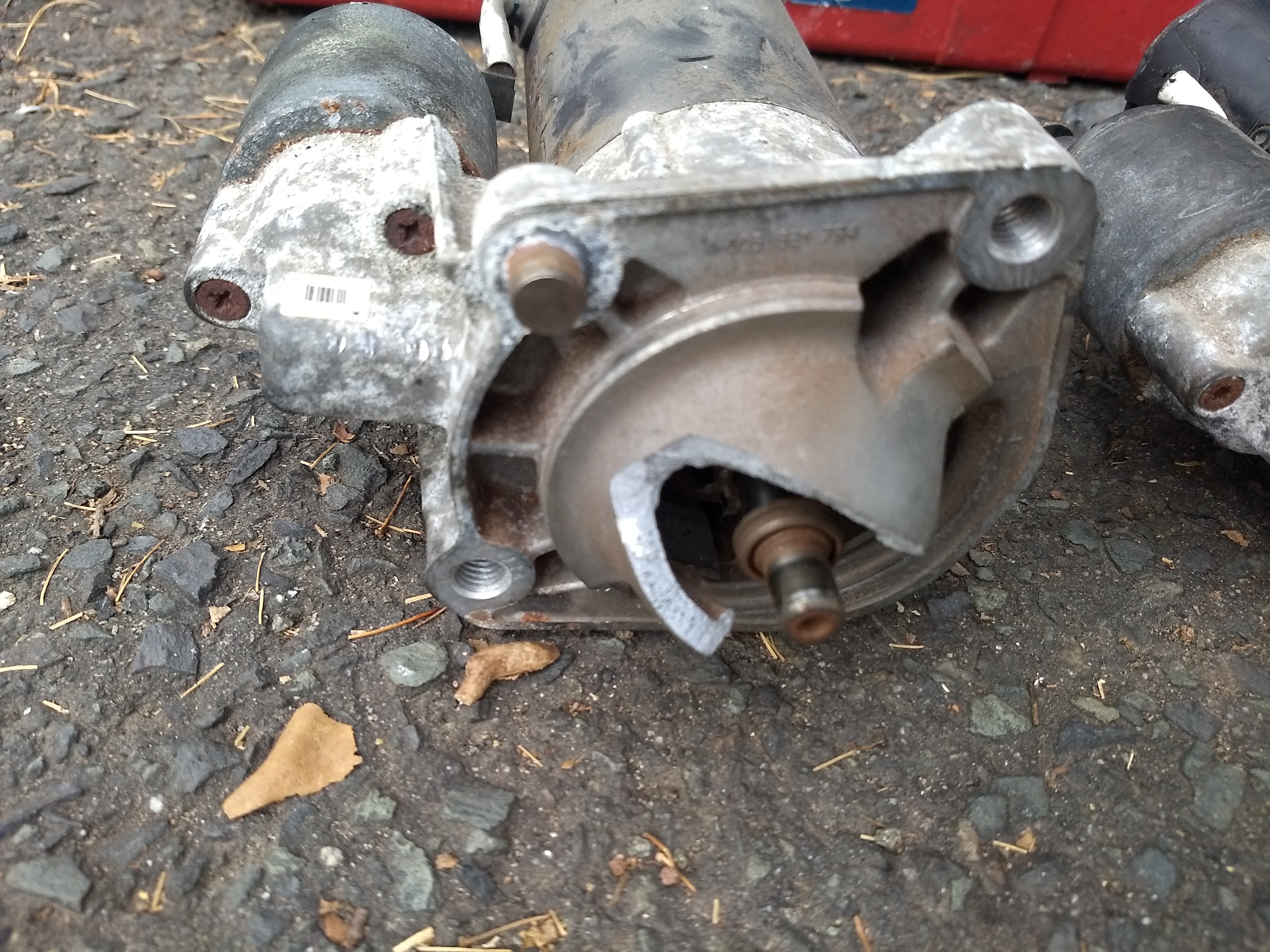

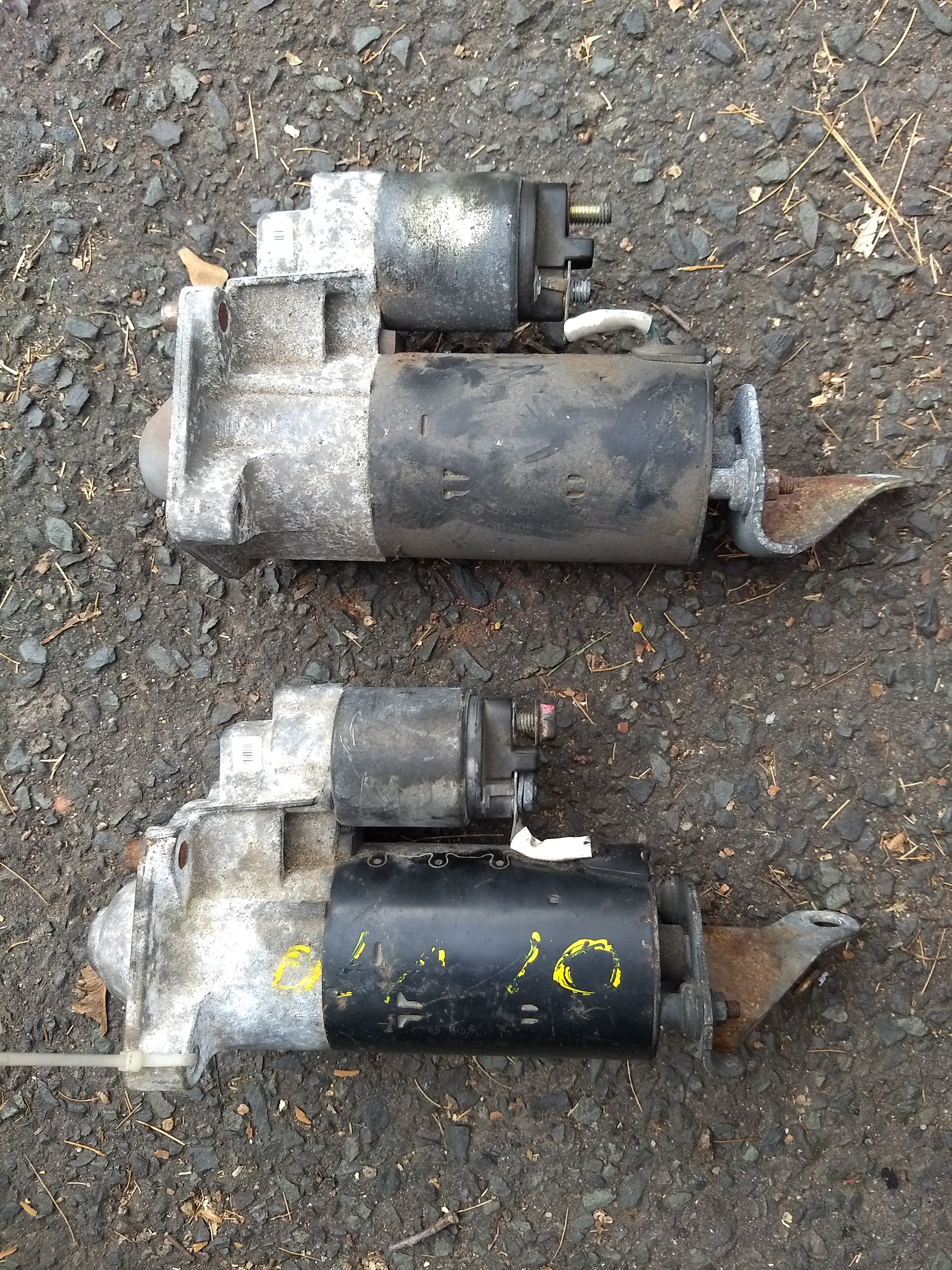

I managed to get to the starter in the '99 XC by removing the fan shroud first, then the fan assembly. Counterintuitive!
The starter came out after some coaxing with a dead blow hammer. I don't know if the metal bell-shaped piece was broken beforehand, but I managed to fish out the shard from the flywheel area.
The seller had intended to replace the starter before being dissuaded by the complexity and gave me the one he had bought from a junkyard. Who doesn't love a freebie?
Installation was a lot faster, but now nothing happens when I try to crank it. Hopefully, I'll have time to bring out the multitester before Thanksgiving dinner.
