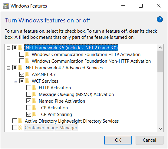

.NET Framework 3.5 installed?jkelley1083 wrote: 27 Jan 2019, 13:15 Yes and yes. All tests pass except Interface test. Says that “Self diagnostic connector is not attached”.

Yes. Same exact setup as yours.RickHaleParker wrote: 27 Jan 2019, 13:34.NET Framework 3.5 installed?jkelley1083 wrote: 27 Jan 2019, 13:15 Yes and yes. All tests pass except Interface test. Says that “Self diagnostic connector is not attached”.

jkelley: Rerun the install process over the current install. That has fixed this problem in the past.
