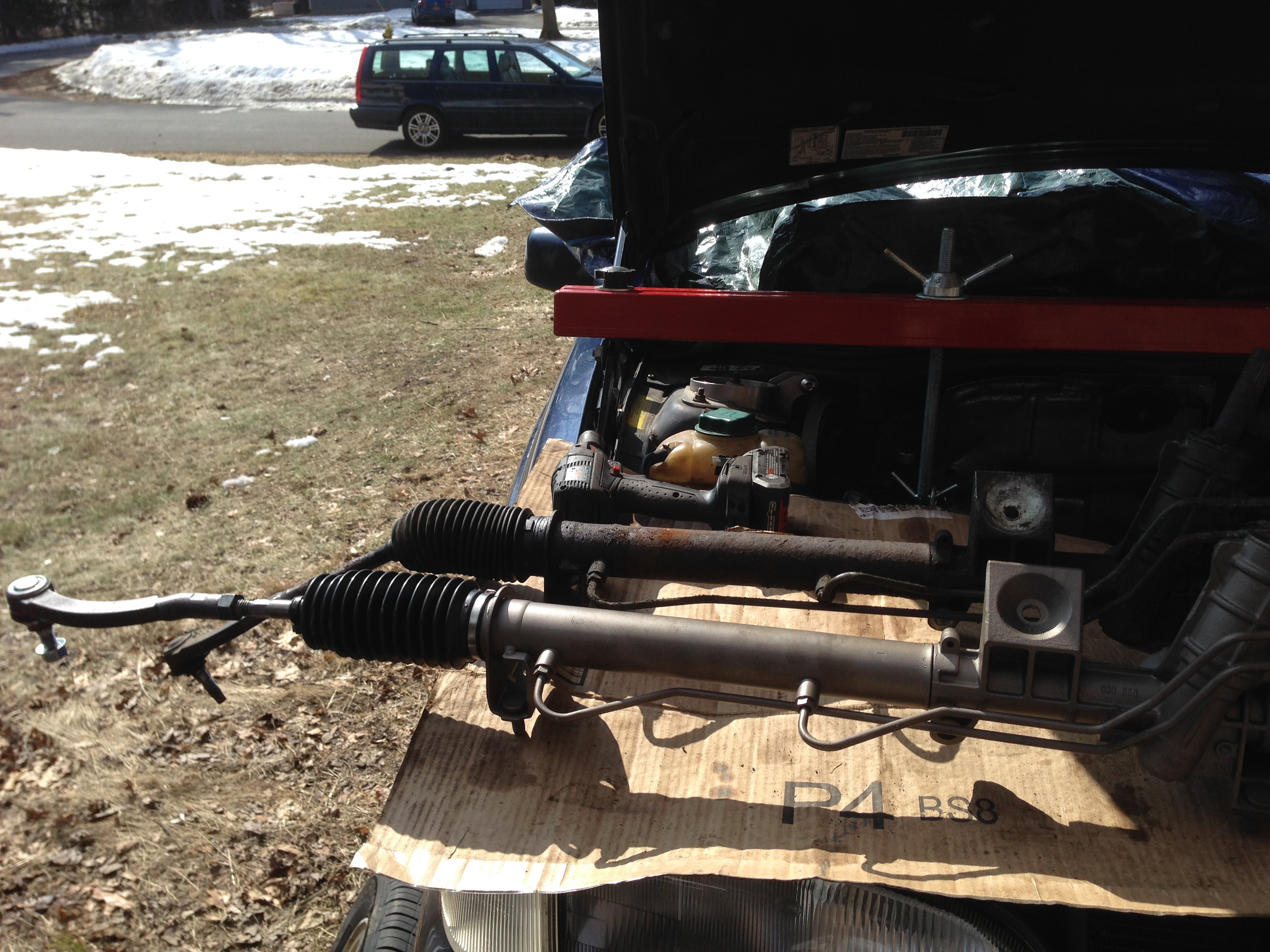

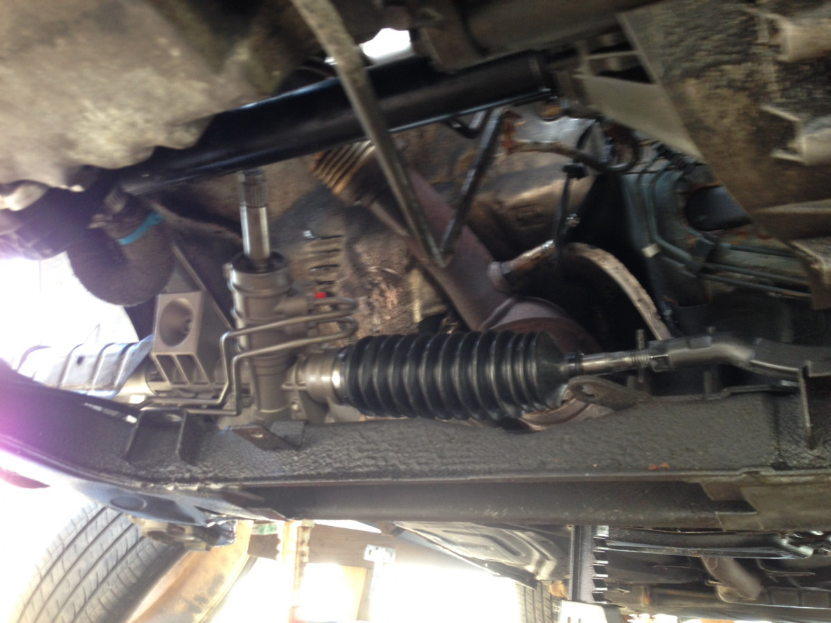

Planning on
Getting rack and subframe back in today
Install Hitch on Shaggkira
.... update at 1700 hours
All done!!

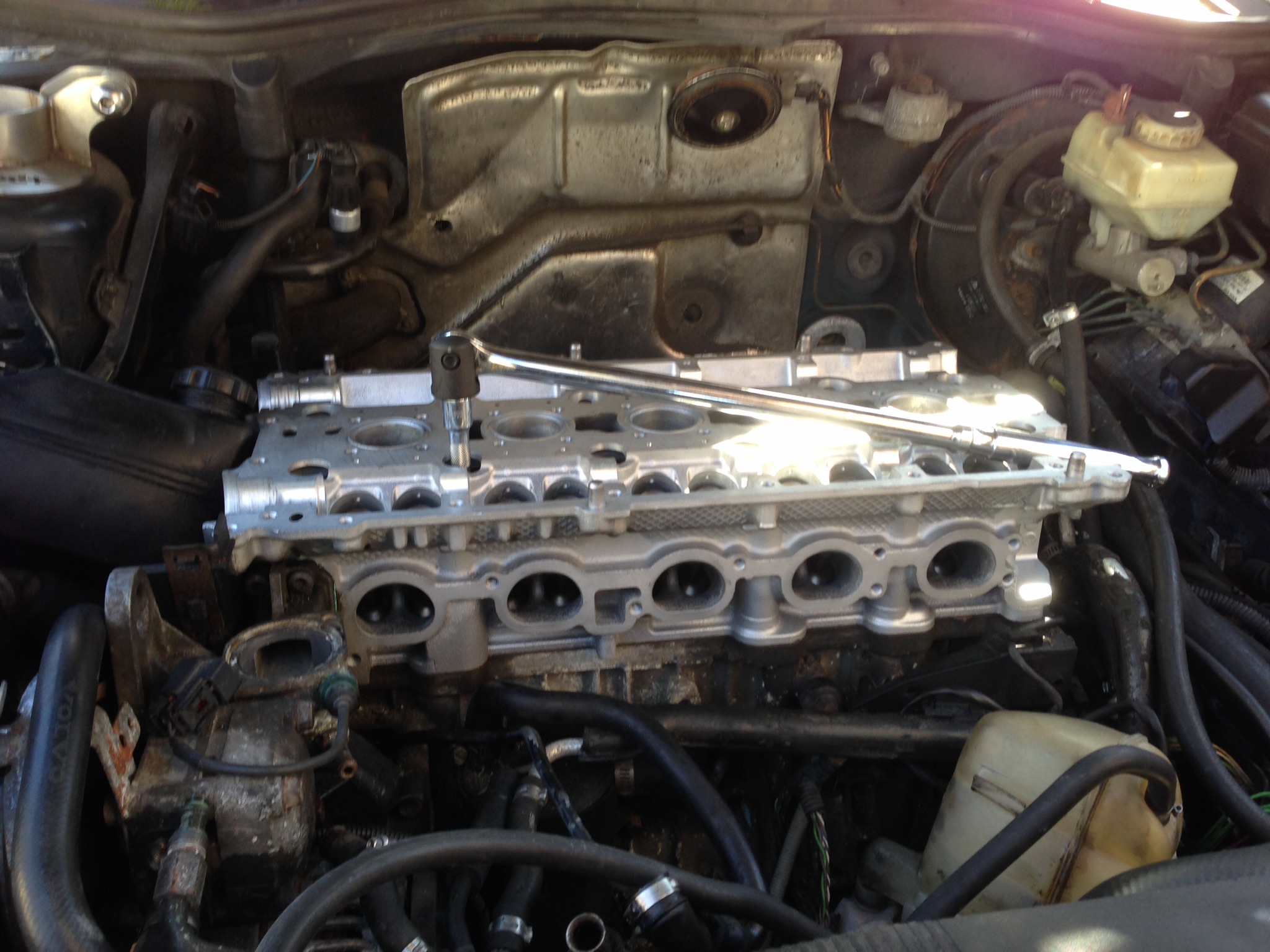

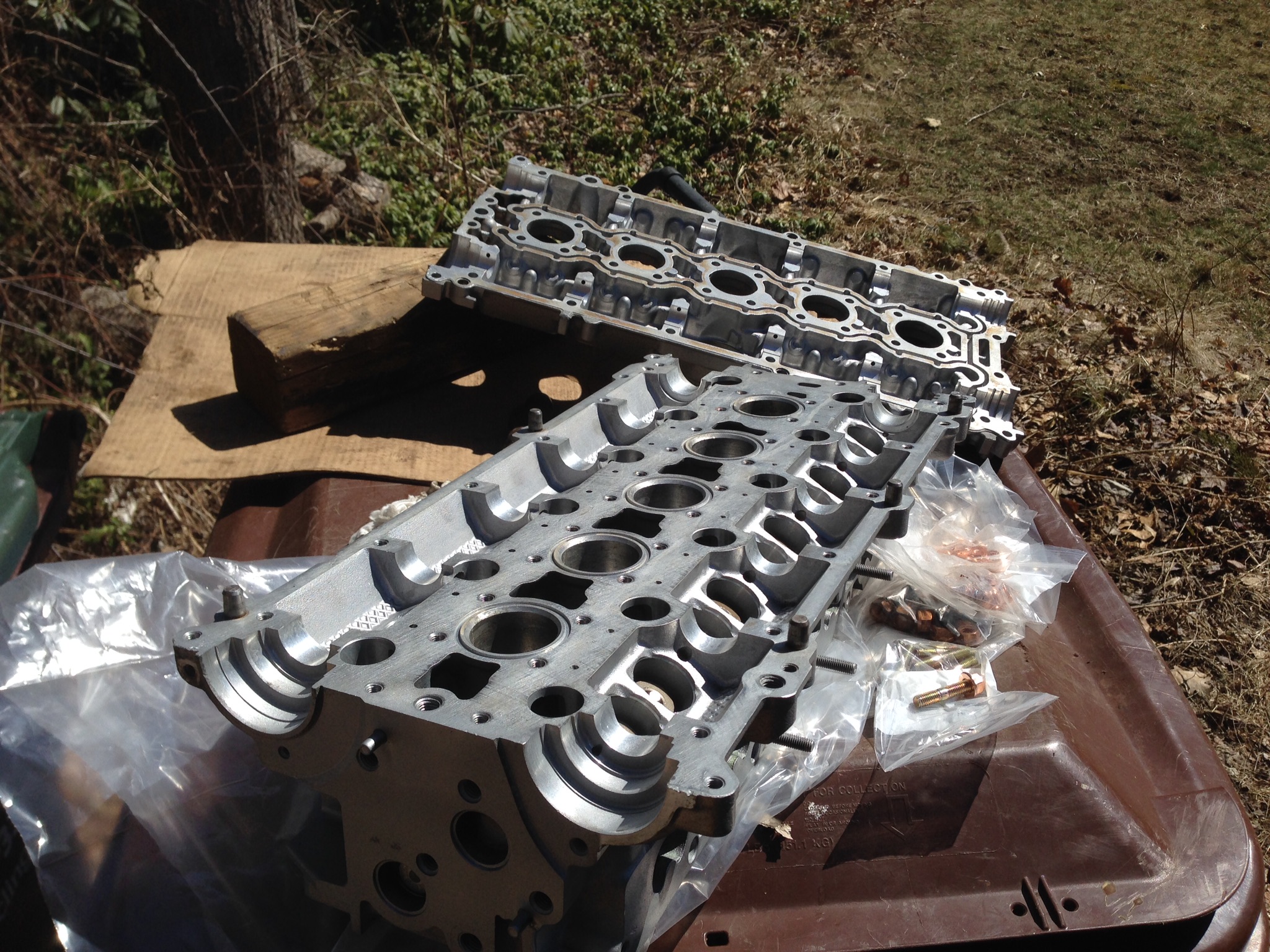

A good day yesterday......

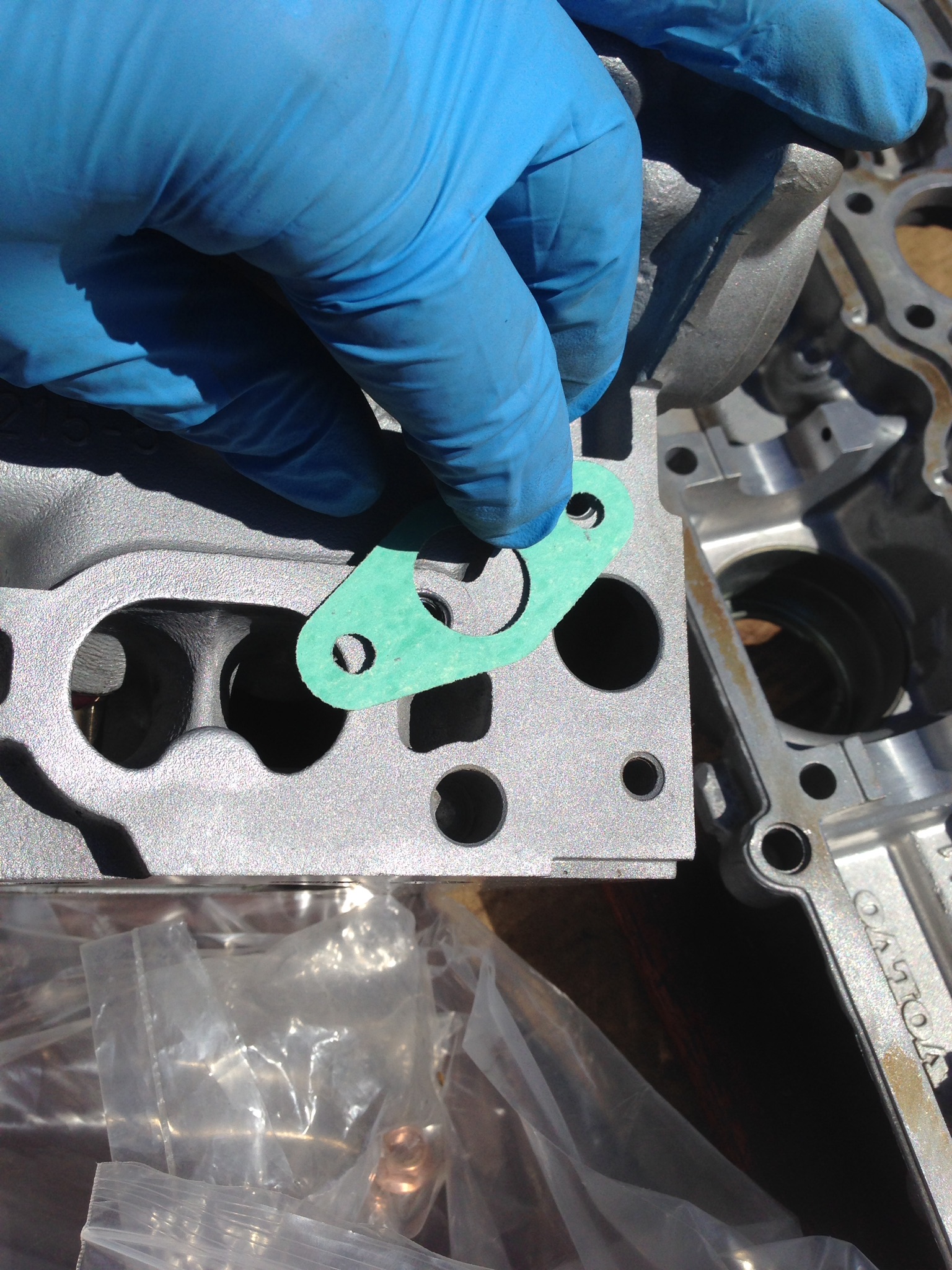

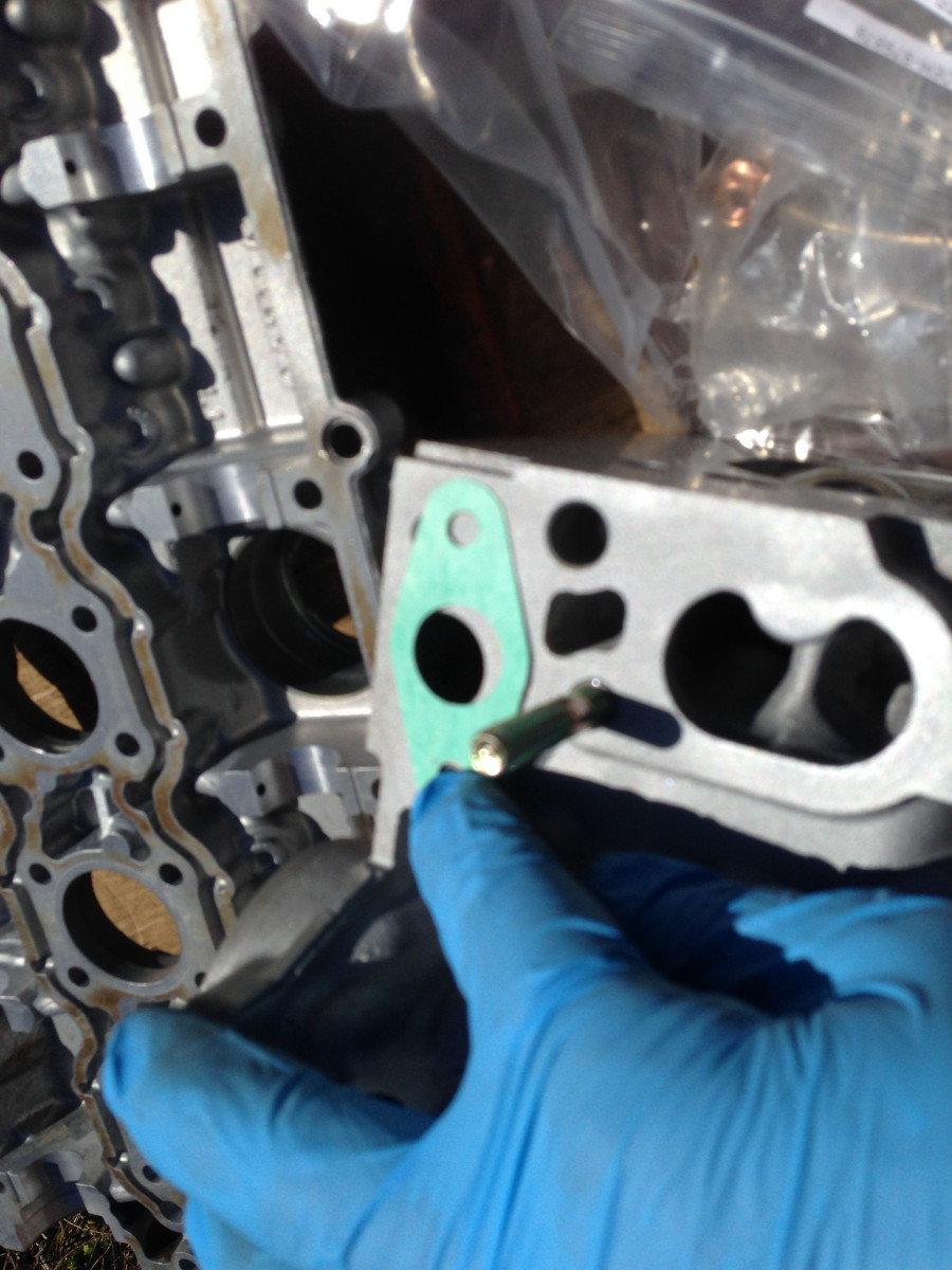

If you leave off the last exhaust stud you can easily swing in the water pipe gasket after the head goes on.

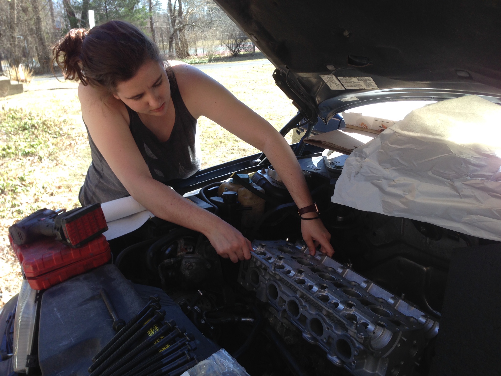

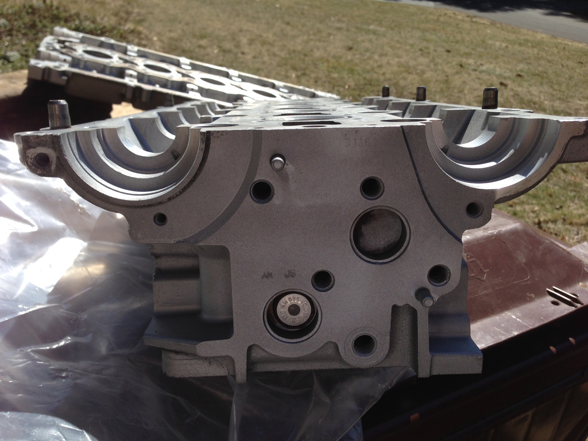

Head is on and torqued!

abscate wrote: 22 Mar 2021, 02:55 If you leave off the last exhaust stud you can easily swing in the water pipe gasket after the head goes on.
A light smudge of gasket sealer will hold a gasket in place until you get the bolts in. Kind of like having a third hand.

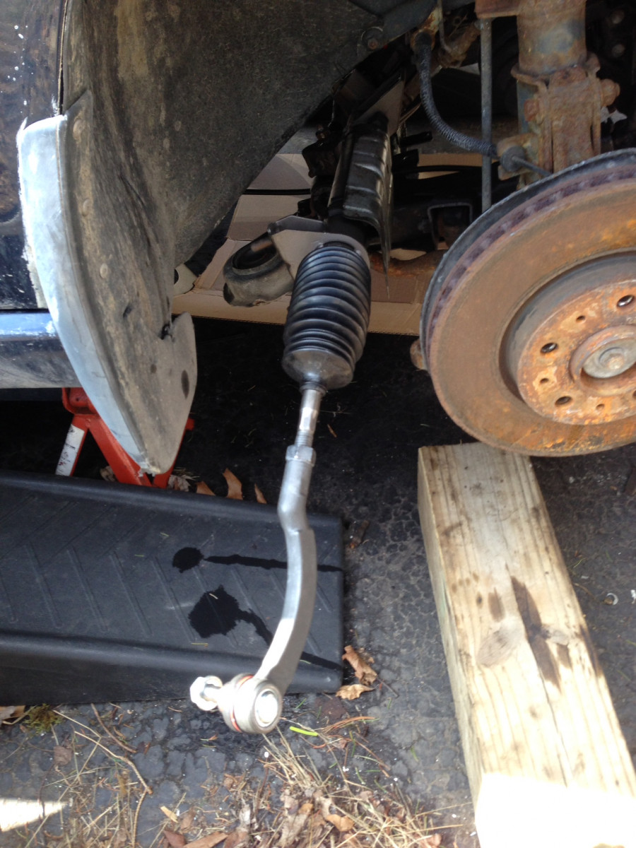

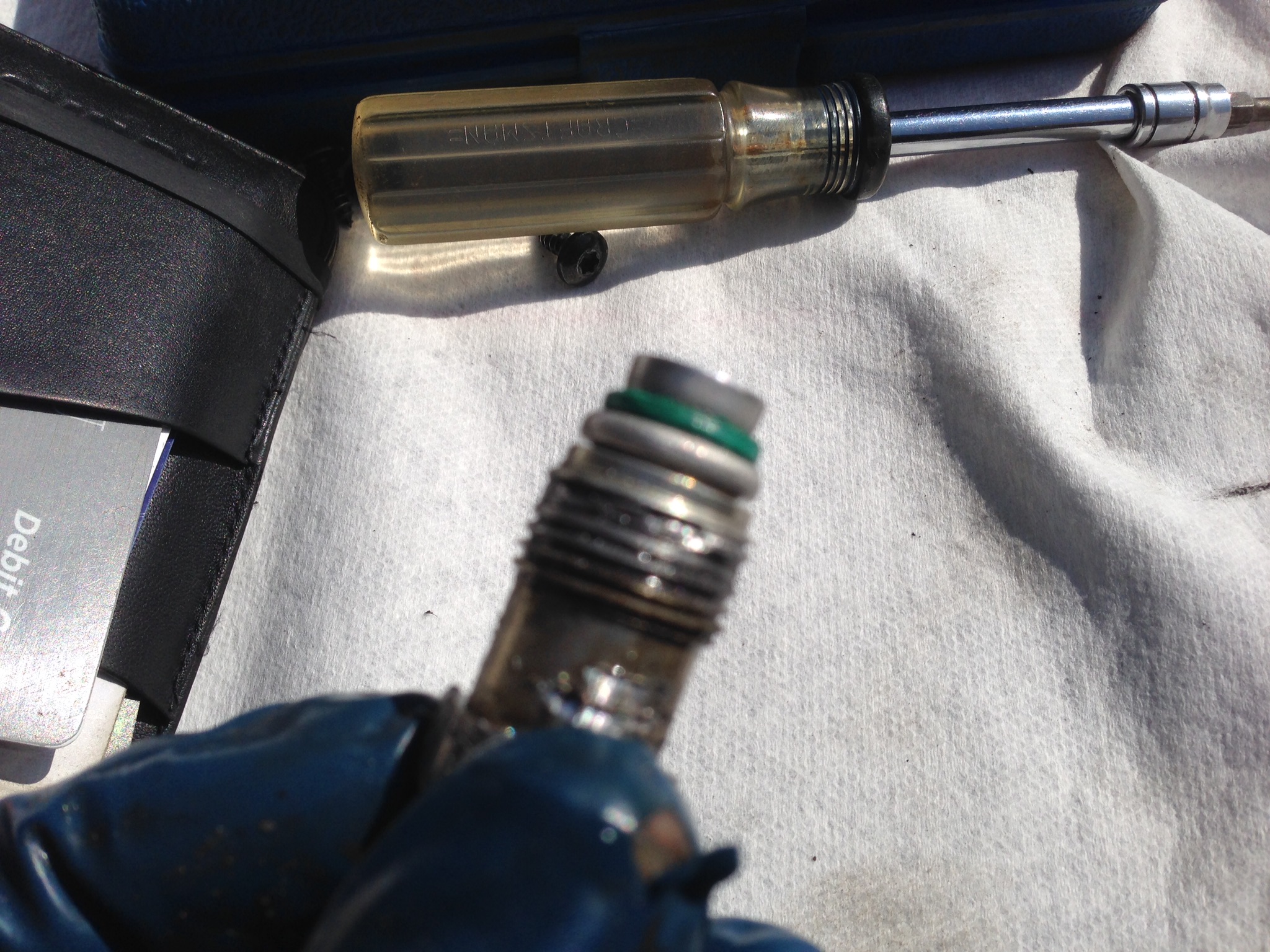

PRO TIP PRO TIP PRO Tip
Completely forgot to docment this.

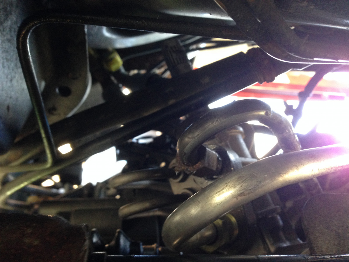

If you get stuck on the alloy union on the Power steering return hose....
Stop.
remove hose clamp on reservoir.
Snake the return line off with the rack
Deal with the union on the bench.

Post by bmdubya1198 »
Good call on that one. It's a lot easier to clamp the return line back onto the reservoir.

Bright, shiny parts going back on, looks like the weather is cooperating, and you have Help too !

Maybe I missed it, but did you go with new head bolts or the reuse one time route ?

New Rein head bolts. It’s hard to reuse them when I heard the noises of them coming out
