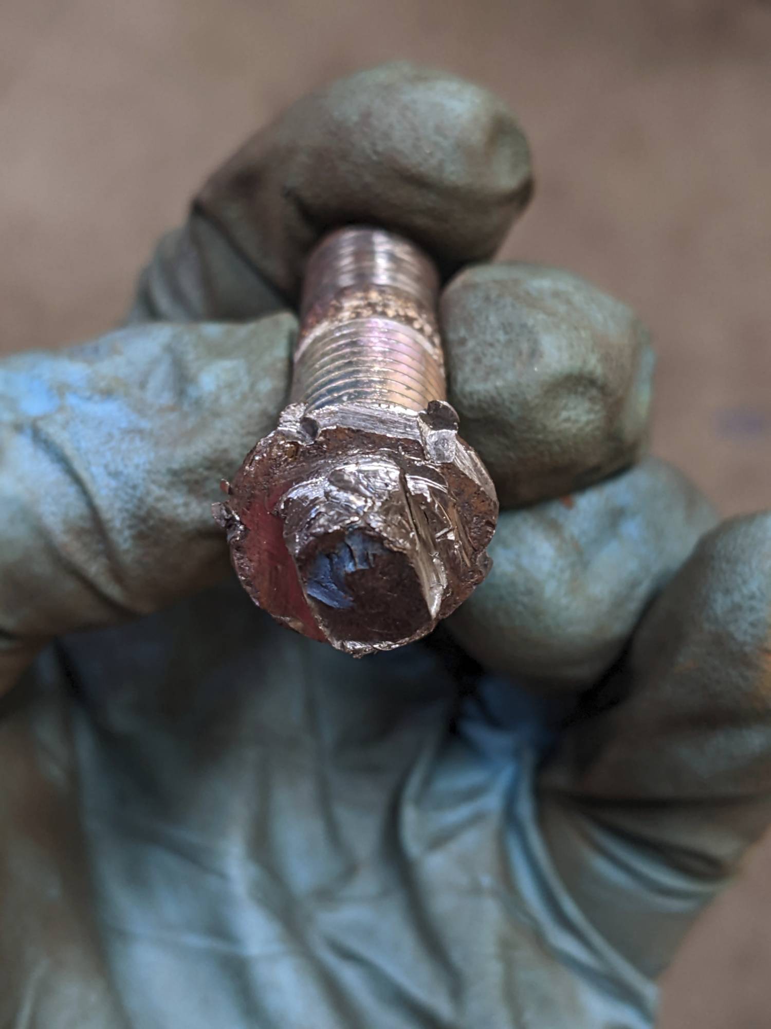

Here's another one. What part is this which was so rusted in place that it required extreme measures to remove?

Exciting to have a new entry in the ongoing contest…
I am guessing that it is the pinch bolt at the base of the control arm that attaches to the wheel hub.

A solution in record time. Good work. 50 more MVS points to jreed.
Specifically, it's the lower front of the four wheel hub bolts, perhaps taking the most road salt due to its position. That bolt was so rusted in place that even after hitting it with a blow torch for maybe five minutes and shaving the head to grip it with Vice Grips didn't help. Ultimately, I hammered my Irwin bolt extractor around its flange, cutting deep grooves into the bolt, enough to hold the extractor in place. Poor extractor must have gotten a little dull from the job but it gripped enough to break the bolt free. Perhaps I shouldn't blame the bolt head for rusting, but the middle of the shaft which looked quite corroded.
