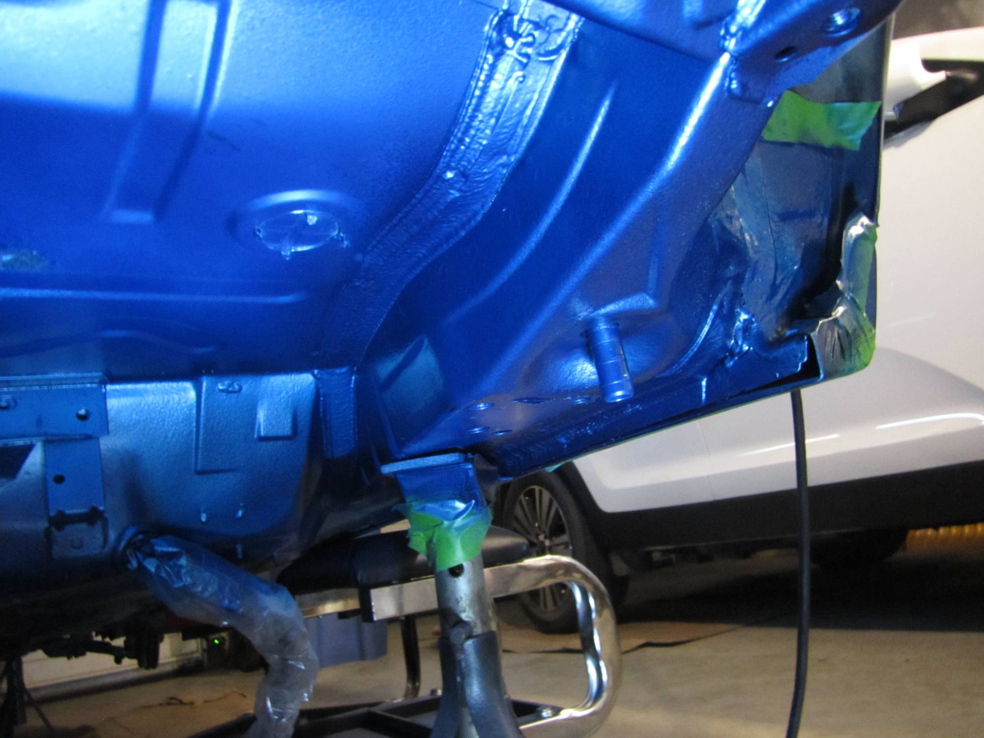

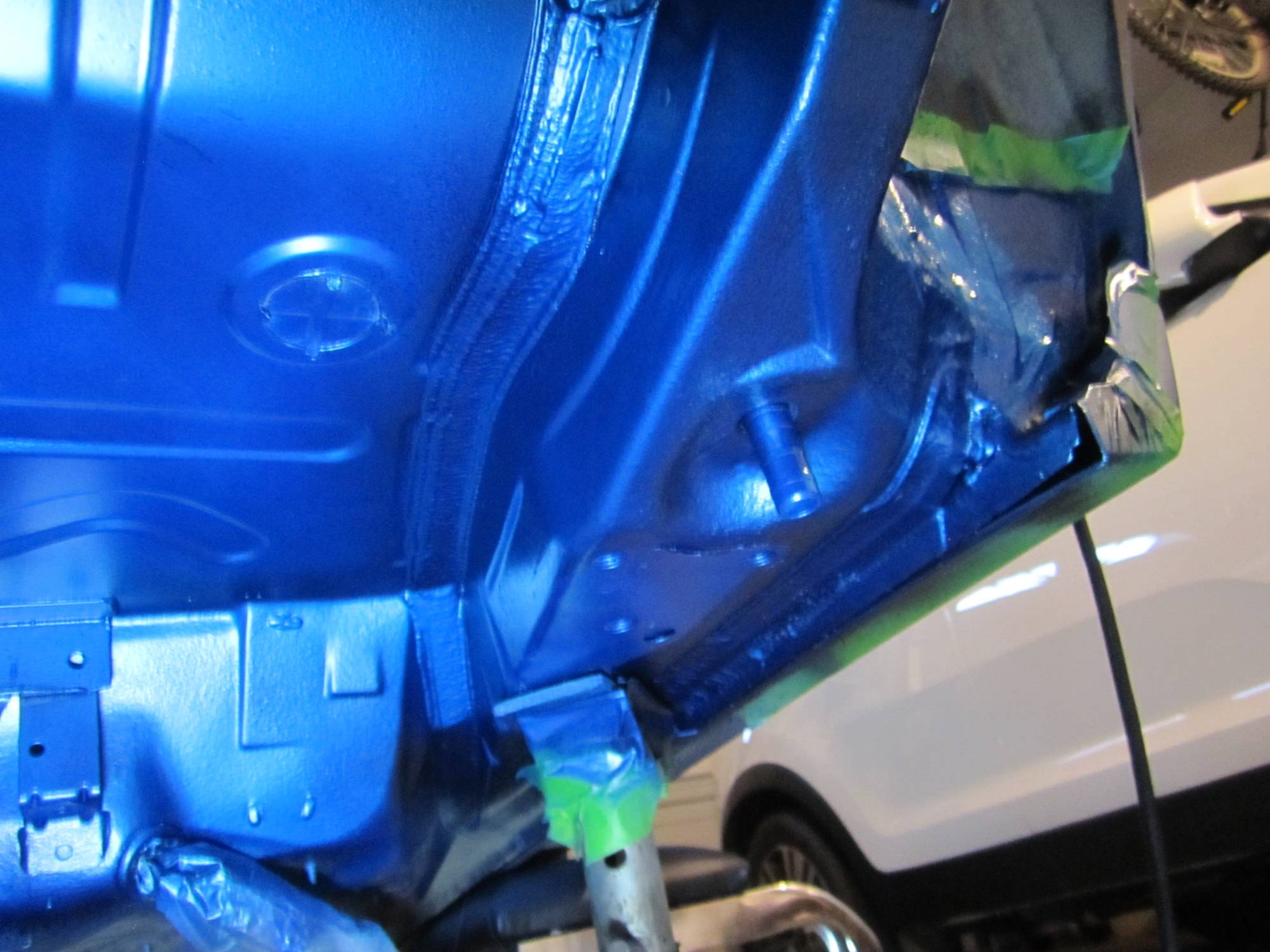

Post by scot850 »
Hopefully this will help for positioning:
Underside painting
Underside painting
Underside painting (2)
Hopefully the above pictures give a better idea. The 3 holes just this side of the axle stand are the rear trailing arm holes, and the hollow tube is where the bolt goes through the rear jacking point.
