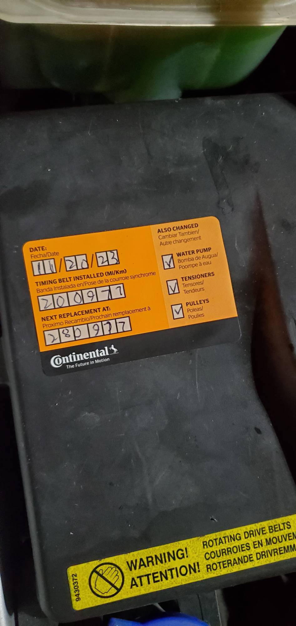

I somehow seemed to have gotten it timed correctly, since I had to take the cam pulleys off, I drew circles around the 3 bolts to mark their position, as well as a marker line from the pulley onto the cam snout. Accidentally moved the cams taking the bolts out, putting a screwdriver through the holes and bracing against the engine didn't hold it steady enough. I cut down a piece of 1/4 thick steel bar, which I fit into the slots on the rear side of the cams under the distributor and cam position sensor and used a pair of vice grips to carefully turn the cams until they lined up.
Spun the engine over by hand, then by starter, then started it up and it ran great, until it stalled out at idle after about 5 minutes of running. It started right back up and ran with no issues after that, so I have no idea what that was all about.
First time driving it started vibrating at 45mph, then it happened again, and then went away. I'm thinking this was just things settling out after having the car and engine jacked up for so long.
For now it's still being treated gently and being checked for leaks but it felt great to slap this sticker on.
