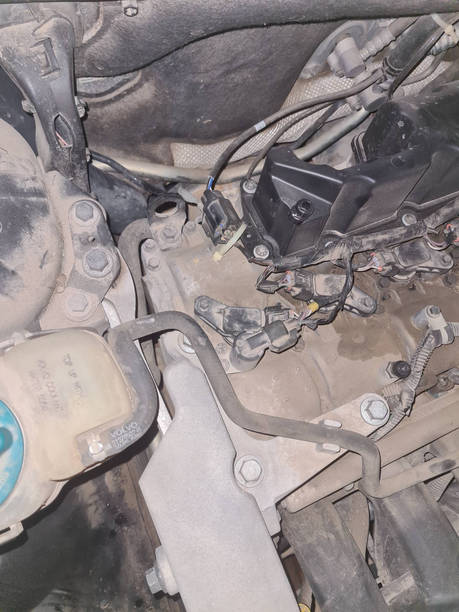

Now, take it slow before jumping into something else. You finally posted pictures. Evaluate, reassess, then verify.
The catalytic converters from the heat shield holes for the O2 sensors don’t look like they were changed. They appear dirty and there is some corrosion on one.
Re-read the things posted for you three times slowly. It was also mentioned about the serpentine, decoupler area, and downpipes. What if they replaced the downpipes/secondary catalytic converters? I was trying to help you on the other forum about getting to this. You should probably also post back to that forum since it has the history.
Take pictures closer to the decoupler area, closer to the serpentine, stick your phone under the drivers seat area and take pictures of the catalytic converters. Verify…..
Also, it looks like you are leaking oil from the PCV seal and leaking from the PCV diaphragm cap. These are issues. Maybe leaking oil from a sensor o-ring which isn’t an issue, just needs to be changed when you can.
If you are smelling something in the oil, then it’s an issue. Even if it’s smelling burnt at low miles/kilometers, you could be running both lean and rich.
Also, I see your engine is very dirty. Double check the air filter as that should be changed more often.
There’s so much more…..
