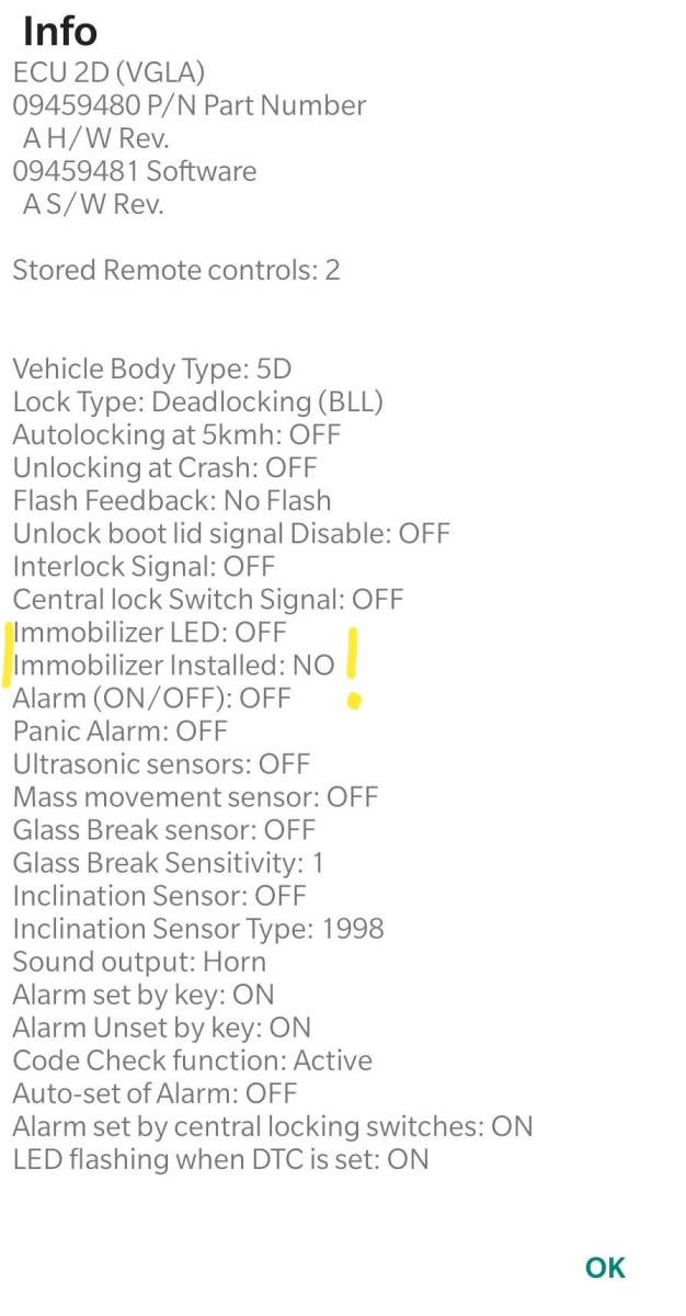

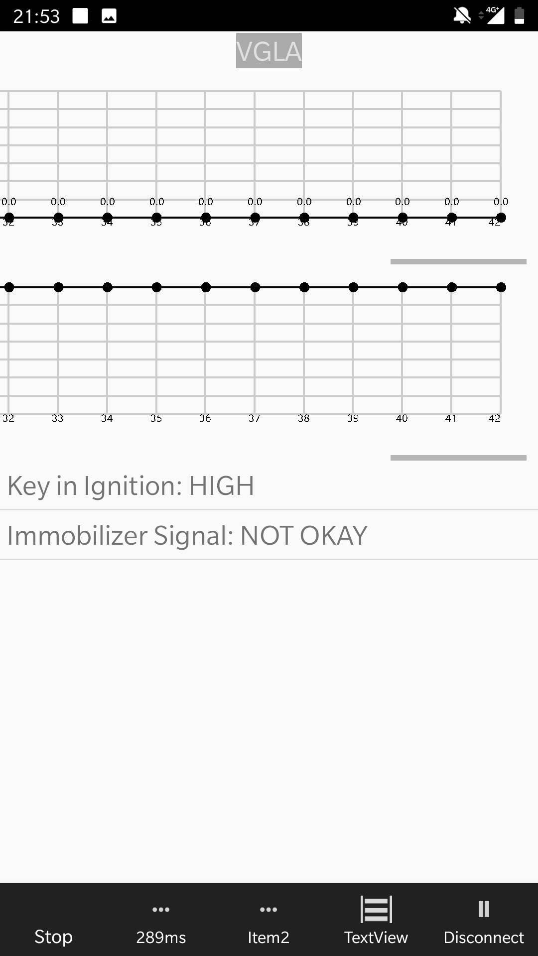

Other things I saw:
VGLA live shows central locking non effective
Immo signal NOK while key is detected in ignition lock
What a powerful tool this is <3

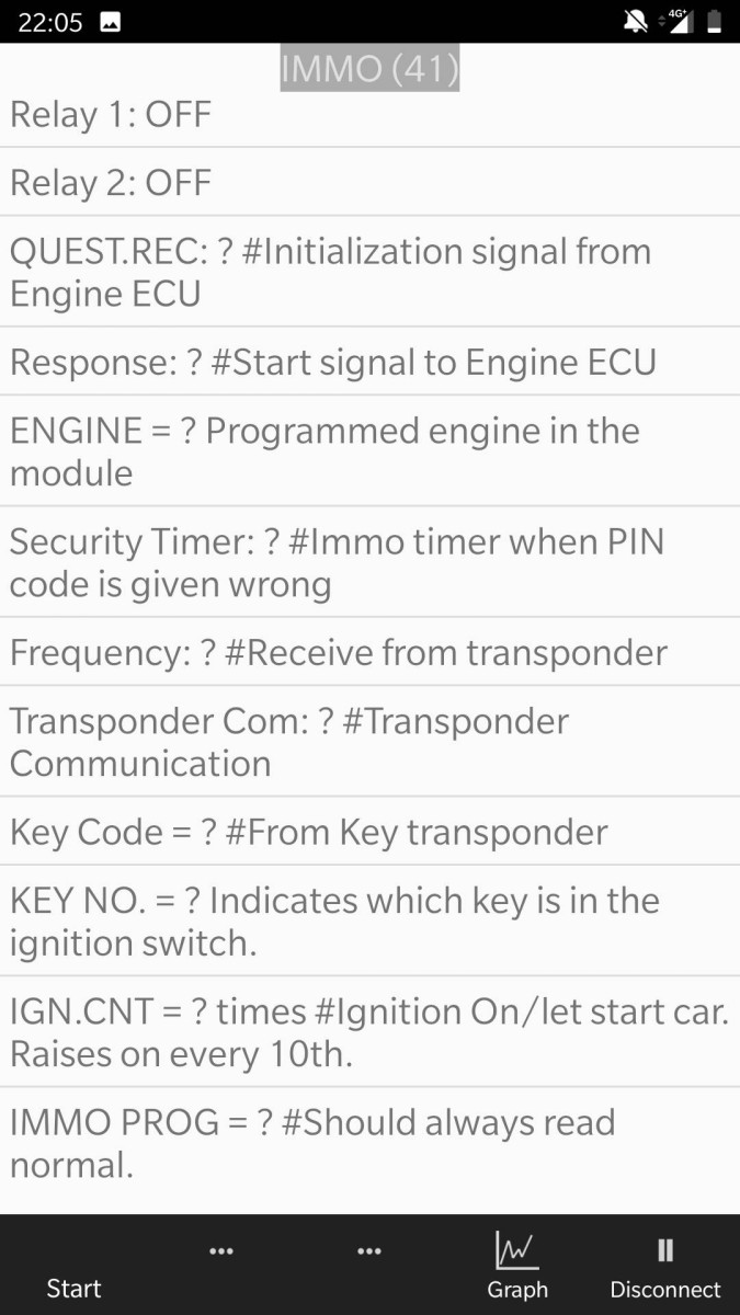

10V Engine IMMO3 does not have VIN programmed at all in Engine nor IMMO. I have one of these from 99 year model.
In Scan log i didnt see IMMO Scan. You can send that to my email if feels better.
Good point you noticed from that IMMO Not Okay signal as you checked did VGLA even have IMMO bit set which it didn't. My 10V IMMO3 memory from Fenix 5.2 ECM doesn't have linkage code between IMMO3 and VGLA neither so maybe it is thats why and its normal show then that in Live Data.
