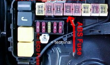

But I'm wondering if I've got it connected to the bypass terminal in the fusebox. There is a white plastic fuse holder (different than all the rest) with a small blade terminal in it, and I figured that that was the right one to hook up my wife to.

Yes, it's a white plastic fixture with a blade terminal sticking up out of it - see photo
and the small blade terminal on the solenoid. Don't forget to also turn the key. Just to check if the solenoid is working at all, you could connect a wire straight from the battery + post to the blade terminal- this should make the solenoid kick in as soon as the wire touches the terminal.
If it doesn't crank with this connected, the problem might be in the key switch or even the ground connections that MIJ mentioned. I have also heard some people say they got their solenoid working by hitting it with a hammer.
