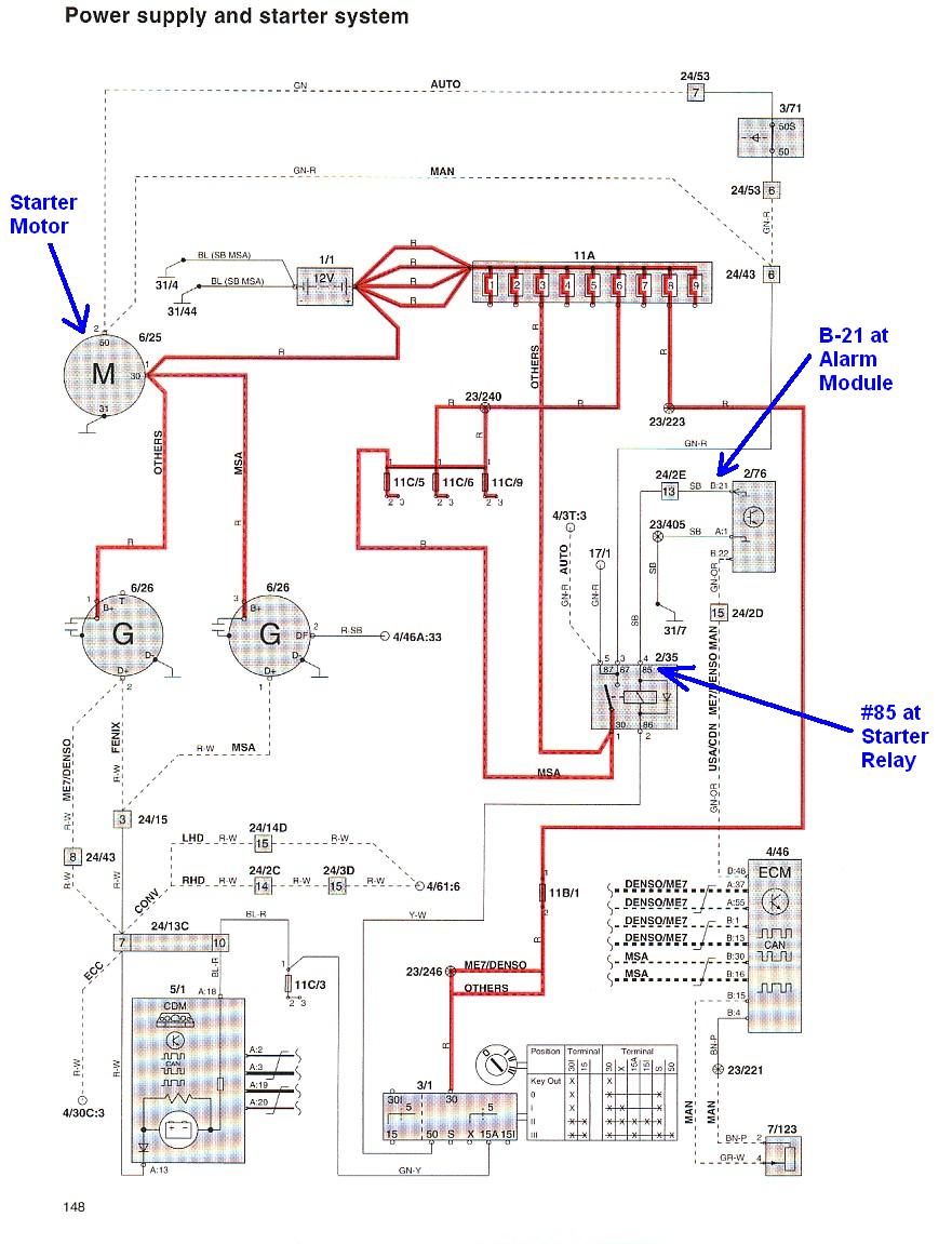

Hello,jimmy57 wrote:98-2000 s70/v70/xc70 and 98-2004 c70 use Denso made alarm using a control module that is to left and up under dash, almost behind headlight switch.
Pin B21 of alarm module grounds starter relay 2/35. Relay 2/35 contact closing coil is powered by ignition switch starter terminal.
If the alarm module doesn't provide the ground to start relay then the relay doesn't provide feed to starter solenoid and no cranking results.
Usually locking the car and then unlocking it should reset the alarm. The alarm module is also the door lock, fuel cap unlock, trunk lid latch, and interior light module.
Fuses 2, 13, and 18 are all feeds to the alarm/lock/light module. Those are the fuses in the box just in front of windshield on driver's side cowl.

Spliced a wire into this B21 wire, grounded it, and was able to start the car with the alarm going off. Thank Jimmy, you are the hero of the day.jimmy57 wrote:Pin B21 of alarm module grounds starter relay 2/35. Relay 2/35 contact closing coil is powered by ignition switch starter terminal.
The alarm continued to go off for 5 minutes. Then all was silent until a door was opened, then it all started again.
Not sure yet what the problem is. My guess is that the drivers door latch is bad. Tomorrow I'm going to get a use door latch and an alarm control unit. The car is a '98. I'm guessing that the programming is for the key fob. I'll find out soon and post back.

Based on the year you mentioned getting a used "alarm control unit" is not a good idea if the car is a X70 series. Behaviour of the alarm system is correct btw, be happy that it doesn't the second siren installed to annoy you even more.rspi wrote: [...]Tomorrow I'm going to get a use door latch and an alarm control unit. The car is a '98. I'm guessing that the programming is for the key fob. I'll find out soon and post back.
- Posts: 8360
- Joined: 31 Mar 2010, 09:54
- Location: Omaha NE
- Been thanked: 504 times
Old post but worthwhile info.rspi wrote:...Spliced a wire into this B21 wire, grounded it, and was able to start the car with the alarm going off. Thank Jimmy, you are the hero of the day.
The alarm continued to go off for 5 minutes. Then all was silent until a door was opened, then it all started again...
@rspi: no need to splice B-21, all you have to do is to run a ground jumper wire from an adjacent relay socket's ground pin to feed Starter Relay with ground. This basically bypasses the Alarm Module.
@jimmy57: for those who don't care about the alarm system, can they simply remove the fuse feeding the alarm system to "shut its mouth", and of course do the jumper wire as mentioned above. This way the car functions like cars that came from the factory with no alarm?
