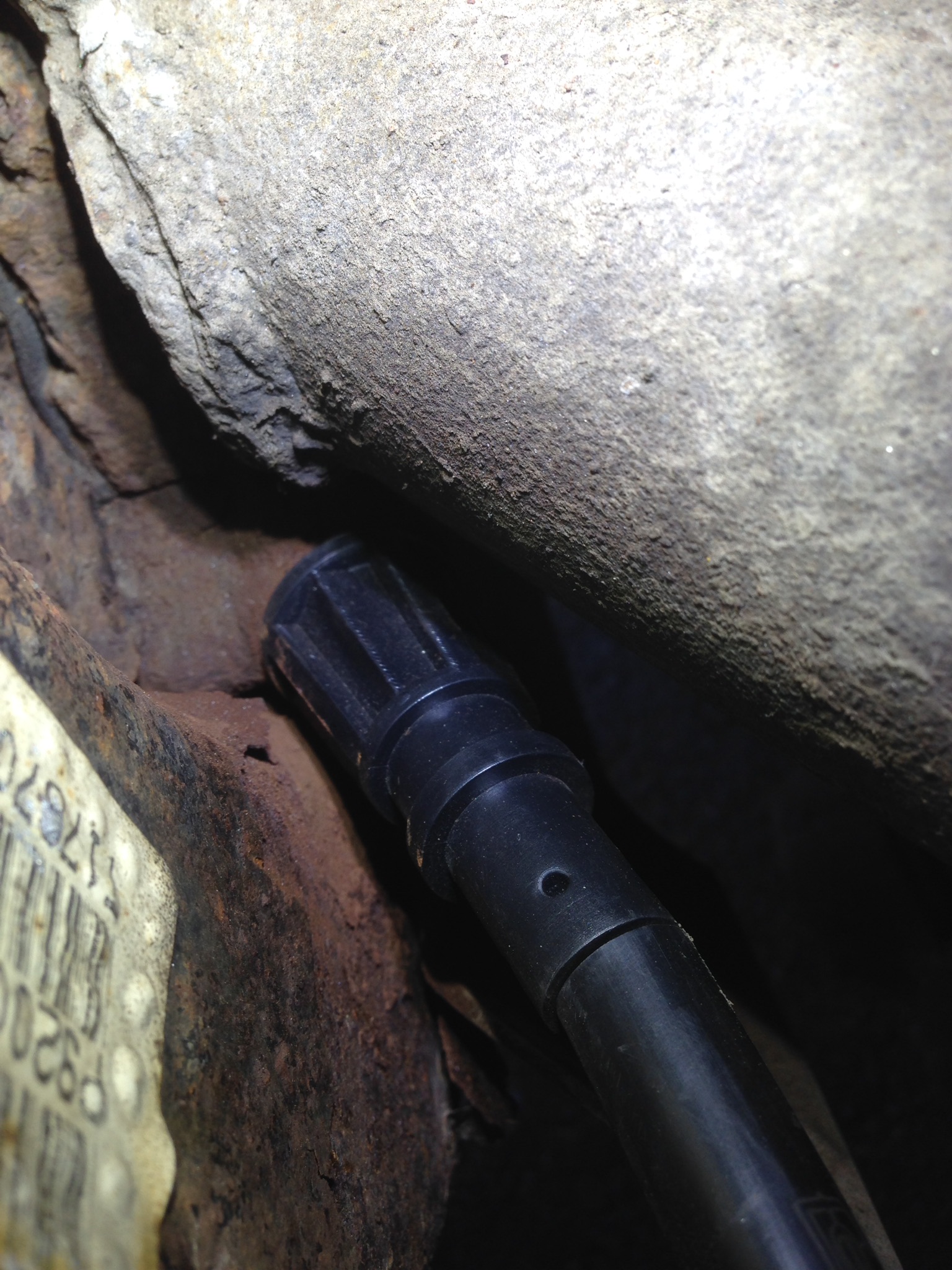

Work in progress. Upthread, some reported they got a poor fit on the Febi into the brake plate hole. No seal there is bad as it will let water in and seize the new cable.scot850 wrote: 13 Jan 2021, 19:38 What cable mods do you have to do on the Febi parking brake cables?
- wizechatmgr
- Posts: 1800
- Joined: 12 Jan 2017, 13:07
- Location: Albany, NY area
- Has thanked: 45 times
- Been thanked: 128 times
From what I can tell, you'd think it was engineered to be water tight, but it isn't. It's really weird. The spot between the plastic bayonet and the rest of the cable has no attempts to make it water tight, yet the bayonete to e-brake actuator at the wheel has an o-ring. My guess is this is to avoid dust, not water. Weird stuff.abscate wrote: 14 Jan 2021, 04:33Work in progress. Upthread, some reported they got a poor fit on the Febi into the brake plate hole. No seal there is bad as it will let water in and seize the new cable.scot850 wrote: 13 Jan 2021, 19:38 What cable mods do you have to do on the Febi parking brake cables?

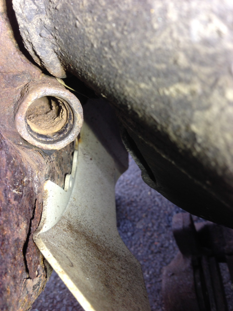

The FEbi cable sold in 2021 (FCP) matches the OEM cable with an 18 mm snout and 21 mm baseabscate wrote: 13 Jan 2021, 18:06 Bump on this one. Using FEBI and will document cable mods needed
FEBI $20 per cable
Volvo. Now $80 per cable
I had heavy corrosion in the brake plate hole and had to grind it out with a Dremel and stone. This leaves the oring compression fit loose so I’ll secure it with RTV AND ZIPTIES
